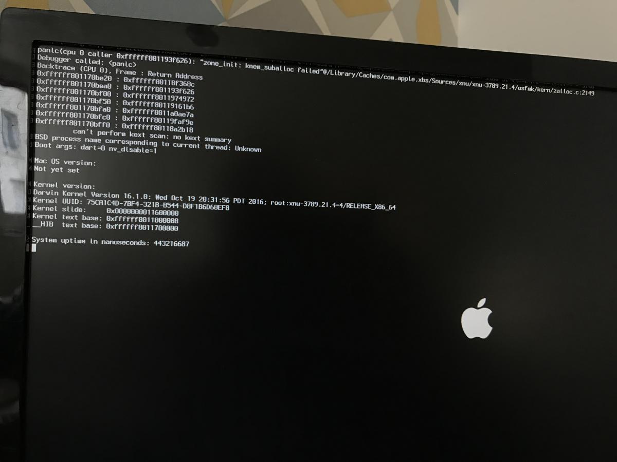

franc0is Posted January 20, 2017 Share Posted January 20, 2017 Hi, I have a problem when I want to install os Sierra from a usb drive. I have made an usb bootable with Mac OS Sierra. When I boot from the usb drive I have the logo od apple and after that this error screen. I have search a little bit and I think it's a problem of ram.I have :-Asus rog G20CB with an intel core i5-6400 2.70GHZ-8GB of ram in one slot of card-Nvidia GeForce GTX 950Can you help me ? Sorry for my English because I'm French Link to comment https://www.insanelymac.com/forum/topic/320349-install-mac-os-sierra-on-a-asus-rog-g20cb/ Share on other sites More sharing options...
nawcom Posted January 20, 2017 Share Posted January 20, 2017 It's most likely a memory config issue. Enter in info about your memory module in the SMBIOS section of your config.plist as seen here via a plist editor or you can also configure this from Clover Configurator. If you want to try getting around this issue without specifying your memory info in Clover, you can try switching the slot you have your 8GB memory module in to a more appropriate slot number to see if Clover is happy with that but there's no guarantees that that'll fix the issue. Link to comment https://www.insanelymac.com/forum/topic/320349-install-mac-os-sierra-on-a-asus-rog-g20cb/#findComment-2353494 Share on other sites More sharing options...
