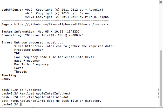

MaLd0n Posted January 24, 2017 Share Posted January 24, 2017 i think script dont support ur processor, use nullcpupm at moment and wait solution NullCPUPowerManagement.kext.zip or try it config.plist.zip after reboot, send me ioreg again, if dont generate, use nullcpupm Link to comment https://www.insanelymac.com/forum/topic/320130-asus-z10pe-d8-ws-dsdt-disassemble-and-recompile/page/2/#findComment-2356299 Share on other sites More sharing options...
fluxus123 Posted January 25, 2017 Author Share Posted January 25, 2017 I DID IT! ran the ssdtPRGen manually with the following command: ~/ssdtPRGen.sh -cpus 2 -l 48 -target 2 -t 105 -x 1 -d 3 -p E5-2658 -m MacPro6,1 -f 2000 -turbo 2700 -bclk 100 -b Mac-F60DEB81FF30ACF6 The output of that is the following ssdtPRGen.sh v0.9 Copyright © 2011-2012 by † RevoGirl v6.6 Copyright © 2013 by † Jeroen v21.4 Copyright © 2013-2017 by Pike R. Alpha ----------------------------------------------------------- Bugs > https://github.com/Piker-Alpha/ssdtPRGen.sh/issues < System information: Mac OS X 10.12 (16A323) Brandstring: "Genuine Intel® CPU @ 2.00GHz" Override value: (-cpus) number of processors, now using: 2! Override value: (-l) number of logical processors, now using: 48! Override value: (-target) CPU, now using: Haswell! Override value: (-t) maximum TDP, now using: 105 Watt! Override value: (-x) XCPM mode, now set to: 1! Override value: (-d) debug mode, now using: 3! Override value: (-p) processor model, now using: E5-2658! Override value: (-m) model, now using: MacPro6,1! Override value: (-f) clock frequency, now using: 2000 MHz! Override value: (-turbo) maximum (turbo) frequency, now using: 2700 MHz! Override value: (-bclk) frequency, now using: 100 MHz! Override value: (-B ) board-id, now using: Mac-F60DEB81FF30ACF6! Setting executing bit of extractACPITables ... _checkForExecutableFile(extractACPITables) Done. Extracting ACPI tables ... Done. matchingFilename: /Users/philippvonfrankenberg/Library/ssdtPRGen/ACPI/SSDT-1.aml matchingFilename: /Users/philippvonfrankenberg/Library/ssdtPRGen/ACPI/SSDT-2.aml matchingFilename: /Users/philippvonfrankenberg/Library/ssdtPRGen/ACPI/SSDT-3.aml matchingFilename: /Users/philippvonfrankenberg/Library/ssdtPRGen/ACPI/SSDT-4.aml matchingFilename: /Users/philippvonfrankenberg/Library/ssdtPRGen/ACPI/SSDT-5.aml matchingFilename: /Users/philippvonfrankenberg/Library/ssdtPRGen/ACPI/SSDT-6.aml Checking User Defined processor data ... Checking Sandy Bridge processor data ... Processor data found for the Intel E5-2658 Version: models.cfg v150 / Sandy Bridge.cfg v150 _getACPIProcessorScope: /tmp/SSDT-1.dat _getACPIProcessorScope: /tmp/SSDT-2.dat _getACPIProcessorScope: /tmp/SSDT-3.dat _getACPIProcessorScope: /tmp/SSDT-4.dat _getACPIProcessorScope: /tmp/SSDT-5.dat _getACPIProcessorScope: /tmp/SSDT-6.dat 4 Name (_HID, "ACPI0004") object(s) found in DSDT matchingData: 5b828c000253434b30085f4849440d414350493030303400 5b828e000253434b31085f4849440d414350493030303400 5b828f0c0253434b32085f4849440d414350493030303400 5b828f0c0253434b33085f4849440d414350493030303400 Searching for ACPI Processor declarations in Device(SCK0) {} Three-byte encoding detected (maximum length 0x0FFFFF/1048575) pkgLengthByte: 0x8c/140 packageLength: 0x0200c/8204 scopeLength: 8204 Device (SCK0): processorID: 00 CP00 processorID: 02 CP01 processorID: 04 CP02 processorID: 06 CP03 processorID: 08 CP04 processorID: 0a CP05 processorID: 10 CP06 processorID: 12 CP07 processorID: 14 CP08 processorID: 16 CP09 processorID: 18 CP0A processorID: 1a CP0B processorID: 01 CP0C processorID: 03 CP0D processorID: 05 CP0E processorID: 07 CP0F processorID: 09 CP10 processorID: 0b CP11 processorID: 11 CP12 processorID: 13 CP13 processorID: 15 CP14 processorID: 17 CP15 processorID: 19 CP16 processorID: 1b CP17 gScope : 1 gProcessorStartIndex: 24 gLogicalCPUs : 48 gProcessorNames : 24 Searching for 0 additional Processor declaration ... Searching for ACPI Processor declarations in Device(SCK1) {} Three-byte encoding detected (maximum length 0x0FFFFF/1048575) pkgLengthByte: 0x8e/142 packageLength: 0x0200e/8206 scopeLength: 8206 Device (SCK1): processorID: 20 CP00 processorID: 22 CP01 processorID: 24 CP02 processorID: 26 CP03 processorID: 28 CP04 processorID: 2a CP05 processorID: 30 CP06 processorID: 32 CP07 processorID: 34 CP08 processorID: 36 CP09 processorID: 38 CP0A processorID: 3a CP0B processorID: 21 CP0C processorID: 23 CP0D processorID: 25 CP0E processorID: 27 CP0F processorID: 29 CP10 processorID: 2b CP11 processorID: 31 CP12 processorID: 33 CP13 processorID: 35 CP14 processorID: 37 CP15 processorID: 39 CP16 processorID: 3b CP17 Number of Scopes: 2 Generating ssdt.dsl for a 'MacPro6,1' with board-id [Mac-F60DEB81FF30ACF6] Haswell Core E5-2658 processor [0x306F1] setup [0x0507] With a maximum TDP of '105' Watt, as specified by argument: -t 105 Number logical CPU's: 48 (Core Frequency: 2000 MHz) Number of Turbo States: 7 (2100-2700 MHz) Number of P-States: 16 (1200-2700 MHz) Warning: You must use the -xcpm_ipi flag instead of -xcpm on multiprocessor systems. targetCStates: 13 Adding C1 Adding C3 Adding C6 targetCStates: 13 Adding C1 Adding C3 Adding C6 targetCStates: 13 Adding C1 Adding C3 Adding C6 targetCStates: 13 Adding C1 Adding C3 Adding C6 Injected C-States for CP00 (C1,C3,C6) Injected C-States for CP01 (C1,C3,C6) Warning..: FrequencyVectors missing in Mac-F60DEB81FF30ACF6.plist Download https://github.com/Piker-Alpha/freqVectorsEdit.shto fix this Warning: 'system-type' may be set improperly (1 instead of 3) - Clover users should read https://clover-wiki.zetam.org/Configuration/ACPI#acpi_smartups Compiling: ssdt_pr.dsl Intel ACPI Component Architecture ASL+ Optimizing Compiler version 20160422-64(RM) Copyright © 2000 - 2016 Intel Corporation ASL Input: /Users/philippvonfrankenberg/Library/ssdtPRGen/ssdt.dsl - 952 lines, 27848 bytes, 317 keywords AML Output: /Users/philippvonfrankenberg/Library/ssdtPRGen/ssdt.aml - 7958 bytes, 150 named objects, 167 executable opcodes Compilation complete. 0 Errors, 0 Warnings, 0 Remarks, 0 Optimizations Do you want to open ssdt.dsl (y/n)? n The generated SSDT gives me a KP about P-limits so I started trying to address the Warnings WARNING #1 You must use the -xcpm_ipi flag instead of -xcpm on multiprocessor systems. ->when I try use the -xcpm_ipi flag instead it tell me that it's an unknown flag?? so just ignored this one WARNING #2 FrequencyVectors missing in Mac-F60DEB81FF30ACF6.plist Download https://github.com/Piker-Alpha/freqVectorsEdit.shto fix this -> downloaded freqVectorsEdit.sh, ran it, but when it's checking for MacPro6,1 board-id resource file, it's not listed because the plist didn't contain the frequency vector at all. see below bash-3.2# ~/freqVectorsEdit.sh freqVectorsEdit.sh v2.3 Copyright © 2013-2017 by Pike R. Alpha. ----------------------------------------------------------------- Bugs > https://github.com/Piker-Alpha/freqVectorsEdit.sh/issues < Available resource files (plists) with FrequencyVectors: [ 1 ] Mac-031B6874CF7F642A.plist (iMac14,1) [ 2 ] Mac-06F11F11946D27C5.plist () [ 3 ] Mac-06F11FD93F0323C5.plist () [ 4 ] Mac-189A3D4F975D5FFC.plist (MacBookPro11,1) [ 5 ] Mac-27ADBB7B4CEE8E61.plist (iMac14,2) [ 6 ] Mac-2BD1B31983FE1663.plist (MacBookPro11,3) [ 7 ] Mac-35C1E88140C3E6CF.plist (MacBookAir6,1) [ 8 ] Mac-35C5E08120C7EEAF.plist (Macmini7,1) [ 9 ] Mac-3CBD00234E554E41.plist (MacBookPro11,2) [ 10 ] Mac-42FD25EABCABB274.plist (iMac15,1) [ 11 ] Mac-50619A408DB004DA.plist () [ 12 ] Mac-65CE76090165799A.plist () [ 13 ] Mac-77EB7D7DAF985301.plist (iMac14,3) [ 14 ] Mac-7DF21CB3ED6977E5.plist (MacBookAir6,2) [ 15 ] Mac-81E3E92DD6088272.plist () [ 16 ] Mac-937CB26E2E02BB01.plist () [ 17 ] Mac-9AE82516C7C6B903.plist () [ 18 ] Mac-9F18E312C5C2BF0B.plist () [ 19 ] Mac-A369DDC4E67F1C45.plist () [ 20 ] Mac-B809C3757DA9BB8D.plist () [ 21 ] Mac-BE0E8AC46FE800CC.plist () [ 22 ] Mac-DB15BD556843C820.plist () [ 23 ] Mac-E43C1C25D4880AD6.plist () [ 24 ] Mac-F305150B0C7DEEEF.plist () [ 25 ] Mac-FA842E06C61E91C5.plist (iMac15,1) [ 26 ] Mac-FFE5EF870D7BA81A.plist () Please choose the desired plist for your hardware (Exit/1-26) ? Solution was to manually add <key>InitialPLimit</key> <integer>0</integer> <key>FrequencyVectors</key> <array> <data></data> and then reload the shell bash-3.2# /Users/philippvonfrankenberg/freqVectorsEdit.sh freqVectorsEdit.sh v2.3 Copyright © 2013-2017 by Pike R. Alpha. ----------------------------------------------------------------- Bugs > https://github.com/Piker-Alpha/freqVectorsEdit.sh/issues < Available resource files (plists) with FrequencyVectors: [ 1 ] Mac-031B6874CF7F642A.plist (iMac14,1) [ 2 ] Mac-06F11F11946D27C5.plist () [ 3 ] Mac-06F11FD93F0323C5.plist () [ 4 ] Mac-189A3D4F975D5FFC.plist (MacBookPro11,1) [ 5 ] Mac-27ADBB7B4CEE8E61.plist (iMac14,2) [ 6 ] Mac-2BD1B31983FE1663.plist (MacBookPro11,3) [ 7 ] Mac-35C1E88140C3E6CF.plist (MacBookAir6,1) [ 8 ] Mac-35C5E08120C7EEAF.plist (Macmini7,1) [ 9 ] Mac-3CBD00234E554E41.plist (MacBookPro11,2) [ 10 ] Mac-42FD25EABCABB274.plist (iMac15,1) [ 11 ] Mac-50619A408DB004DA.plist () [ 12 ] Mac-65CE76090165799A.plist () [ 13 ] Mac-77EB7D7DAF985301.plist (iMac14,3) [ 14 ] Mac-7DF21CB3ED6977E5.plist (MacBookAir6,2) [ 15 ] Mac-81E3E92DD6088272.plist () [ 16 ] Mac-937CB26E2E02BB01.plist () [ 17 ] Mac-9AE82516C7C6B903.plist () [ 18 ] Mac-9F18E312C5C2BF0B.plist () [ 19 ] Mac-A369DDC4E67F1C45.plist () [ 20 ] Mac-B809C3757DA9BB8D.plist () [ 21 ] Mac-BE0E8AC46FE800CC.plist () [ 22 ] Mac-DB15BD556843C820.plist () [ 23 ] Mac-E43C1C25D4880AD6.plist () [ 24 ] Mac-F305150B0C7DEEEF.plist () [ 25 ] Mac-F60DEB81FF30ACF6.plist (MacPro6,1) [ 26 ] Mac-FA842E06C61E91C5.plist (iMac15,1) [ 27 ] Mac-FFE5EF870D7BA81A.plist () Please choose the desired plist for your hardware (Exit/1-27) ? TADA it's listing it now. upon proceeding with 25 it ends up NOT adding any data to frequency vectors but instead removing the StepContextDict dictionary. WARNING #3 'system-type' may be set improperly (1 instead of 3) - Clover users should read https://clover-wiki.zetam.org/Configuration/ACPI#acpi_smartups -> it mentions ACPI_SmartUPS, so I enabled that. Then ran ssdtPRGen again with the same flags, only had the xclm warning, which I couldn't do anything about. After restart I don't get a KP anymore and I can see X86.... hooking on to all the logical processors and low and behold I now have 112 1 0xffffff7f82ba1000 0x17000 0x17000 com.apple.driver.X86PlatformPlugin (1.0.0) 314B16BB-0DF9-3FF0-9416-961E762C882A <82 74 39 37 11 7 6 5 4 3 1> 119 1 0xffffff7f82bd6000 0x7000 0x7000 com.apple.driver.X86PlatformShim (1.0.0) 49CF8C0A-C2D1-356C-8127-805E4B2433D1 <112 82 74 7 4 3> So I guess it's all working now. Will test sleep and hibernate properly in a bit. Thanks a lot for all your help MALDON!! 1 Link to comment https://www.insanelymac.com/forum/topic/320130-asus-z10pe-d8-ws-dsdt-disassemble-and-recompile/page/2/#findComment-2356637 Share on other sites More sharing options...

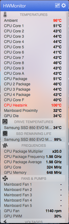

fluxus123 Posted January 27, 2017 Author Share Posted January 27, 2017 Ok, so it's not all going as well as I hoped... 1. Still doesn't wake from hibernation. 2. HWMonitor still only showing 20X multiplier, showing super high temps for ambient and CPU heatsink (these cannot be right at all, they're around 45-50C) and fans are still running at full blast 3. geekbench score dropped from 2200/17500 (no PM) to 1300/14000 with current power management ssdt Is there a way to bring up P-states and Turbo states in Termianal, as currently used by the system? 1 Link to comment https://www.insanelymac.com/forum/topic/320130-asus-z10pe-d8-ws-dsdt-disassemble-and-recompile/page/2/#findComment-2358059 Share on other sites More sharing options...
