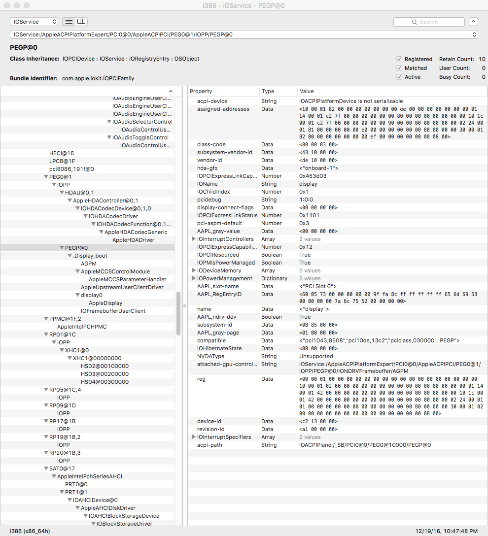

dimmorpheus Posted December 19, 2016 Share Posted December 19, 2016 hello. i've never had problems with video card asus strix gtx 970. it didn't work with native drivers (rebooting after loading native kext). but everything was fine with nvidia webdriver (smbios -> "macpro6,2"; nvda_drv=1 in clover's config, "Config#" -> "none" in file /System/Library/Extensions/AppleGraphicsControl.kext/Contents/PlugIns/AppleGraphicsDevicePolicy.kext/Contents/Info.plist). i've upgraded my bios to version 20 (the same preferences). nor native, nor web drivers are loaded. (after upgrading in freebsd and windows works fine) i've been trying to use "clover inject", clover "EmuVariableUefi-64.efi" driver. doesn't work. "dmesg" output - there is no mention of the graphics card. motherboard gigabyte ga-z170xp-cli. iojones output attached. please help. Link to comment https://www.insanelymac.com/forum/topic/319425-nvidia-gtx-970-gigabyte-ga-z170xp-sli-fail-after-updating-the-bios/ Share on other sites More sharing options...

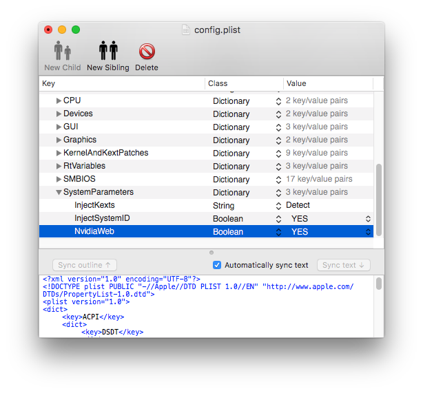

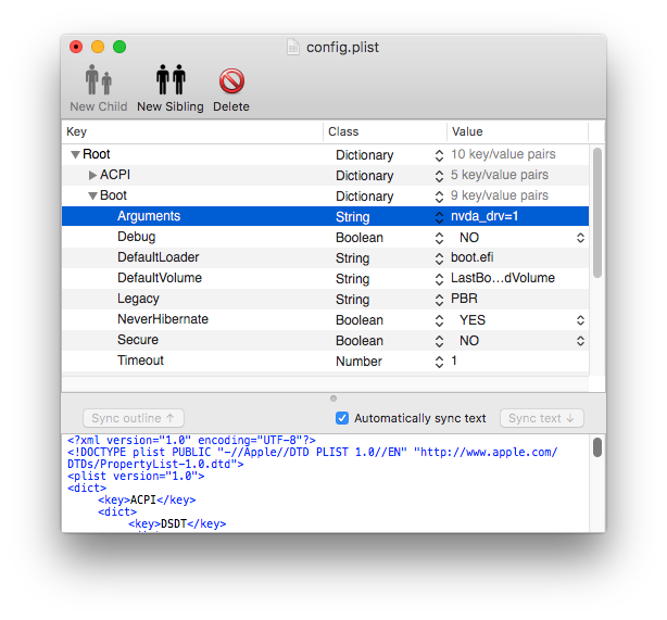

MaLd0n Posted December 20, 2016 Share Posted December 20, 2016 i have same problem. i need use nvda_drv=1 in "boot" and "parameters" NvidiaWeb=1 Only work if i use both Link to comment https://www.insanelymac.com/forum/topic/319425-nvidia-gtx-970-gigabyte-ga-z170xp-sli-fail-after-updating-the-bios/#findComment-2337423 Share on other sites More sharing options...
