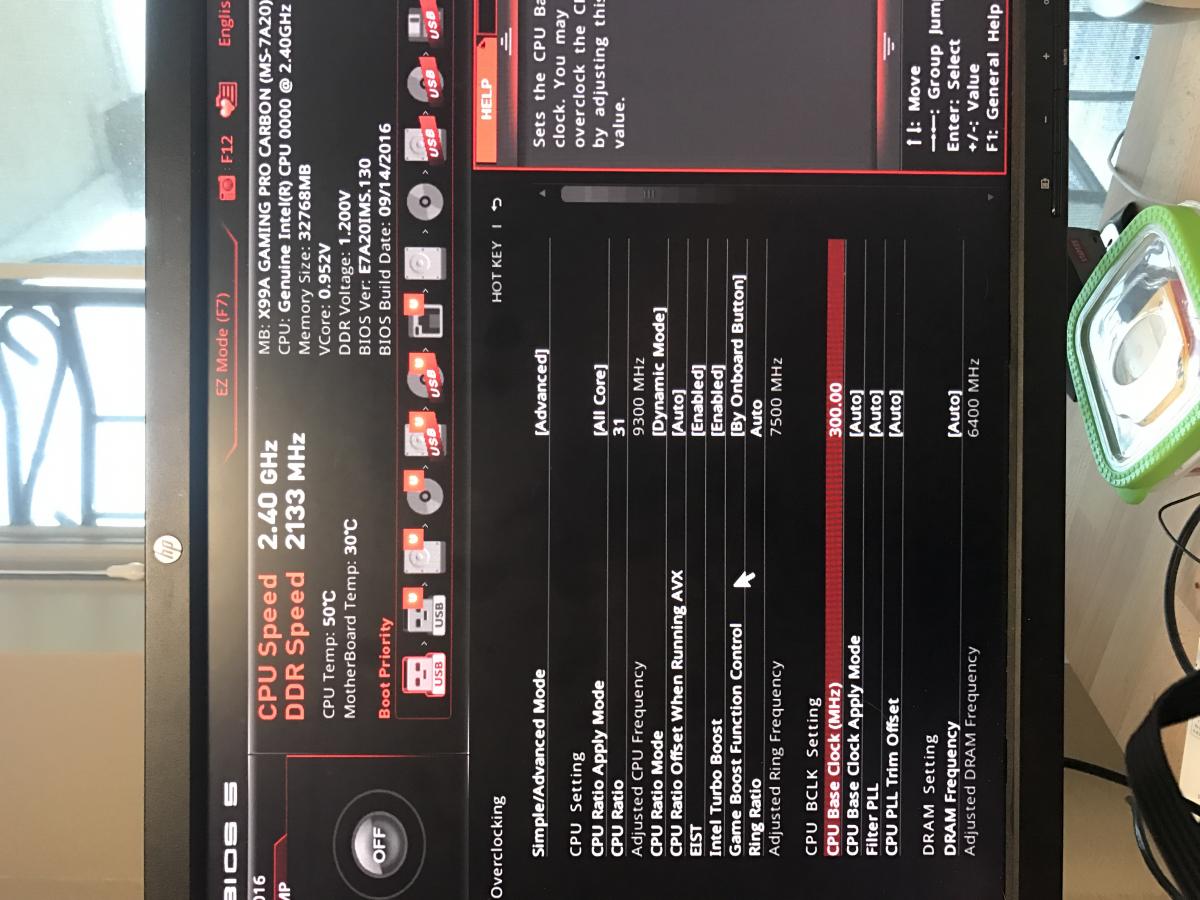

nbritton Posted November 24, 2016 Author Share Posted November 24, 2016 I'm not sure what uncore is, but I believe the 2680v4 is unlocked since I can change the base frequency and multiplier. The chip is marked QHVA, and currently I have it working with a MSI X99A Gaming Pro Carbon, tested with BIOS V1.2 and V1.3. Architecture: x86_64 CPU op-mode(s): 32-bit, 64-bit Byte Order: Little Endian CPU(s): 28 On-line CPU(s) list: 0-27 Thread(s) per core: 2 Core(s) per socket: 14 Socket(s): 1 NUMA node(s): 1 Vendor ID: GenuineIntel CPU family: 6 Model: 79 Model name: Genuine Intel(R) CPU 0000 @ 2.40GHz Stepping: 0 CPU MHz: 1201.875 CPU max MHz: 3100.0000 CPU min MHz: 1200.0000 BogoMIPS: 4799.45 Virtualization: VT-x L1d cache: 32K L1i cache: 32K L2 cache: 256K L3 cache: 35840K NUMA node0 CPU(s): 0-27 Flags: fpu vme de pse tsc msr pae mce cx8 apic sep mtrr pge mca cmov pat pse36 clflush dts acpi mmx fxsr sse sse2 ss ht tm pbe syscall nx pdpe1gb rdtscp lm constant_tsc arch_perfmon pebs bts rep_good nopl xtopology nonstop_tsc aperfmperf eagerfpu pni pclmulqdq dtes64 monitor ds_cpl vmx smx est tm2 ssse3 sdbg fma cx16 xtpr pdcm pcid dca sse4_1 sse4_2 x2apic movbe popcnt tsc_deadline_timer aes xsave avx f16c rdrand lahf_lm abm 3dnowprefetch intel_pt tpr_shadow vnmi flexpriority ept vpid fsgsbase tsc_adjust bmi1 hle avx2 smep bmi2 erms invpcid rtm cqm rdseed adx smap xsaveopt cqm_llc cqm_occup_llc cqm_mbm_total cqm_mbm_local dtherm ida arat pln pts Processor Information Socket Designation: SOCKET 0 Type: Central Processor Family: Xeon Manufacturer: Intel ID: F0 06 04 00 FF FB EB BF Signature: Type 0, Family 6, Model 79, Stepping 0 Flags: FPU (Floating-point unit on-chip) VME (Virtual mode extension) DE (Debugging extension) PSE (Page size extension) TSC (Time stamp counter) MSR (Model specific registers) PAE (Physical address extension) MCE (Machine check exception) CX8 (CMPXCHG8 instruction supported) APIC (On-chip APIC hardware supported) SEP (Fast system call) MTRR (Memory type range registers) PGE (Page global enable) MCA (Machine check architecture) CMOV (Conditional move instruction supported) PAT (Page attribute table) PSE-36 (36-bit page size extension) CLFSH (CLFLUSH instruction supported) DS (Debug store) ACPI (ACPI supported) MMX (MMX technology supported) FXSR (FXSAVE and FXSTOR instructions supported) SSE (Streaming SIMD extensions) SSE2 (Streaming SIMD extensions 2) SS (Self-snoop) HTT (Multi-threading) TM (Thermal monitor supported) PBE (Pending break enabled) Version: Genuine Intel(R) CPU 0000 @ 2.40GHz Voltage: 0.2 V External Clock: 100 MHz Max Speed: 4000 MHz Current Speed: 2400 MHz Status: Populated, Enabled Upgrade: Socket LGA2011-3 L1 Cache Handle: 0x0067 L2 Cache Handle: 0x0068 L3 Cache Handle: 0x0069 Serial Number: Not Specified Asset Tag: Not Specified Part Number: Not Specified Core Count: 14 Core Enabled: 14 Thread Count: 28 Characteristics: 64-bit capable Multi-Core Hardware Thread Execute Protection Enhanced Virtualization Power/Performance Control Link to comment Share on other sites More sharing options...
okrasit Posted November 24, 2016 Share Posted November 24, 2016 The "unlocked" refers to the core multiplier lock bit not being set, allowing you to only under clock on E5 2600 v1/v2/v3/v4 Xeons. Setting any higher multipliers, than the cpu is rated for, will simply do the max rated multi. The only setting, that actually does something, is the BCLK and it'll max out at around < 110MHz. The gain from overclocking via BCLK is, in fact, near zero because of the "on die" voltage regulators current limiter -> the cpu will start to throttle. The crippled uncore frequency adds latency (40% x16 vs x27), not only to the L3 cache but to the memory controller, QPI, SA -> PCIe and so on. It'll cascade on a dual socket system, giving you a really unresponsive system. Link to comment Share on other sites More sharing options...
nbritton Posted November 25, 2016 Author Share Posted November 25, 2016 The "unlocked" refers to the core multiplier lock bit not being set, allowing you to only under clock on E5 2600 v1/v2/v3/v4 Xeons. Setting any higher multipliers, than the cpu is rated for, will simply do the max rated multi. The only setting, that actually does something, is the BCLK and it'll max out at around < 110MHz. The gain from overclocking via BCLK is, in fact, near zero because of the "on die" voltage regulators current limiter -> the cpu will start to throttle. The crippled uncore frequency adds latency (40% x16 vs x27), not only to the L3 cache but to the memory controller, QPI, SA -> PCIe and so on. It'll cascade on a dual socket system, giving you a really unresponsive system. What do you mean crippled? A single 2680v4 is faster than my dual X5690 Mac Pro. However, I logged my system load on my Mac Pro over the last day and I only averaged 1.775 (uptime command, 15 minute average, n = 44, x̅ = 1.775, s = 0.7631), max was under 4 for a normal workload. RAM usage ranges from 50GB to 100GB. So since my workload can't max out even a single X5690 I'm doubting that upgrading to dual 2680v4 would yield practical gains relative to what I have now. Link to comment Share on other sites More sharing options...
