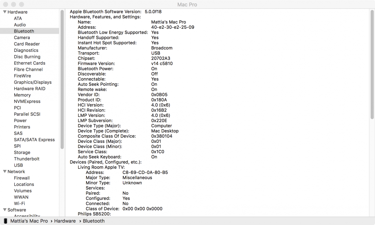

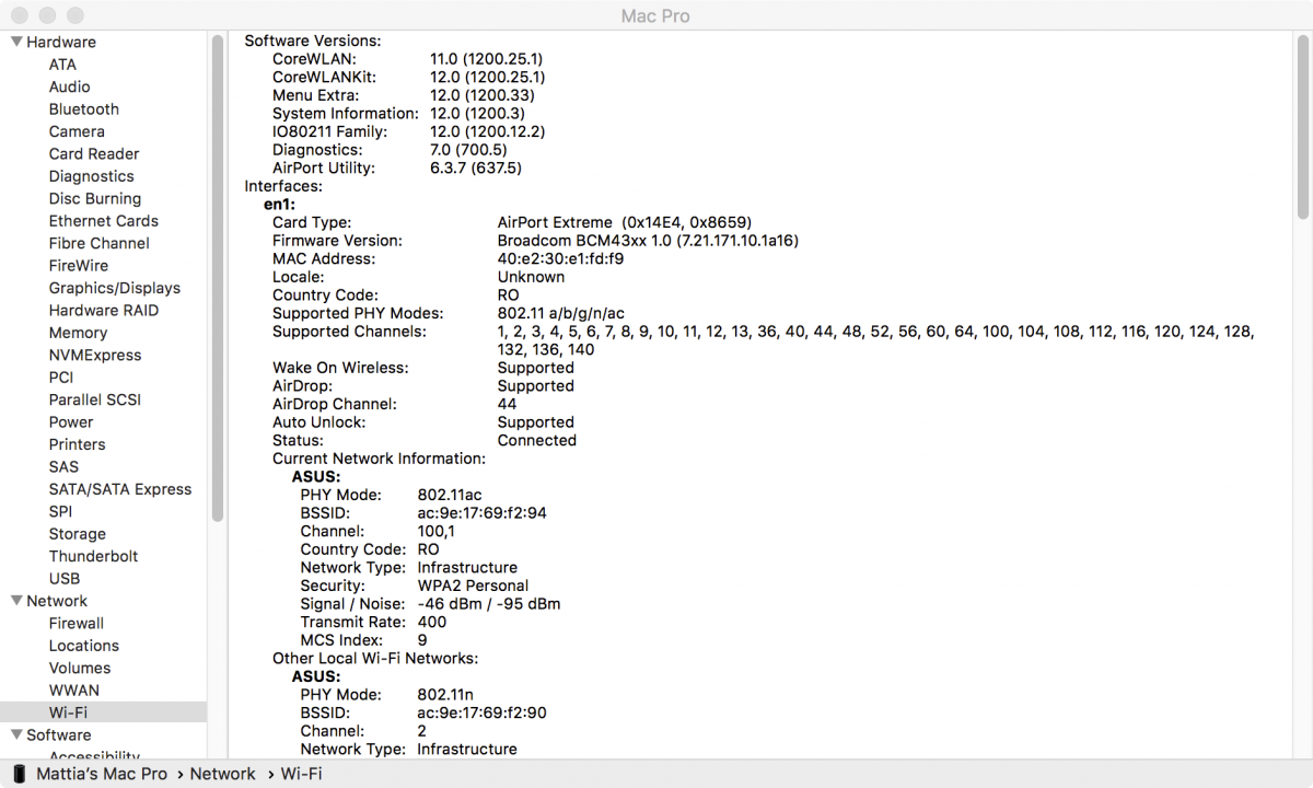

Hello Guys!
Today I've completed without any error the installation of Sierra on my Hakintosh.
Instead of whatever happen with El Captain, now the bluetooth and Wifi Card is working as a charm, but the only thing that it's not working at all, is Handoff and Continuity.
Airdrop is working without any problem, but the other 2 feature they don't wanna start.
Update 1: I've finished the tests, and FaceTime call from the phone: I see the notification but if I press Answer the call drop with an error. Unlock with Apple Watch: I can complete the setup, but it's not working. Airdrop: Working Perfectly, Handoff and Continuity: Nothing Happen, I didn't see the app icon in bottom left of the bar.
Update 2: I've updated the Kext and now I see the icon for the Handoff in the bottom but when I press it, nothing happen, the mail keep loading forever and same the web pages.
Update 3: Now it's seems also working from Mac to iPhone, but not in the reverse order...
basically my situation is the same as this one, but with a different chip: https://www.tonymacx86.com/threads/sierra-10-12-1-bcm94532z-hand-off.206078/
the Wifi + BT Card is the BCM94360CS2 and in the screenshots I will show you how this card is now identified by the system and with patch I have in clover.
