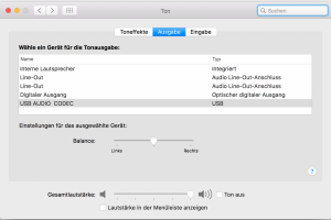

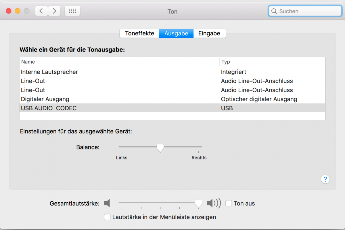

Panamamax Posted October 4, 2016 Share Posted October 4, 2016 Good day... i cannot get rid of stuttering Audio. i followed this installation guide: i further bought a USB sound device that i can see in my Audio settings... hoping that it will fix my stuttering audio... however no improvement. I can choose where i want to output my Audio, everywhere including the optical output and the USB outputs i can output the music, however all of them have stuttering sound with the sound coming and going 2-3 times per second... any idea how to fix it? couldn't find much information about stuttering sound... my system is 10.12 on a Supermicro X10SRA-F board that runs the ALC1150 chip... Link to comment https://www.insanelymac.com/forum/topic/316396-stuttering-audio-alc1150-1012/ Share on other sites More sharing options...
Panamamax Posted October 4, 2016 Author Share Posted October 4, 2016 Further followed the following guide for the installation of the VoodooHDA with the same results... Stuttering ...Anybody? Link to comment https://www.insanelymac.com/forum/topic/316396-stuttering-audio-alc1150-1012/#findComment-2292280 Share on other sites More sharing options...

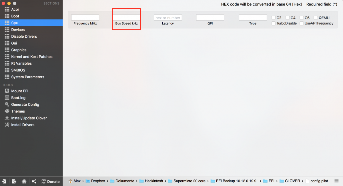

okrasit Posted October 4, 2016 Share Posted October 4, 2016 If they differ, you'll have to compensate with Clover's BusSpeedKhz! That is, if u r using some unsupported cpu! Link to comment https://www.insanelymac.com/forum/topic/316396-stuttering-audio-alc1150-1012/#findComment-2292726 Share on other sites More sharing options...

okrasit Posted October 5, 2016 Share Posted October 5, 2016 You've got to check Clover for the value you currently have but I'm guessing it's near 100000. So 1995381892/2693765538 * whatyouhavenow ~= 74074. Put that in your clover config.plist! Or type it in on boot in Clover's options -> CPU -> bus freq. Link to comment https://www.insanelymac.com/forum/topic/316396-stuttering-audio-alc1150-1012/#findComment-2293141 Share on other sites More sharing options...
Panamamax Posted October 5, 2016 Author Share Posted October 5, 2016 Good day! currently the field is empty... so what do i have to fill in there? Link to comment https://www.insanelymac.com/forum/topic/316396-stuttering-audio-alc1150-1012/#findComment-2293273 Share on other sites More sharing options...
okrasit Posted October 5, 2016 Share Posted October 5, 2016 You should start with 74074 and then do another round of fixing until you get it right! Link to comment https://www.insanelymac.com/forum/topic/316396-stuttering-audio-alc1150-1012/#findComment-2293306 Share on other sites More sharing options...

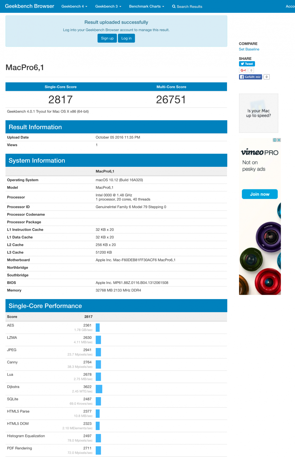

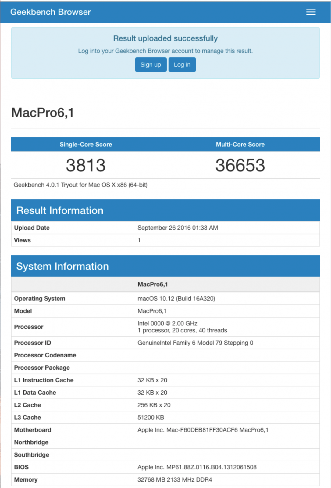

Panamamax Posted October 6, 2016 Author Share Posted October 6, 2016 Turns out that the bus speed fix is killing my cpu speed... in the about this mac i t shows 1,5ghz instead of 2 and the performance reallz sucks... any idea how to have both... sound and perforance??? Link to comment https://www.insanelymac.com/forum/topic/316396-stuttering-audio-alc1150-1012/#findComment-2293929 Share on other sites More sharing options...
okrasit Posted October 6, 2016 Share Posted October 6, 2016 It was actually running at that speed before too, your clock was just running slow! The issue is that you've got no turbo. There's two ways to handle this: Bus Speed & https://www.dropbox.com/s/102fk4i8xv86466/msr199withUncore_max.kext.zip?dl=0 OR Use piker's kernel patch -> xcpm. Link to comment https://www.insanelymac.com/forum/topic/316396-stuttering-audio-alc1150-1012/#findComment-2293960 Share on other sites More sharing options...
Panamamax Posted October 6, 2016 Author Share Posted October 6, 2016 hmm this sounds very strange.., only by applying the Bus Speed, my performance changes from this to that... if i remove the frequency the speed goes up again... will try and see if adding the msr199 kext will re-establish my performance once i change the bus speed tonight... Link to comment https://www.insanelymac.com/forum/topic/316396-stuttering-audio-alc1150-1012/#findComment-2294191 Share on other sites More sharing options...
okrasit Posted October 6, 2016 Share Posted October 6, 2016 hmm this sounds very strange.., only by applying the Bus Speed, my performance changes from this to that... if i remove the frequency the speed goes up again... will try and see if adding the msr199 kext will re-establish my performance once i change the bus speed tonight... You see, if you don't compensate the TSC frequency error, one second on your computer now actually lasts for 1,35s! That's exactly the multiplier for the scores... It's not faster it's just WRONG. So, you're not re-establisishing performance, you're getting it right! Link to comment https://www.insanelymac.com/forum/topic/316396-stuttering-audio-alc1150-1012/#findComment-2294368 Share on other sites More sharing options...
