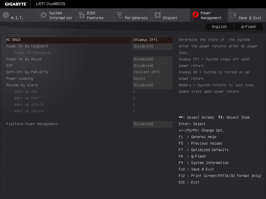

Adventuro-3 Posted September 11, 2016 Share Posted September 11, 2016 My new Skylake build is mostly working. When I choose shutdown from my OS X 10.11.6 installation, everything goes well and the computer shuts off; no drives, fans, or lights appear to be active. However, if I press any key on the keyboard, or remove or attach any USB device, the computer will boot from the BIOS as if I pressed the power button. I have disabled "Power on by Keyboard" and "Power on by Mouse" in the BIOS (version F4 – the latest for this board) so this is confusing. Also, when I used Clonezilla to backup my hard disk, the computer shuts down properly from the Linux OS that it uses and required the power button to boot. I am running the latest version of Clover for my boot loader. I would like to fix this if possible, as the computer will boot at the slightest movement, touch to keyboard, etc. the way it is now. Link to comment https://www.insanelymac.com/forum/topic/315136-startup-from-keyboard-after-successful-shutdown-why/ Share on other sites More sharing options...
