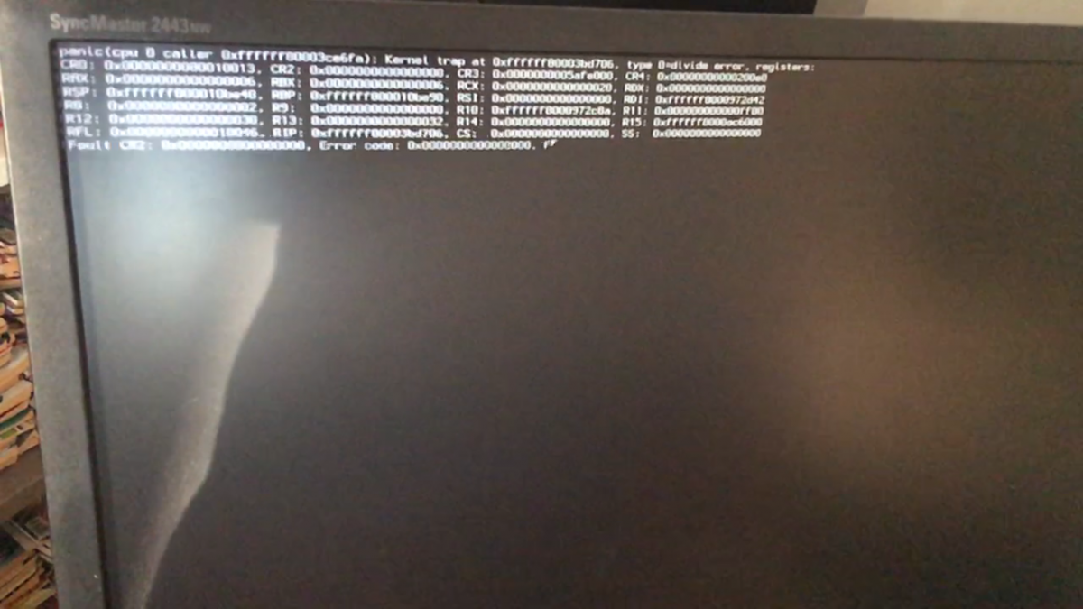

critza Posted August 11, 2016 Share Posted August 11, 2016 I cannot install OSX, i have downloaded the latest 10.11.6 from the Appstore and i have tried several different installmethods, (Chris111 and 2 more) they all end up the same way, i get to the clover boot screen, choose install from USB and then i get panic. Link to comment https://www.insanelymac.com/forum/topic/314149-need-some-help-10116-clover-3688-evga-sr-2-gtx660-panic/ Share on other sites More sharing options...

edin555 Posted August 17, 2016 Share Posted August 17, 2016 Did you get it? critza? The most important stuff is: HPET! in Bios enabled. otherwise you won't break the Kernel Panic. You should also enable all CPU Configuration stuff, but not the Windows XP one, i think its the 3rd or 4th. Then you need AHCI enabled instead of SATA. Choose SMBios 3,1 or 6,1 to install. 5,1 won't work because of the TyDriver... it will work only in dual channel. if you use triple channel install it like i said. hello try this one Do you also have the patches for the DSDT? I would like to enable my NPM. I think he will need it as well. :-) Link to comment https://www.insanelymac.com/forum/topic/314149-need-some-help-10116-clover-3688-evga-sr-2-gtx660-panic/#findComment-2266947 Share on other sites More sharing options...

critza Posted October 24, 2016 Author Share Posted October 24, 2016 Ok i have installed 10.11.6 now and webdrivers from nvidia, but now i see only 12GB ram (i have 24). The performance of my mouse seems a bit strange also and i havent succeded in installing my nersork card yet, i need to upgrade efi Link to comment https://www.insanelymac.com/forum/topic/314149-need-some-help-10116-clover-3688-evga-sr-2-gtx660-panic/#findComment-2305399 Share on other sites More sharing options...
