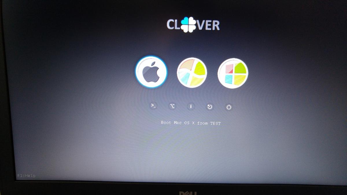

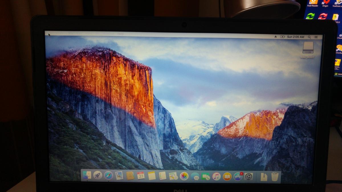

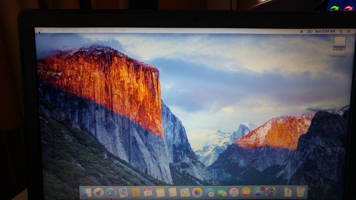

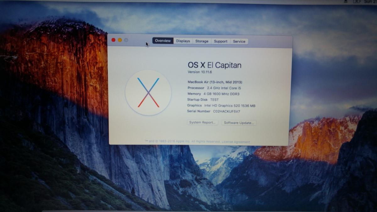

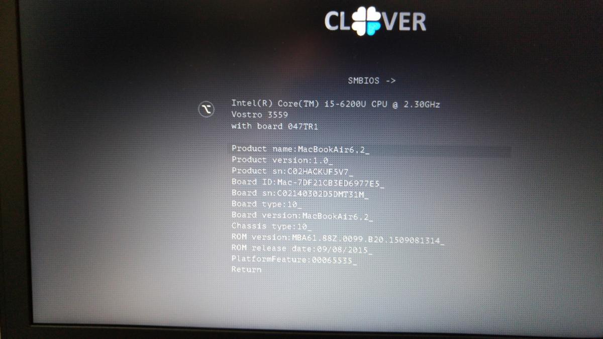

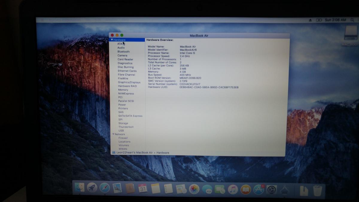

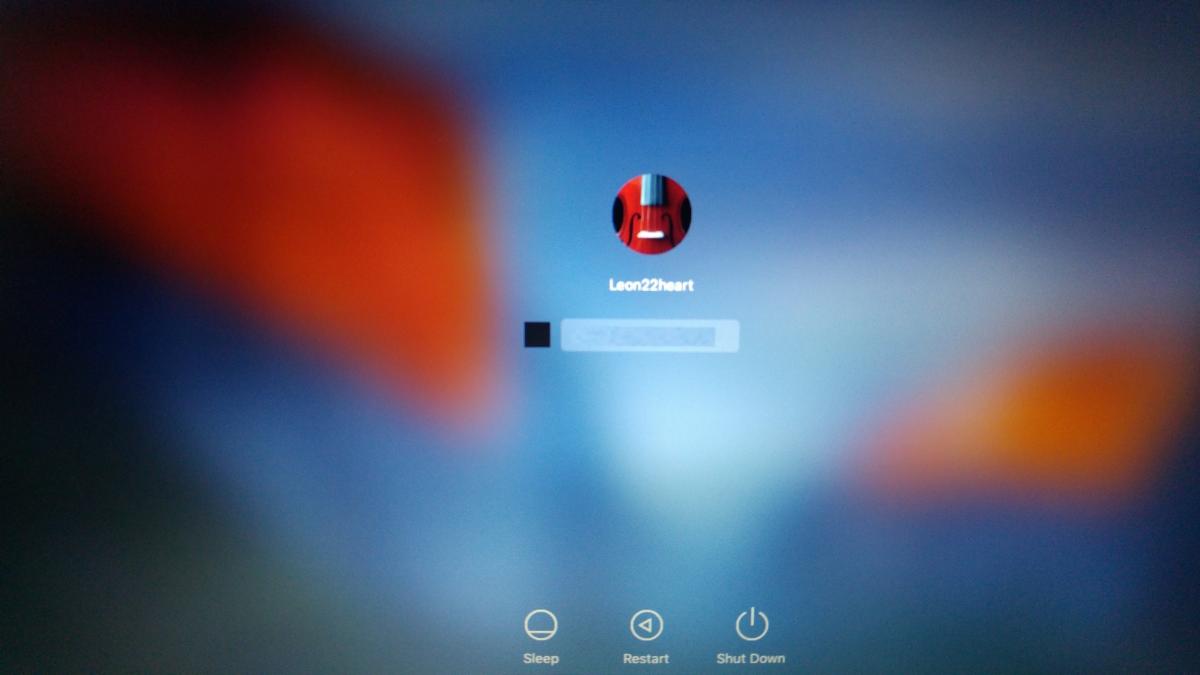

leon22heart Posted July 31, 2016 Share Posted July 31, 2016 I managed to install El Capitan version 10.11.6 in my Dell Vostro using a Fat 32 usb with Clover and a Pandora created install usb (wanted to apply the MBR patch) .The computer had issues seeing my internal sata disk unless i used the intel-100-series-unsupported-patch.kext . Anyways i managed to install everything , but now i have a strange problem . Clover does not see my installation . So i experimented a little . I created a hfs+ partition in an external HDD , installed El Capitan there again and i use that installation to boot to El Capitan (another strange problem , Clover does not see the external HDD Mac if it is already plugged in by boot time . If i disconnect and reconnect the drive my installation is visible and i can go straight to Mac ) . So down below i post my Computer specs generated by Sisoft Sandra and my Clover configuration . If anyone can point me how can i solve the sata visible-invisible bug so i can access my inner disk installation and how to solve the artifacts of the Intel HD520 graphic card (nothing serious , just annoying ) ? Much appreciated . And some screenshots . CLOVER.rar Computer Report.htm Link to comment https://www.insanelymac.com/forum/topic/313774-dell-vostro-3559-el-capitan-10116-nearly-sucess/ Share on other sites More sharing options...

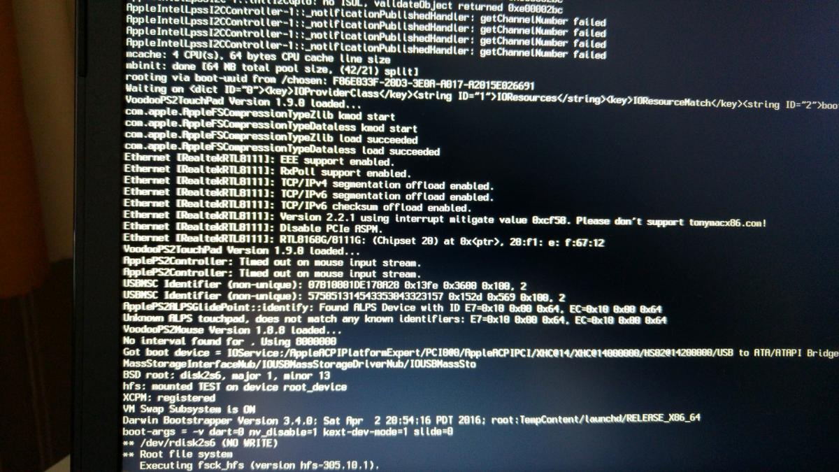

leon22heart Posted July 31, 2016 Author Share Posted July 31, 2016 Thank you very much for your reply . 1. My BIOS does not allow the change and is steady at 128mb .Is there a way to change it via Clover ? 2. DropOEM=false is allready enabled in my .plist 3. The thing that eats me , since the artifacts are a minor thing is the /dev/rsdisk2s6 (NO WRITE) shown in my verbose screenshot posted in the start of the thread . I believe that this error erodes slowly the system and when i try to shutdown it shows umount /home failed , umount /net failed , an error not shown in my Hackingtosh Mavericks Desktop .I can only imagine it has something to do with the sata kext. Link to comment https://www.insanelymac.com/forum/topic/313774-dell-vostro-3559-el-capitan-10116-nearly-sucess/#findComment-2260461 Share on other sites More sharing options...
vusun123 Posted July 31, 2016 Share Posted July 31, 2016 Thank you very much for your reply . 1. My BIOS does not allow the change and is steady at 128mb .Is there a way to change it via Clover ? 2. DropOEM=false is allready enabled in my .plist 3. The thing that eats me , since the artifacts are a minor thing is the /dev/rsdisk2s6 (NO WRITE) shown in my verbose screenshot posted in the start of the thread . I believe that this error erodes slowly the system and when i try to shutdown it shows umount /home failed , umount /net failed , an error not shown in my Hackingtosh Mavericks Desktop .I can only imagine it has something to do with the sata kext. Don't trust Windows's DVMT detection. Use Chameleon/Enoch with no theme to check it. You can visit Austere J's HD5500 guide for the method 1 Link to comment https://www.insanelymac.com/forum/topic/313774-dell-vostro-3559-el-capitan-10116-nearly-sucess/#findComment-2260546 Share on other sites More sharing options...
leon22heart Posted August 1, 2016 Author Share Posted August 1, 2016 Will try the guide and see if i can adjust the allocated memory . Have been experimenting with the issue that even though i installed the os in my internal ssd the system throwed me back errors and kernel panics .So i created a backup of my el capitan that was installed in an external hdd using carbon copy and restored it in my internal hdd .Boom , system boots and works fine . All that is missing are the graphical glitches and the sound . Will reporr back with further sucess. Link to comment https://www.insanelymac.com/forum/topic/313774-dell-vostro-3559-el-capitan-10116-nearly-sucess/#findComment-2260930 Share on other sites More sharing options...
nina51 Posted December 16, 2017 Share Posted December 16, 2017 Will try the guide and see if i can adjust the allocated memory . Have been experimenting with the issue that even though i installed the os in my internal ssd the system throwed me back errors and kernel panics .So i created a backup of my el capitan that was installed in an external hdd using carbon copy and restored it in my internal hdd .Boom , system boots and works fine . All that is missing are the graphical glitches and the sound . Will reporr back with further sucess. Hallo, gegen den Grafik-Fehler hilft einmaliges Ab- und wieder Anmelden des Users (Apfel-Shift Q). Dann läuft die Grafik Link to comment https://www.insanelymac.com/forum/topic/313774-dell-vostro-3559-el-capitan-10116-nearly-sucess/#findComment-2551415 Share on other sites More sharing options...
