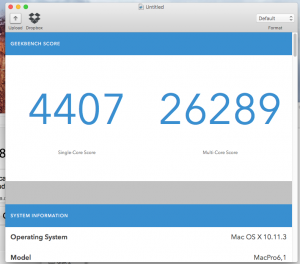

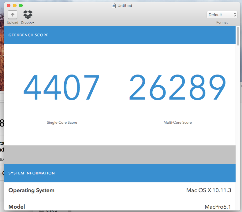

nmano Posted March 11, 2016 Share Posted March 11, 2016 AUTO overclock x99 gigabyteeNo ssdtjust press back panel OC button.OC(yellow light)default bios.USB 3 flash drive with boot loader.xhci-EnabledCSM -disabled. Last login: Fri Mar 11 09:18:13 on console manoranjans-Mac-Pro-2:~ manoranjan$ sudo -s Password: bash-3.2# chown -R 0:0 ~/Desktop/AppleIntelInfo.kext bash-3.2# chmod -R 755 ~/Desktop/AppleIntelInfo.kext bash-3.2# kextload ~/Desktop/AppleIntelInfo.kext bash-3.2# cat /tmp/AppleIntelInfo.dat AppleIntelInfo.kext v1.2 Copyright © 2012-2015 Pike R. Alpha. All rights reserved Settings: ------------------------------------ logMSRs............................: 0 logIGPU............................: 0 logIntelRegs.......................: 1 logCStates.........................: 1 logIPGStyle........................: 1 InitialTSC.........................: 0xc8cce9be7fc MWAIT C-States.....................: 8480 PCH device.................: 0x8D478086 CPU Ratio Info: ------------------------------------ CPU Low Frequency Mode.............: 1200 MHz CPU Maximum non-Turbo Frequency....: 3300 MHz CPU Maximum Turbo Frequency........: 4300 MHz CPU P-States [ (12) 40 ] CPU P-States [ (12) 35 40 ] CPU P-States [ (12) 30 35 40 ] CPU P-States [ (12) 30 31 35 40 ] CPU P-States [ 12 30 31 35 40 (43) ] CPU P-States [ 12 30 31 33 35 40 (43) ] CPU P-States [ (12) 27 30 31 33 35 40 43 ] CPU P-States [ (12) 26 27 30 31 33 35 40 43 ] CPU P-States [ (12) 26 27 30 31 33 35 38 40 43 ] CPU P-States [ (12) 26 27 30 31 33 34 35 38 40 43 ] CPU P-States [ (12) 26 27 30 31 33 34 35 37 38 40 43 ] CPU P-States [ 12 19 26 27 30 31 33 34 35 37 38 40 (43) ] CPU P-States [ (12) 19 26 27 28 30 31 33 34 35 37 38 40 43 ] CPU P-States [ (12) 19 24 26 27 28 30 31 33 34 35 37 38 40 43 ] CPU P-States [ (12) 15 19 24 26 27 28 30 31 33 34 35 37 38 40 43 ] CPU P-States [ (12) 15 19 24 26 27 28 29 30 31 33 34 35 37 38 40 43 ] CPU P-States [ (12) 15 19 20 24 26 27 28 29 30 31 33 34 35 37 38 40 43 ] bash-3.2# please post result Archive.zip Link to comment https://www.insanelymac.com/forum/topic/311342-x99-super-speed-thanks-god-auto-oc/ Share on other sites More sharing options...

nmano Posted March 13, 2016 Author Share Posted March 13, 2016 First try with out SST then check cpu ratio info(AppleIntelInfo.kext) Find CPU Maximum turbo Frequency its my 4300 MHz Set your SSDT ("maxTurboFrequency....: 4300", Debug) Now Install with SSDT. ssdt.zip Link to comment https://www.insanelymac.com/forum/topic/311342-x99-super-speed-thanks-god-auto-oc/#findComment-2223559 Share on other sites More sharing options...
AsusFreak Posted March 14, 2016 Share Posted March 14, 2016 Typical GB score for X99 @ 4300. Link to comment https://www.insanelymac.com/forum/topic/311342-x99-super-speed-thanks-god-auto-oc/#findComment-2223649 Share on other sites More sharing options...
