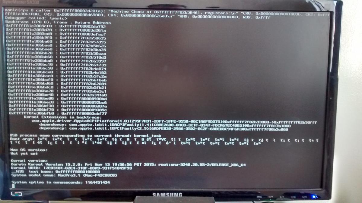

Maf3r0 Posted March 10, 2016 Share Posted March 10, 2016 Hi there, regards. My discrete gpu (gtx660) is going died, so i've tried to boot hackintosh with integrated gpu — HD 3000 (from i5 2500k over z68x-UD3h-B3, UEFI BIOS, v. U1L). The problem is that system boot fails if I remove discrete gpu from PCIe slot, look: but if I put discrete gpu back the system boots ok, over HD 3000, and I can't understand why. Config.plist: <key>Devices</key> <dict> <key>AddProperties</key> <array> <dict> <key>Device</key> <string>IntelGFX</string> <key>Key</key> <string>AAPL,snb-platform-id</string> <key>Value</key> <data> EAADAA== </data> </dict> </array> <key>FakeID</key> <dict> <key>IntelGFX</key> <string>0x01268086</string> </dict> </dict> <key>Graphics</key> <dict> <key>Inject</key> <dict> <key>ATI</key> <false/> <key>Intel</key> <true/> <key>NVidia</key> <false/> </dict> </dict> Any help? Thanks! 1 Link to comment https://www.insanelymac.com/forum/topic/311319-hd-3000-only-works-if-discrete-gpu-is-attatched-why/ Share on other sites More sharing options...

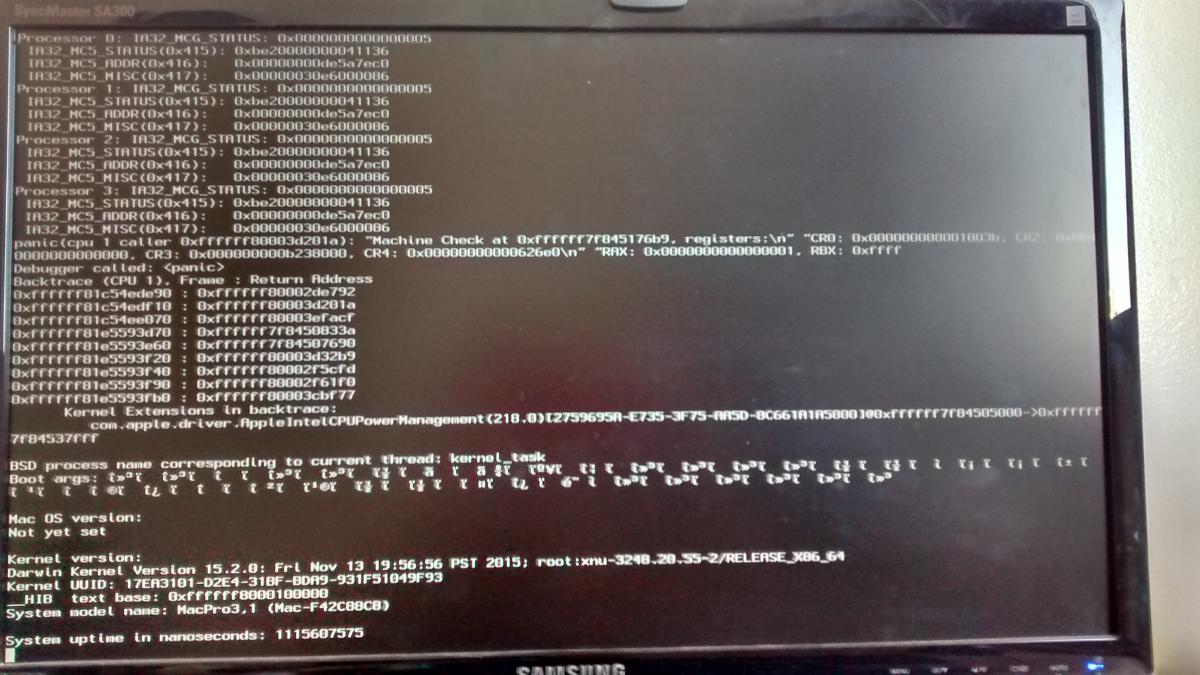

Maf3r0 Posted March 10, 2016 Author Share Posted March 10, 2016 I really don't know what to do. • If (with gtx660) I… Delete Fake-id and properties from Config.plist — the system starts without aceleration;• If (without gtx660) I… Apply the Clover AsusAICPUPM patch — Makes no diference, AICPUPM KP; • If (without gtx660) I… put NullCPUPM.kext on EFI — I got this... • and if I… boot over HD3000 but with gtx660 attatched, — the system restarts randomly bc gtx is dying :cry: :cry: :cry: I think the problem is not related only with gtx, there's something more that's missing, but what??? Configs that i'm trying to boot with HD3000: EFI.zip Thanks to all suggestions, regards! Link to comment https://www.insanelymac.com/forum/topic/311319-hd-3000-only-works-if-discrete-gpu-is-attatched-why/#findComment-2222568 Share on other sites More sharing options...
