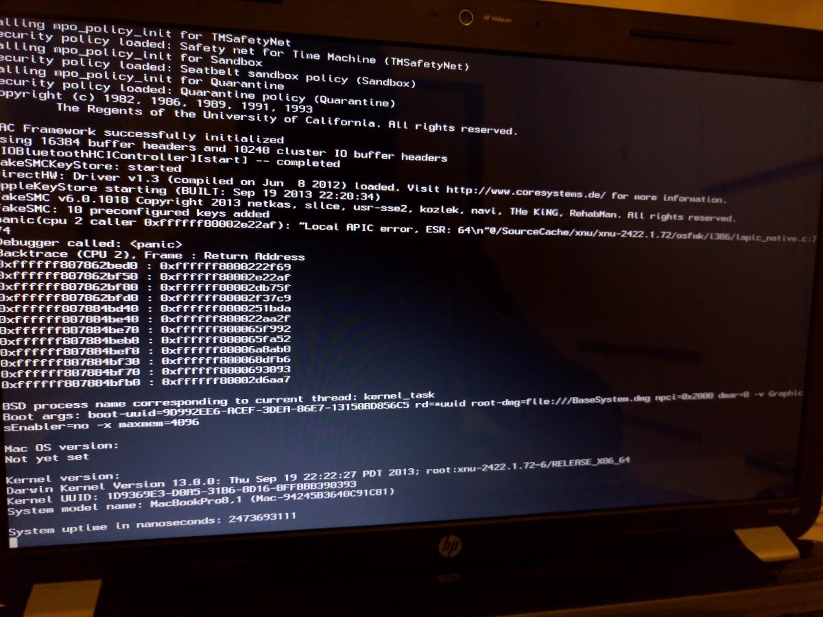

Bliz90 Posted February 22, 2016 Share Posted February 22, 2016 Ciao a tutti! Non riesco a far partire l'installazione di mavericks da USB, infatti ho provato anche ad utilizzare flag come -v, -x, -f, -F, GraphicsEnabler=no/yes, cpu=1, maxmem=2048, ma niente non vuole partire. Allego lo screen dell'errore: CPU= i5-2430M RAM= 4GB VGA= Intel HD 3000 Link to comment https://www.insanelymac.com/forum/topic/311029-problema-boot-hp-pavilion-g6-1268sl/ Share on other sites More sharing options...
carbo178 Posted February 22, 2016 Share Posted February 22, 2016 Lapic error, avvia con cpus=1, non cpu=1 Link to comment https://www.insanelymac.com/forum/topic/311029-problema-boot-hp-pavilion-g6-1268sl/#findComment-2217288 Share on other sites More sharing options...
Bliz90 Posted February 22, 2016 Author Share Posted February 22, 2016 Lapic error, avvia con cpus=1, non cpu=1 Grazie mille! Link to comment https://www.insanelymac.com/forum/topic/311029-problema-boot-hp-pavilion-g6-1268sl/#findComment-2217467 Share on other sites More sharing options...
