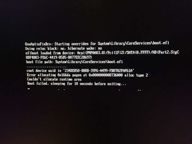

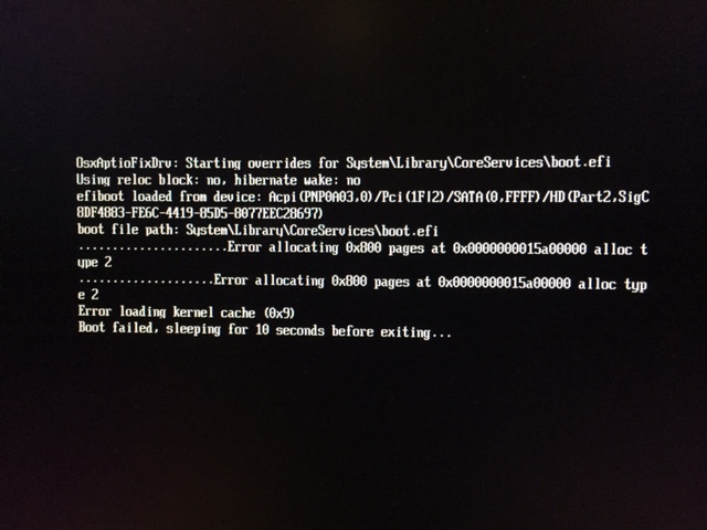

wdogmx Posted February 15, 2016 Share Posted February 15, 2016 I feel like this must have been discussed and solved elsewhere, but I can't find it. I'm on a Gigabyte z97 mobo, running Clover and Yosemite 10.10.5. This is primarily a ProTools rig and has been working well in general, but recently I've been having trouble booting past the Clover screen. Sometimes it'll take three or four reboots before the OS appears to "catch" after which everything is okay. Unpredictable. I've had a few strange Finder crashes after which I generally repair permissions and rebuild the caches, but still get the same issue sometimes. I do have a couple RAM resident utilities I am concerned may be a problem (XtraFinder, Snapper, QuicKeys) but I'm guessing the problem is in my config file somewhere. Booting in verbose mode yields one of two errors (see attached) neither of which I have the experience to understand. Advice would be appreciated. Newbie here on my first Hackintosh and generally loving it except for this…. Quote Link to comment https://www.insanelymac.com/forum/topic/310935-stop-sign-after-clover-when-attempting-to-boot-yosemite-10105/ Share on other sites More sharing options...
carbo178 Posted February 16, 2016 Share Posted February 16, 2016 Try OsxAptioFix2Drv.efi instead of OsxAptioFixDrv.efi Quote Link to comment https://www.insanelymac.com/forum/topic/310935-stop-sign-after-clover-when-attempting-to-boot-yosemite-10105/#findComment-2215976 Share on other sites More sharing options...
wdogmx Posted February 16, 2016 Author Share Posted February 16, 2016 That worked! But the other way - took out OsxAptioFix2Drv.efi and put in OsxAptioFixDrv.efi Thank you! 1 Quote Link to comment https://www.insanelymac.com/forum/topic/310935-stop-sign-after-clover-when-attempting-to-boot-yosemite-10105/#findComment-2215982 Share on other sites More sharing options...
