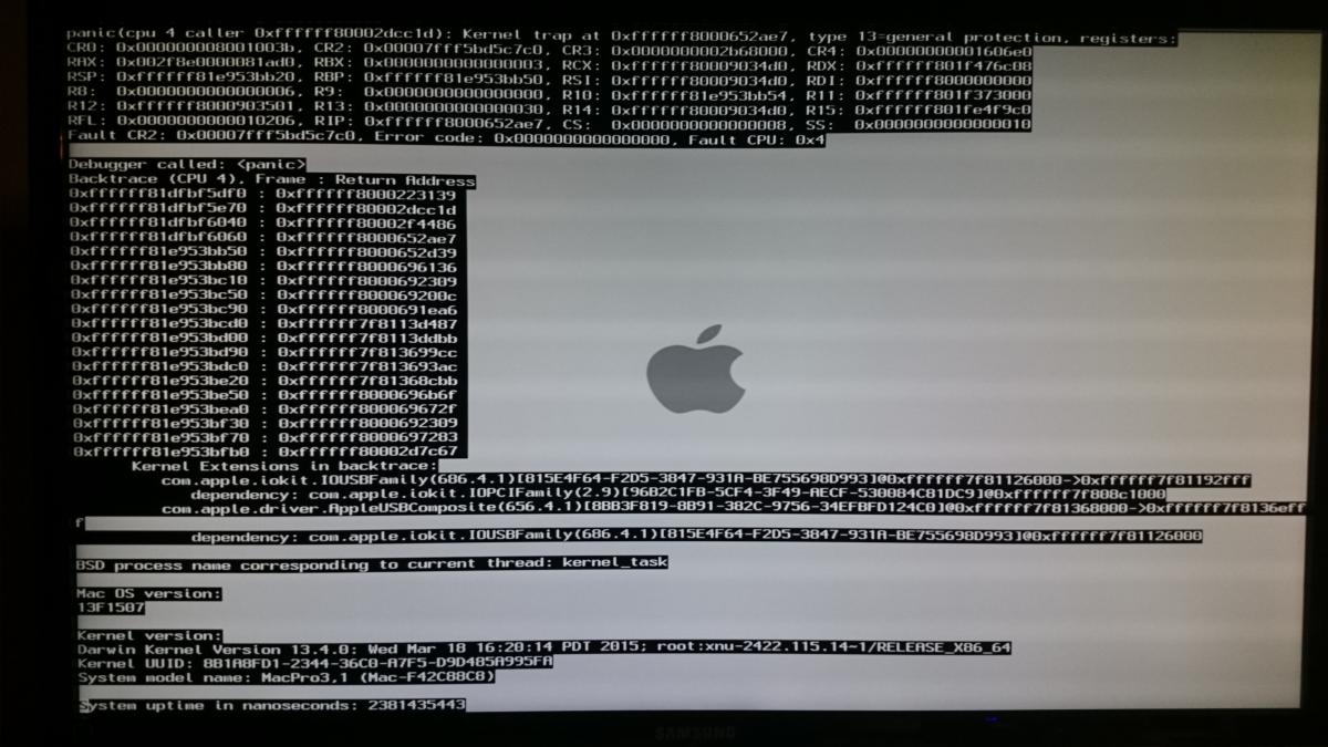

cobl62 Posted February 14, 2016 Share Posted February 14, 2016 Dear all, hope you can help me: installed my hackintosh a year ago..now problems seem to double up: - BT starts to trouble me - sometimes BT Mouse/keyboard does not connect to BT Adapter D-Link BT120 (tried to use another BT adapter, set Bluetooth plist to 1, no change (cant turn it on / off, cannot connect, after a while just worked again) - on booting it gets into kernel panic at least 5 times (pls see screenshot) then it starts normally (tried to start without any USB connected apart from keyboard) - itunes library got mixed up (songs disappeared from harddrive, songs are named differently) Most of all I would like to solve the USB problem...I guess this is most important. Any idea how to solve the USB problem? My system: Gigabyte GeForce GTX 760 OC R2, Windforce 3X, 4096 MBASUS H97M-Plus, Intel H97 MainboardIntel Core i7-4790K 4,0 GHz (Devils Canyon) DDR3RAM 2x 8GB DDR3-1600 Crucial Ballistix Sport Mavericks 10.9.5 Thanks a lot for your help! coble Link to comment https://www.insanelymac.com/forum/topic/310928-kernel-panic-iousbfamily/ Share on other sites More sharing options...
cobl62 Posted February 15, 2016 Author Share Posted February 15, 2016 Hi Hervé yes I have got one, but its never connected. I was rebooting without any USB device connected (apart from my keyboard). But its still the same. Any other idea. coble Link to comment https://www.insanelymac.com/forum/topic/310928-kernel-panic-iousbfamily/#findComment-2215797 Share on other sites More sharing options...
cobl62 Posted February 15, 2016 Author Share Posted February 15, 2016 cool! it worked! thank you very much! Link to comment https://www.insanelymac.com/forum/topic/310928-kernel-panic-iousbfamily/#findComment-2215918 Share on other sites More sharing options...
