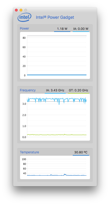

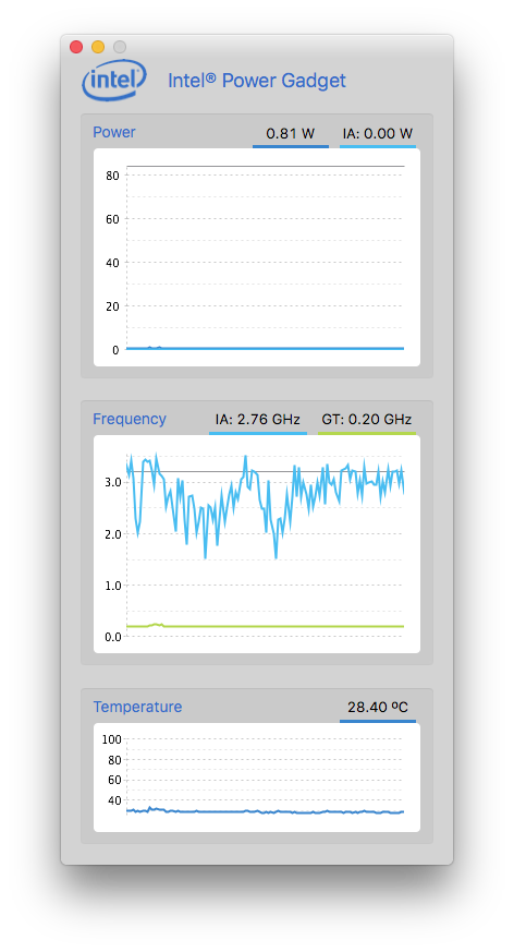

Kynyo Posted January 1, 2016 Share Posted January 1, 2016 Hello everyone!I generated an ssdt using https://github.com/Piker-Alpha/ssdtPRGen.shbut as a result PM its not working properly. System is that from signature. Bootloader used : Ozmosis 167x CPU: i5 4570 OS: OS X 10.11.3 SMBIOS: iMac 14,2 ssdt its in EFI partition ACPI / Load. At full speed CPU remains stucked at 3.5 Ghz, not it's original 3.6 Ghz. If anyone has AppleIntelInfo 1.2 compiled kext to verify P-States, I appreciate. I can't download XCode right now. What could be the problem? Link to comment https://www.insanelymac.com/forum/topic/310154-power-management-not-working-as-expected/ Share on other sites More sharing options...
Kynyo Posted January 1, 2016 Author Share Posted January 1, 2016 NullCPU is not present. Kernel PM seems activated in ozmosis defaults.plist (-xcpm argument) xcpm registered in console log. ssdt is loaded at boot (bdmesg log) Link to comment https://www.insanelymac.com/forum/topic/310154-power-management-not-working-as-expected/#findComment-2202380 Share on other sites More sharing options...
Kynyo Posted January 2, 2016 Author Share Posted January 2, 2016 Dpcimanager isn't working with el capitan. Yeah system boots even without xcpm argument. Motherboard is PM free ( no need for PMpatch). Link to comment https://www.insanelymac.com/forum/topic/310154-power-management-not-working-as-expected/#findComment-2202469 Share on other sites More sharing options...

Kynyo Posted February 17, 2016 Author Share Posted February 17, 2016 I think I've found the problem. AppleIntelCPUPowermanagement.kext doesn't gets load at system boot for some reason, only manually kextload by terminal. CSR OFF, SMBIOS iMac 14,2, Which may be the cause? Thanks. Link to comment https://www.insanelymac.com/forum/topic/310154-power-management-not-working-as-expected/#findComment-2216262 Share on other sites More sharing options...
Kynyo Posted February 17, 2016 Author Share Posted February 17, 2016 Ah, got it! XCPM: Mode can be used with Ozmosis (as argument)? Link to comment https://www.insanelymac.com/forum/topic/310154-power-management-not-working-as-expected/#findComment-2216294 Share on other sites More sharing options...
Kynyo Posted February 17, 2016 Author Share Posted February 17, 2016 i used to see somewhere, i can't remember where -xcpm argument inserted into defaults.plist. Do I have to patch the kernel if my mobo isn't MSR Locked? EDIT: Solved by disabling EIST into CPU PM settings and boot argument -xcpm in Defaults.plist of Ozmosis (167X-MASS).Thanks. AppleIntelInfo.kext v1.2 Copyright © 2012-2015 Pike R. Alpha. All rights reserved Settings: ------------------------------------ logMSRs............................: 1 logIGPU............................: 1 logIntelRegs.......................: 1 logCStates.........................: 1 logIPGStyle........................: 1 InitialTSC.........................: 0x2accce99aa0 MWAIT C-States.....................: 270624 Model Specific Regiters ------------------------------------ MSR_CORE_THREAD_COUNT......(0x35) : 0x40004 MSR_PLATFORM_INFO..........(0xCE) : 0x80838F3012000 MSR_PMG_CST_CONFIG_CONTROL.(0xE2) : 0x1E000005 MSR_PMG_IO_CAPTURE_BASE....(0xE4) : 0x1814 IA32_MPERF.................(0xE7) : 0x9C96F29BC IA32_APERF.................(0xE8) : 0xA7F7E5062 MSR_FLEX_RATIO.............(0x194) : 0x0 MSR_IA32_PERF_STATUS.......(0x198) : 0x228000002300 MSR_IA32_PERF_CONTROL......(0x199) : 0x2400 IA32_CLOCK_MODULATION......(0x19A) : 0x0 IA32_THERM_STATUS..........(0x19C) : 0x88490000 IA32_MISC_ENABLES..........(0x1A0) : 0x850089 MSR_MISC_PWR_MGMT..........(0x1AA) : 0x1 MSR_TURBO_RATIO_LIMIT......(0x1AD) : 0x24242424 IA32_ENERGY_PERF_BIAS......(0x1B0) : 0x1 MSR_POWER_CTL..............(0x1FC) : 0x4005F MSR_RAPL_POWER_UNIT........(0x606) : 0xA0E03 MSR_PKG_POWER_LIMIT........(0x610) : 0xFFD00000EA82 MSR_PKG_ENERGY_STATUS......(0x611) : 0xD28C96 MSR_PKG_POWER_INFO.........(0x614) : 0x2A0 MSR_PP0_CURRENT_CONFIG.....(0x601) : 0x1F40 MSR_PP0_POWER_LIMIT........(0x638) : 0xFFD0 MSR_PP0_ENERGY_STATUS......(0x639) : 0x0 MSR_PP0_POLICY.............(0x63a) : 0x0 MSR_PP1_POWER_LIMIT........(0x640) : 0xFFD0 MSR_PP1_ENERGY_STATUS......(0x641) : 0x0 MSR_PP1_POLICY.............(0x642) : 0x18 MSR_CONFIG_TDP_NOMINAL.....(0x648) : 0x20 MSR_CONFIG_TDP_LEVEL1......(0x649) : 0x0 MSR_CONFIG_TDP_LEVEL2......(0x64a) : 0x0 MSR_CONFIG_TDP_CONTROL.....(0x64b) : 0x80000000 MSR_TURBO_ACTIVATION_RATIO.(0x64c) : 0x0 MSR_PKGC3_IRTL.............(0x60a) : 0x8842 MSR_PKGC6_IRTL.............(0x60b) : 0x8873 MSR_PKGC7_IRTL.............(0x60c) : 0x8891 MSR_PKG_C2_RESIDENCY.......(0x60d) : 0x19814B1F940 MSR_PKG_C3_RESIDENCY.......(0x3f8) : 0x0 MSR_PKG_C6_RESIDENCY.......(0x3f9) : 0x0 MSR_PKG_C7_RESIDENCY.......(0x3fa) : 0x0 IA32_TSC_DEADLINE..........(0x6E0) : 0x2ACCF5660FD PCH device.................: 0x8C448086 Intel Register Data ------------------------------------ CPU_VGACNTRL...............: 0x3AD092E1 IS_HASWELL(devid) || IS_BROADWELL(devid) HSW_PWR_WELL_CTL1..........: 0xe5ef9a81 HSW_PWR_WELL_CTL2..........: 0x4700ffc5 HSW_PWR_WELL_CTL3..........: 0xfa26cdb8 HSW_PWR_WELL_CTL4..........: 0xd487c238 HSW_PWR_WELL_CTL5..........: 0x33f6d6a4 HSW_PWR_WELL_CTL6..........: 0xdaaadc31 PIPE_DDI_FUNC_CTL_A........: 0xff0c0c0c (enabled, port reserved, mode reserved, 8 bpc, -VSync, -HSync, EDP A ON, reserved width) PIPE_DDI_FUNC_CTL_B........: 0x34384545 (disabled, DDID, FDI, 12 bpc, -VSync, -HSync, EDP A ONOFF, reserved width) PIPE_DDI_FUNC_CTL_C........: 0xfff4f4f4 (enabled, port reserved, mode reserved, bpc reserved, -VSync, -HSync, EDP input reserved, reserved width) PIPE_DDI_FUNC_CTL_EDP......: 0x5f534e45 (disabled, port reserved, mode reserved, bpc reserved, +VSync, +HSync, EDP A ONOFF, reserved width) DP_TP_CTL_A................: 0x00000000 DP_TP_CTL_B................: 0x00000000 DP_TP_CTL_C................: 0x00000000 DP_TP_CTL_D................: 0x00000000 DP_TP_CTL_E................: 0x00000000 DP_TP_STATUS_A.............: 0x00000000 DP_TP_STATUS_B.............: 0x00000000 DP_TP_STATUS_C.............: 0x00000000 DP_TP_STATUS_D.............: 0x00000000 DP_TP_STATUS_E.............: 0x00000000 DDI_BUF_CTL_A..............: 0x00000000 (disabled not reversed x1 not detected) DDI_BUF_CTL_B..............: 0x00000000 (disabled not reversed x1 not detected) DDI_BUF_CTL_C..............: 0x00000000 (disabled not reversed x1 not detected) DDI_BUF_CTL_D..............: 0x00000000 (disabled not reversed x1 not detected) DDI_BUF_CTL_E..............: 0x00000000 (disabled not reversed x1 not detected) SPLL_CTL...................: 0x00000000 LCPLL_CTL..................: 0x00000000 WRPLL_CTL1.................: 0x00000000 WRPLL_CTL2.................: 0x1f7b5438 PORT_CLK_SEL_A.............: 0x00000000 (LCPLL 2700) PORT_CLK_SEL_B.............: 0x00000000 (LCPLL 2700) PORT_CLK_SEL_C.............: 0x353ebaf0 (LCPLL 1350) PORT_CLK_SEL_D.............: 0x00000001 (LCPLL 2700) PORT_CLK_SEL_E.............: 0x00000000 (LCPLL 2700) PIPE_CLK_SEL_A.............: 0x00000000 (None) PIPE_CLK_SEL_B.............: 0x00000000 (None) PIPE_CLK_SEL_C.............: 0x00000000 (None) SFUSE_STRAP................: 0xffffffff (display disabled, crt yes, lane reversal yes, port b yes, port c yes, port d yes) PIPEASRC...................: 0xff0d0d0d (65294, 3342) DSPACNTR...................: 0x1c000000 (disabled) DSPASTRIDE.................: 0x1a000000 (6815744) DSPASURF...................: 0x15000000 DSPATILEOFF................: 0x13000000 (0, 4864) PIPEBSRC...................: 0x0a453031 (2630, 12338) DSPBCNTR...................: 0x726f5f65 (disabled) DSPBSTRIDE.................: 0x00000000 (0) DSPBSURF...................: 0x3804c6c3 DSPBTILEOFF................: 0x00000000 (0, 0) PIPECSRC...................: 0xfff7f7f7 (65528, 63480) DSPCCNTR...................: 0x00000002 (disabled) DSPCSTRIDE.................: 0x36f85d39 (14410100) DSPCSURF...................: 0x00000001 DSPCTILEOFF................: 0x00000009 (9, 0) PIPEACONF..................: 0x18000000 (disabled, inactive, pf-pd, rotate 0, 8bpc) HTOTAL_A...................: 0xff0c0c0c (3085 active, 65293 total) HBLANK_A...................: 0xff0c0c0c (3085 start, 65293 end) HSYNC_A....................: 0xff0d0d0d (3342 start, 65294 end) VTOTAL_A...................: 0xff0d0d0d (3342 active, 65294 total) VBLANK_A...................: 0xff0d0d0d (3342 start, 65294 end) VSYNC_A....................: 0xff0d0d0d (3342 start, 65294 end) VSYNCSHIFT_A...............: 0xff0d0d0d PIPEA_DATA_M1..............: 0xff0c0c0c (TU 128, val 0xc0c0c 789516) PIPEA_DATA_N1..............: 0xff0d0d0d (val 0xd0d0d 855309) PIPEA_LINK_M1..............: 0xff0c0c0c (val 0xc0c0c 789516) PIPEA_LINK_N1..............: 0xff0d0d0d (val 0xd0d0d 855309) PIPEBCONF..................: 0x00000000 (disabled, inactive, pf-pd, rotate 0, 8bpc) HTOTAL_B...................: 0x43303045 (12358 active, 17201 total) HBLANK_B...................: 0x37414542 (17731 start, 14146 end) HSYNC_B....................: 0x33344242 (16963 start, 13109 end) VTOTAL_B...................: 0x370a4132 (16691 active, 14091 total) VBLANK_B...................: 0x44343030 (12337 start, 17461 end) VSYNC_B....................: 0x42443230 (12849 start, 16965 end) VSYNCSHIFT_B...............: 0x34394446 PIPEB_DATA_M1..............: 0x3036360a (TU 25, val 0x36360a 3552778) PIPEB_DATA_N1..............: 0x32313842 (val 0x313842 3225666) PIPEB_LINK_M1..............: 0x41350a44 (val 0x350a44 3476036) PIPEB_LINK_N1..............: 0x44464135 (val 0x464135 4604213) PIPECCONF..................: 0x36f85d37 (disabled, inactive, rsvd, rotate 90, 10bpc) HTOTAL_C...................: 0xfff7f7f7 (63480 active, 65528 total) HBLANK_C...................: 0xfff7f7f7 (63480 start, 65528 end) HSYNC_C....................: 0xfff7f7f7 (63480 start, 65528 end) VTOTAL_C...................: 0xfff3f3f3 (62452 active, 65524 total) VBLANK_C...................: 0xfff7f7f7 (63480 start, 65528 end) VSYNC_C....................: 0xfff7f7f7 (63480 start, 65528 end) VSYNCSHIFT_C...............: 0xfff7f7f7 PIPEC_DATA_M1..............: 0xfff7f7f7 (TU 128, val 0xf7f7f7 16250871) PIPEC_DATA_N1..............: 0xfff7f7f7 (val 0xf7f7f7 16250871) PIPEC_LINK_M1..............: 0xfff7f7f7 (val 0xf7f7f7 16250871) PIPEC_LINK_N1..............: 0xfff6f6f6 (val 0xf6f6f6 16185078) PIPEEDPCONF................: 0x00000002 (disabled, inactive, pf-pd, rotate 0, 8bpc) HTOTAL_EDP.................: 0x45736369 (25450 active, 17780 total) HBLANK_EDP.................: 0x45767646 (30279 start, 17783 end) HSYNC_EDP..................: 0x3553504a (20555 start, 13652 end) VTOTAL_EDP.................: 0x4545455f (17760 active, 17734 total) VBLANK_EDP.................: 0x395f534e (21327 start, 14688 end) VSYNC_EDP..................: 0x6f6c6c61 (27746 start, 28525 end) VSYNCSHIFT_EDP.............: 0x76453044 PIPEEDP_DATA_M1............: 0x74534b4e (TU 59, val 0x534b4e 5458766) PIPEEDP_DATA_N1............: 0x315f5f33 (val 0x5f5f33 6250291) PIPEEDP_LINK_M1............: 0x6e6f6974 (val 0x6f6974 7301492) PIPEEDP_LINK_N1............: 0x665f5f36 (val 0x5f5f36 6250294) PFA_CTL_1..................: 0x7700007f (disable, auto_scale no, auto_scale_cal yes, v_filter bypass, vadapt disable, mode most, filter_sel edge_enhance,chroma pre-filter disable, vert3tap auto, v_inter_invert field 1) PFA_WIN_POS................: 0x2e00007f (3584, 127) PFA_WIN_SIZE...............: 0x1e0066e1 (7680, 1761) PFB_CTL_1..................: 0x6500007f (disable, auto_scale no, auto_scale_cal yes, v_filter enable, vadapt disable, mode reserved, filter_sel edge_enhance,chroma pre-filter disable, vert3tap auto, v_inter_invert field 1) PFB_WIN_POS................: 0x2300007f (768, 127) PFB_WIN_SIZE...............: 0x0e000240 (3584, 576) PFC_CTL_1..................: 0x02040810 (disable, auto_scale yes, auto_scale_cal no, v_filter enable, vadapt disable, mode moderate, filter_sel programmed,chroma pre-filter disable, vert3tap auto, v_inter_invert field 1) PFC_WIN_POS................: 0x08102040 (2064, 64) PFC_WIN_SIZE...............: 0x40810204 (129, 516) TRANS_HTOTAL_A.............: 0xffffffff (65536 active, 65536 total) TRANS_HBLANK_A.............: 0xffffffff (65536 start, 65536 end) TRANS_HSYNC_A..............: 0xffffffff (65536 start, 65536 end) TRANS_VTOTAL_A.............: 0xffffffff (65536 active, 65536 total) TRANS_VBLANK_A.............: 0xffffffff (65536 start, 65536 end) TRANS_VSYNC_A..............: 0xffffffff (65536 start, 65536 end) TRANS_VSYNCSHIFT_A.........: 0xffffffff TRANSACONF.................: 0xffffffff (enable, active, rsvd) FDI_RXA_MISC...............: 0xffffffff (FDI Delay 8191) FDI_RXA_TUSIZE1............: 0xffffffff FDI_RXA_IIR................: 0xffffffff FDI_RXA_IMR................: 0xffffffff BLC_PWM_CPU_CTL2...........: 0x13850fc0 (enable 0, pipe A, blinking 1, granularity 128) BLC_PWM_CPU_CTL............: 0xe9fffe7a (cycle 65146, freq 59903) BLC_PWM2_CPU_CTL2..........: 0x45894800 (enable 0, pipe C, blinking 0, granularity 128) BLC_PWM2_CPU_CTL...........: 0x7843e9b0 (cycle 59824, freq 30787) BLC_MISC_CTL...............: 0x012b37e7 (PWM1-CPU PWM2-PCH) BLC_PWM_PCH_CTL1...........: 0x00000000 (enable 0, override 0, inverted polarity 0) BLC_PWM_PCH_CTL2...........: 0x00000000 (freq 0, cycle 0) UTIL_PIN_CTL...............: 0x4100007f (enable 0, transcoder C, mode PWM, data 0 inverted polarity 0) PCH_PP_STATUS..............: 0xffffffff (on, ready, sequencing unknown) PCH_PP_CONTROL.............: 0xffffffff (blacklight enabled, power down on reset, panel on) PCH_PP_ON_DELAYS...........: 0xffffffff PCH_PP_OFF_DELAYS..........: 0xffffffff PCH_PP_DIVISOR.............: 0xffffffff PIXCLK_GATE................: 0x00000000 SDEISR.....................: 0xffececec (port d:1, port c:1, port b:1, crt:1) RC6_RESIDENCY_TIME.........: 0x3b010000 IS_GEN6(devid) || IS_GEN7(devid) FENCE START 0..............: 0xfff6f6f6 FENCE END 0................: 0xfff7f7f7 FENCE START 1..............: 0xfff3f3f3 FENCE END 1................: 0xfff4f4f4 FENCE START 2..............: 0xfff7f7f7 FENCE END 2................: 0xfff4f4f4 FENCE START 3..............: 0xfff6f6f6 FENCE END 3................: 0xfff4f4f4 FENCE START 4..............: 0xfff7f7f7 FENCE END 4................: 0xfff7f7f7 FENCE START 5..............: 0xfff7f7f7 FENCE END 5................: 0xfff7f7f7 FENCE START 6..............: 0xfff7f7f7 FENCE END 6................: 0xfff4f4f4 FENCE START 7..............: 0xfff3f3f3 FENCE END 7................: 0xfff3f3f3 FENCE START 8..............: 0xfff7f7f7 FENCE END 8................: 0xfff4f4f4 FENCE START 9..............: 0xfff7f7f7 FENCE END 9................: 0xfff3f3f3 FENCE START 10.............: 0xfff7f7f7 FENCE END 10...............: 0xfff7f7f7 FENCE START 11.............: 0xfff4f4f4 FENCE END 11...............: 0xfff3f3f3 FENCE START 12.............: 0xfff3f3f3 FENCE END 12...............: 0xfff4f4f4 FENCE START 13.............: 0xfff7f7f7 FENCE END 13...............: 0xfff7f7f7 FENCE START 14.............: 0xfff7f7f7 FENCE END 14...............: 0xfff4f4f4 FENCE START 15.............: 0xfff4f4f4 FENCE END 15...............: 0xfff4f4f4 FENCE START 16.............: 0xfff7f7f7 FENCE END 16...............: 0xfff7f7f7 FENCE START 17.............: 0xfff3f3f3 FENCE END 17...............: 0xfff3f3f3 FENCE START 18.............: 0xfff4f4f4 FENCE END 18...............: 0xfff6f6f6 FENCE START 19.............: 0xfff7f7f7 FENCE END 19...............: 0xfff3f3f3 FENCE START 20.............: 0xfff3f3f3 FENCE END 20...............: 0xfff4f4f4 FENCE START 20.............: 0xfff3f3f3 FENCE END 20...............: 0xfff4f4f4 FENCE START 21.............: 0xfff3f3f3 FENCE END 21...............: 0xfff7f7f7 FENCE START 22.............: 0xfff7f7f7 FENCE END 22...............: 0xfff6f6f6 FENCE START 23.............: 0xfff6f6f6 FENCE END 23...............: 0xfff4f4f4 FENCE START 24.............: 0xfff7f7f7 FENCE END 24...............: 0xfff7f7f7 FENCE START 25.............: 0xfff3f3f3 FENCE END 25...............: 0xfff7f7f7 FENCE START 26.............: 0xfff6f6f6 FENCE END 26...............: 0xfff6f6f6 FENCE START 27.............: 0xfff5f5f5 FENCE END 27...............: 0xfff7f7f7 FENCE START 28.............: 0xfff4f4f4 FENCE END 28...............: 0xfff6f6f6 FENCE START 29.............: 0xfff3f3f3 FENCE END 29...............: 0xfff7f7f7 FENCE START 30.............: 0xfff6f6f6 FENCE END 30...............: 0xfff7f7f7 FENCE START 31.............: 0xfff7f7f7 FENCE END 31...............: 0xfff7f7f7 GEN6_RP_CONTROL............: 0x00000000 (disabled) GEN6_RPNSWREQ..............: 0x00000000 GEN6_RP_DOWN_TIMEOUT.......: 0x00000000 GEN6_RP_INTERRUPT_LIMITS...: 0x00000000 GEN6_RP_UP_THRESHOLD.......: 0x00000000 GEN6_RP_UP_EI..............: 0x00000000 GEN6_RP_DOWN_EI............: 0x00000000 GEN6_RP_IDLE_HYSTERSIS.....: 0x00000000 GEN6_RC_STATE..............: 0x00000000 GEN6_RC_CONTROL............: 0x00000000 GEN6_RC1_WAKE_RATE_LIMIT...: 0x00000000 GEN6_RC6_WAKE_RATE_LIMIT...: 0x00000000 GEN6_RC_EVALUATION_INTERVAL: 0x00000000 GEN6_RC_IDLE_HYSTERSIS.....: 0x00000000 GEN6_RC_SLEEP..............: 0x00000000 GEN6_RC1e_THRESHOLD........: 0x00000000 GEN6_RC6_THRESHOLD.........: 0x00000000 GEN6_RC_VIDEO_FREQ.........: 0x00000000 GEN6_PMIER.................: 0xffe9eaed GEN6_PMIMR.................: 0xffe9eaed GEN6_PMINTRMSK.............: 0x00000000 CPU Ratio Info: ------------------------------------ CPU Low Frequency Mode.............: 800 MHz CPU Maximum non-Turbo Frequency....: 3200 MHz CPU Maximum Turbo Frequency........: 3600 MHz IGPU Info: ------------------------------------ IGPU Current Frequency.............: 200 MHz IGPU Minimum Frequency.............: 200 MHz IGPU Maximum Non-Turbo Frequency...: 350 MHz IGPU Maximum Turbo Frequency.......: 1150 MHz IGPU Maximum limit.................: No Limit CPU P-States [ 31 (32) 36 ] iGPU P-States [ (4) ] CPU C3-Cores [ 0 1 3 ] CPU C6-Cores [ 0 1 3 ] CPU C7-Cores [ 0 1 3 ] CPU P-States [ (8) 26 31 32 36 ] iGPU P-States [ (4) ] CPU C3-Cores [ 0 1 2 3 ] CPU C6-Cores [ 0 1 2 3 ] CPU C7-Cores [ 0 1 2 3 ] CPU P-States [ (8) 24 26 31 32 36 ] iGPU P-States [ (4) ] CPU P-States [ 8 23 24 26 31 (32) 36 ] iGPU P-States [ (4) ] CPU P-States [ 8 23 24 26 31 (32) 34 36 ] iGPU P-States [ (4) ] (36) ] iGPU P-States [ (4) ] CPU P-States [ (8) 27 29 30 31 32 33 34 35 36 ] iGPU P-States [ (4) ] CPU P-States [ (8) 26 27 29 30 31 32 33 34 35 36 ] iGPU P-States [ (4) ] CPU P-States [ 8 24 26 27 29 30 31 (32) 33 34 35 36 ] iGPU P-States [ (4) ] CPU P-States [ 8 24 26 27 28 29 30 31 (32) 33 34 35 36 ] iGPU P-States [ (4) ] CPU P-States [ (8) 24 25 26 27 28 29 30 31 32 33 34 35 36 ] iGPU P-States [ (4) ] CPU P-States [ 8 22 24 25 26 27 28 29 30 31 (32) 33 34 35 36 ] iGPU P-States [ (4) ] CPU P-States [ (8) 22 23 24 25 26 27 28 29 30 31 32 33 34 35 36 ] iGPU P-States [ (4) ] CPU P-States [ (8) 22 23 24 25 26 27 28 29 30 31 32 33 34 35 36 ] iGPU P-States [ 4 (8) ] CPU P-States [ 8 22 23 24 25 26 27 28 29 30 31 (32) 33 34 35 36 ] iGPU P-States [ 4 (7) 8 ] CPU P-States [ 8 22 23 24 25 26 27 28 29 30 31 (32) 33 34 35 36 ] iGPU P-States [ 4 (5) 7 8 ] CPU P-States [ 8 22 23 24 25 26 27 28 29 30 31 32 33 (34) 35 36 ] iGPU P-States [ 4 5 (6) 7 8 ] CPU P-States [ (8) 22 23 24 25 26 27 28 29 30 31 32 33 34 35 36 ] iGPU P-States [ 4 5 6 7 8 (9) ] CPU P-States [ 8 22 23 24 25 26 27 28 29 30 31 (32) 33 34 35 36 ] iGPU P-States [ 4 5 6 7 8 9 (10) ] CPU P-States [ (8) 22 23 24 25 26 27 28 29 30 31 32 33 34 35 36 ] iGPU P-States [ 4 5 6 7 8 9 10 (12) ] CPU P-States [ 8 21 22 23 24 25 26 27 28 29 30 31 (32) 33 34 35 36 ] iGPU P-States [ (4) 5 6 7 8 9 10 12 ] Link to comment https://www.insanelymac.com/forum/topic/310154-power-management-not-working-as-expected/#findComment-2216336 Share on other sites More sharing options...
