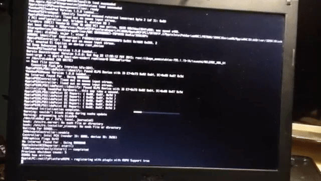

smileyopp Posted December 27, 2015 Share Posted December 27, 2015 Let me share my experiment: Upgrade BIOS from A09 to A16. See http://www.dell.com/support/home/us/en/04/product-support/product/latitude-e5410/drivers Use tool to create OSX Boot USB to install. After booting USB, I found "Still waiting for root device" in the screen. There's 'NO ENTRY' sign in the screen. I realised that there's USB problem. I avoid the problem by disassembled HDD from E5410 to PC. Then, I installed OSX from PC with compatible mainboard (Gigabyte GA H97N WIFI). The installation finished within 15 minutes. Run ##### to complete the final step. Here's the configuration: Bootloaders -> Clover v2.3k r3320 Legacy Boot Mode; Drivers-> Misc->FakeSMC v6.18.1394; Customize->System Definition->Mac Pro6,1 After that, mount EFI partition to adjust drivers. Driver Display: Delete all IntelHDGraphic*.kext in /System/Library/Extensions (This is only for eDP connector). Driver Sound: Voodoo2.8.4.kext + AppleHDADisabler ( See http://www.insanelymac.com/forum/topic/306527-apple-unveils-os-x-1011-el-capitan/page-5) Driver USB: Run MaciASL to check USB device name. I found "EHCI" and "EHC2".Rename device name to match with your system definition. (See http://www.insanelymac.com/forum/topic/306777-guide-usb-fix-el-capitan-1011/) Driver Touchpad: Use RehabmanMerge.zip driver from (http://forum.osxlatitude.com/index.php?/topic/2545-new-touchpad-driver-for-e6520-alps/) Use Clover GUI to set boot arguments: dart=0 kext-dev-mode=1 root-less=0 -v USBBusFix=yes USBBusFix=yes is important for laptop's keyboard to work. sudo touch /System/Library/Extensions/ Once Finished, I disassembled HDD from PC and put back in the laptop. Boot from laptop. Thank you "Ghost Rider" for suggestions and other post's author in reference post above. Since there's no Intel HD CI driver for 10.11.1. Link to comment https://www.insanelymac.com/forum/topic/310068-el-capitan-10111-on-dell-e5410/ Share on other sites More sharing options...
