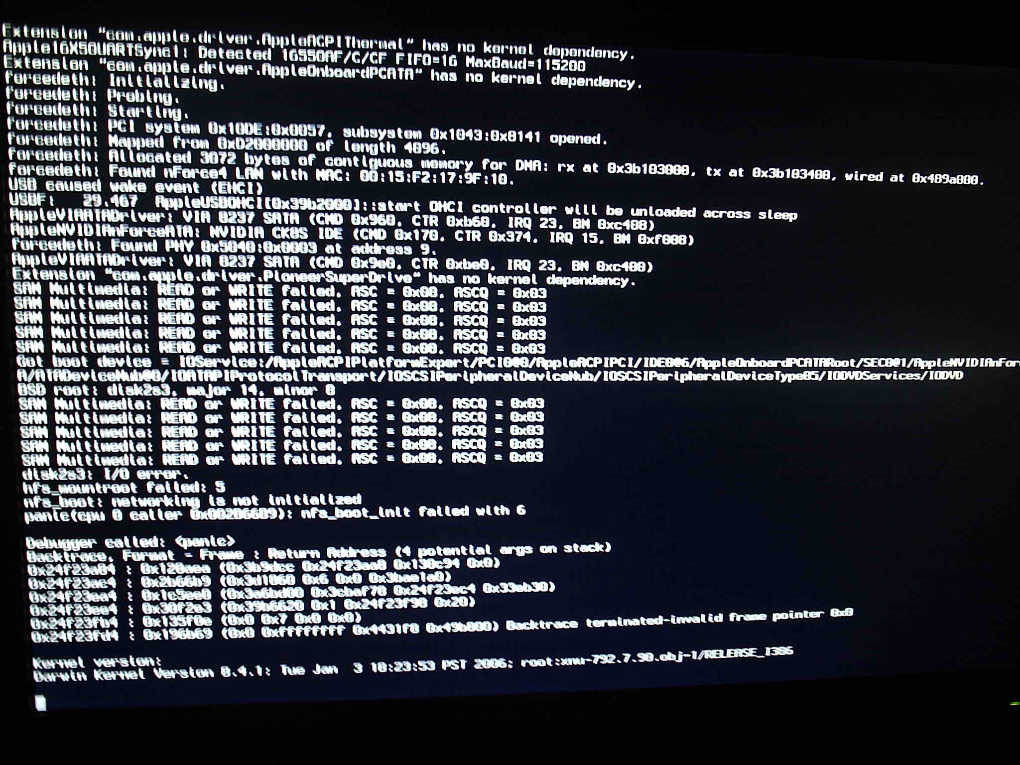

1233666666 Posted October 23, 2006 Share Posted October 23, 2006 Hey All, I just tried to install OSx86 but when I try to boot off the install with -v so I can see the errors, I can see various errors until it panics and stops. It looks like it's related to my Pioneer 111D. I've attached a photo of it, as I can't really copy it. I hope you can see it alright - if you can't, I'll try and type it all. Link to comment Share on other sites More sharing options...
Rammjet Posted October 23, 2006 Share Posted October 23, 2006 SAM Multimedia means that the system is having trouble reading the DVD. You need to reburn the DVD at the slowest speed possible. If available, use a different brand or different type (dvd-r, dvd+r, dvd-rw, dvd+rw) of media. If that fails, then see if you can update the firmware of your optical drive. Link to comment Share on other sites More sharing options...

nekton Posted October 26, 2006 Share Posted October 26, 2006 I have seen this before. Look in your BIOS and see if you have SATA-PATA compatible selected for the bus. If you have only SATA Enhanced selected, it causes problems with PATA DVR-111D drives. Link to comment Share on other sites More sharing options...
