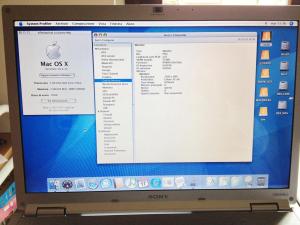

PippoX0 Posted November 17, 2015 Share Posted November 17, 2015 Just for Fun i tried to Install Mac OSX Tiger 10.4.11 on my Sony Sony Vaio VGN-FZ21M Spec Notebook: Sony Vaio VGN-FZ21MGraphics Adapter: NVIDIA GeForce 8400M GT 256 MB -> NO QE/CI - almost for nowDisplay: LCD 15.4 "i WXGA (1280 x 800) X-black CPU: Intel Core 2 Duo T7250 @ 2.00 GHz RAM: 2Gb DDR2 800Mhz Ethernet: MarveL Yukon 88E8036 oK Wifi: Intel Pro 3945 (not working) Audio: .... - to be tested HDD: 320Gb SATA2 – 1,5 Gb transfer rate DVD-RW: Combo DVD-RW/Blu Ray ok Webcam Ricoh - to be tested Sony Trackpad: ok Bluetooth: ok USB 2.0: ok Firewire: ok SD Card reader: - to be tested How To I installed it running /system/installation/packages/osinstall.mpkg inside Mac OSX Tiger 10.4.5 DVD from OSX Lion Then i have updated OSX to 10.4.11 running intel combo update. Then i have installed Chameleon 2.0 - Enoch ver. 2725 and /Extra folder. I'm using only Fakesmc.kext in /Extra PS2 Trackpad and blueTooth works OOB Sleep/Hybernation - to be fixed Now i'm testing stability .... See Ya 1 Link to comment https://www.insanelymac.com/forum/topic/309429-sony-vaio-vgn-fz21m-and-osx-tiger-10411/ Share on other sites More sharing options...
