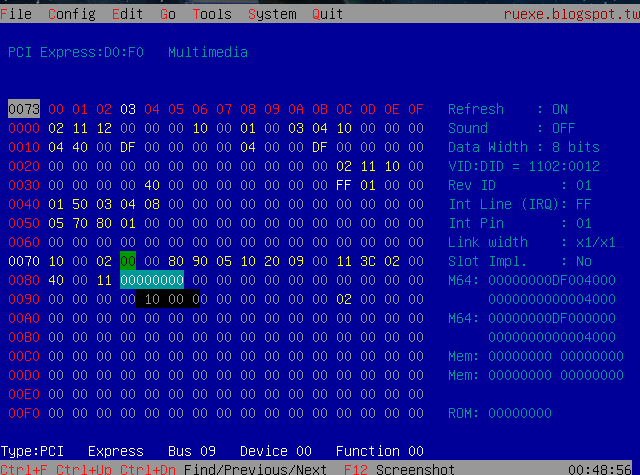

wern apfel Posted March 22, 2020 Author Share Posted March 22, 2020 16 hours ago, Muteb said: thanks for your reply , still no out put and I did try AudioDXE in the Clover menu but when I try it the pc Strat to freeze and not responding . At that point, the SSDT is not yet loaded. If you want, you can try RU.EFI. Select the audio card, change the two values. 30 to 40, 40 to C9 and try again. 1 Link to comment https://www.insanelymac.com/forum/topic/309283-creative-ca0132-g1sniper-m3-patch-for-applehda-or-voodoohda/page/31/#findComment-2713296 Share on other sites More sharing options...
Muteb Posted March 23, 2020 Share Posted March 23, 2020 (edited) 10 hours ago, wern apfel said: At that point, the SSDT is not yet loaded. If you want, you can try RU.EFI. Select the audio card, change the two values. 30 to 40, 40 to C9 and try again. okay I did try it but still no out put , also i have different values check the screen shot that I got. Edited March 23, 2020 by Muteb Link to comment https://www.insanelymac.com/forum/topic/309283-creative-ca0132-g1sniper-m3-patch-for-applehda-or-voodoohda/page/31/#findComment-2713385 Share on other sites More sharing options...
wern apfel Posted March 25, 2020 Author Share Posted March 25, 2020 On 3/23/2020 at 2:05 AM, Muteb said: okay I did try it but still no out put , also i have different values check the screen shot that I got. The other values don't matter. At offset 0x80 is ASPM, RCB. If enabled, it does not freeze. Link to comment https://www.insanelymac.com/forum/topic/309283-creative-ca0132-g1sniper-m3-patch-for-applehda-or-voodoohda/page/31/#findComment-2713749 Share on other sites More sharing options...
