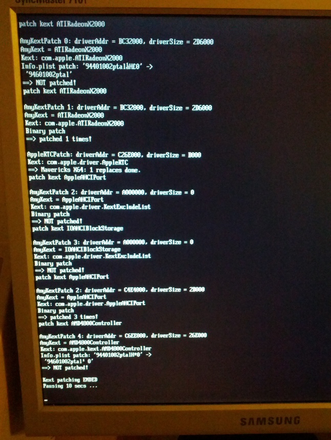

As always after an installation of an OSX I was searching for the suitable QE&CI patch from fantomas (thx to him by the way, always quick and easy), downloaded and installed them with kext utility (to S/L/E). Fixed permissions, rebuilded caches.
But: No hardware acceleration of the video device!

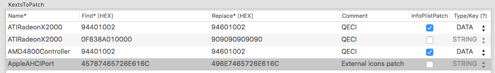

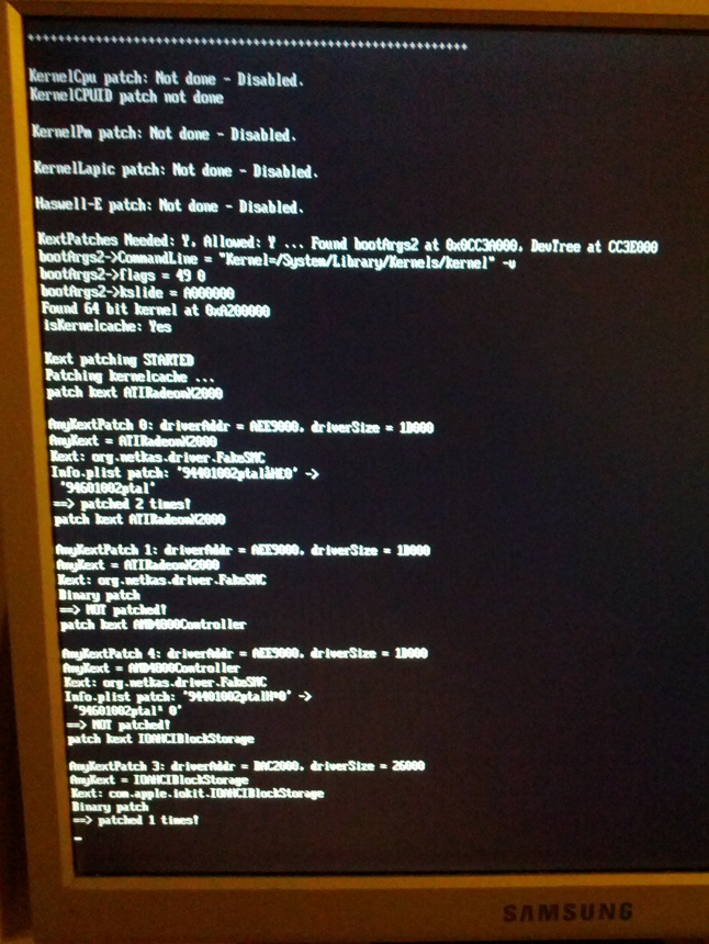

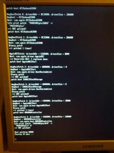

I read through tons of threads, here and elsewere. Tried a lot with FakeID, KextsToPatch, Bootflags and played with Framebuffers for a couple of days. But no success.
Please, would someone take a look at my config and give advice how I should set it up to get QE&CI up and running?

		<key>KextsToPatch</key>
		<array>
			<dict>
				<key>Comment</key>
				<string>External icons patch</string>
				<key>Find</key>
				<data>
				RXh0ZXJuYWw=
				</data>
				<key>Name</key>
				<string>AppleAHCIPort</string>
				<key>Replace</key>
				<data>
				SW50ZXJuYWw=
				</data>
			</dict>
			<dict>
				<key>Find</key>
				<data>
				OTQ0MDEwMDI=
				</data>
				<key>InfoPlistPatch</key>
				<true/>
				<key>Name</key>
				<string>AMD4800Controller</string>
				<key>Replace</key>
				<data>
				OTQ2MDEwMDI=
				</data>
			</dict>
			<dict>
				<key>Find</key>
				<data>
				OTQ0MDEwMDI=
				</data>
				<true/>
				<key>Name</key>
				<string>ATIRadeonX2000</string>
				<key>Replace</key>
				<data>
				OTQ2MDEwMDI=
				</data>
			</dict>
		</array>

Simply applying a replacement of HEX-values in section KextsToPatch of clover doesn't result in loading both kexts but I'm uncertain about the second replacement at the ATIRadeonX2000 entry:
You mentioned to replace the value 0F8394010000 by 909090909090. At other places (like http://www.hackintoshosx.com/files/file/4614-qe-ci-exotic-patch/) you were show to replace the value 0F838A010000 by 909090909090.
What does all these values mean? Which ones are right?
Finally I got the original AMD4800Controller.kext & ATIRadeonX2000.kext loaded by adding your IOKitPersonalities from the link above, adjusting some values like:
  • replace 944a1002 by 94601002 (my HD4890) in both IOPCIMatch sections
  • changing from Cardinal to Motmot
And my config in clover:
But till now the only thing I got is the correct output of my video cards memory amount (former: 5MB, now: 1024MB)
Still no QE&CI

I booted with the mentioned settings, both kexts are still loading and here 2 photos of the starting debug output:
I hope you're able to see where clover tries, and sometimes failed, to patch the Info.plist files but it's the output of the following config.plist:
