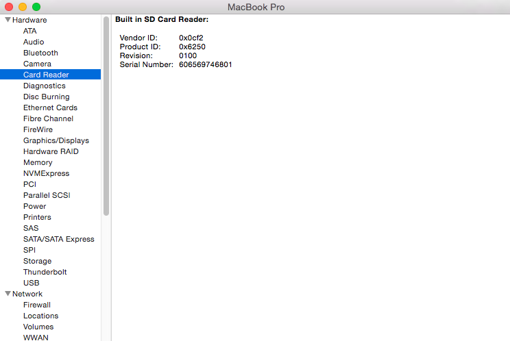

fspinna Posted October 10, 2015 Author Share Posted October 10, 2015 UPDATE: I've done some progress using "AnyCardReader.kext" or "GenericUSBCardReader.kext", changing Vendor and Product ID's with mine. Now Yosemite recognise the Card Reader in System Information (only when I insert an SD in the card reader) but the SD doesn't show up in the Finder or Disk Utility. Now I really run out of ideas! Link to comment https://www.insanelymac.com/forum/topic/308547-ene-sd-card-reader-not-working/#findComment-2175788 Share on other sites More sharing options...
