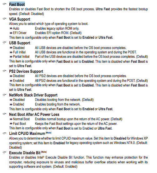

tigersoul Posted August 30, 2015 Share Posted August 30, 2015 I'm trying to speed up my boot which needs a lot of time during the post/bios phase. It's related to my usb devices connected which the bios for some reason has to go over which takes time. Especially keeping an external harddrive connected adds time. Is enabling "fast boot" still a big no no for hackintoshes?? why is that? I have several options regarding this in my bios: Link to comment https://www.insanelymac.com/forum/topic/307857-speeding-up-boot-during-the-postbios-phase-fast-boot-still-a-no-no/ Share on other sites More sharing options...
TheRacerMaster Posted August 30, 2015 Share Posted August 30, 2015 I don't see why Fast Boot would be bad for Hackintoshes, all it does is disable the CSM and only use UEFI and skip some early hardware init. As for external hard drives, those will definitely increase your boot time, as most park their heads during idle (and they have to spin up at boot). You could probably reduce this by using Fast Boot and disabling full USB initialization, but note that this will make it difficult to enter your BIOS with a USB keyboard. Also note that your GPU needs a UEFI VBIOS for Fast Boot to work. 1 Link to comment https://www.insanelymac.com/forum/topic/307857-speeding-up-boot-during-the-postbios-phase-fast-boot-still-a-no-no/#findComment-2164469 Share on other sites More sharing options...

tigersoul Posted September 1, 2015 Author Share Posted September 1, 2015 So I had some time today to check this out. I can report that osx indeed can handle fast boot, although I do want to raise a warning here as I found some minor consequences. Enabling fast boot and setting usb init to partial works fine, there are no consequences what so ever. Setting USB init to disabled/none however causes an unexpected reaction in osx: USB3 devices that are connected during boot will not be recognized as usb3 devices by osx but sits on a 2.0 hub. If you pull them out and replug them, they are correctly handled as USB3 but if they stay in during reboots, shutdowns etc with this setting, they will come back online as 2.0 again. Not going further than setting usb init to partial lets them function as expected at 3.0 speed also efter a reboot/shutdown. The 3.0 device in question is a card reader in my monitor. There may be different results with other types of 3.0 devices. I'm kind of sad I can't set it to usb init disabled, because it saves several second during boot but I'd rather not have to replug the monitors usb cable every time I want to use the card reader. EDIT: correction. I hadn't diagnosed the issue enough. Staying at partial usb init doesn't help. The device stays ok during reboots but NOT during shutdowns and restarts. Then it's back to usb 2.0 speed, so it's not related to fast boot at all it seems and I have no idea why it behaves like this. Maybe bios settings related? Link to comment https://www.insanelymac.com/forum/topic/307857-speeding-up-boot-during-the-postbios-phase-fast-boot-still-a-no-no/#findComment-2164994 Share on other sites More sharing options...
