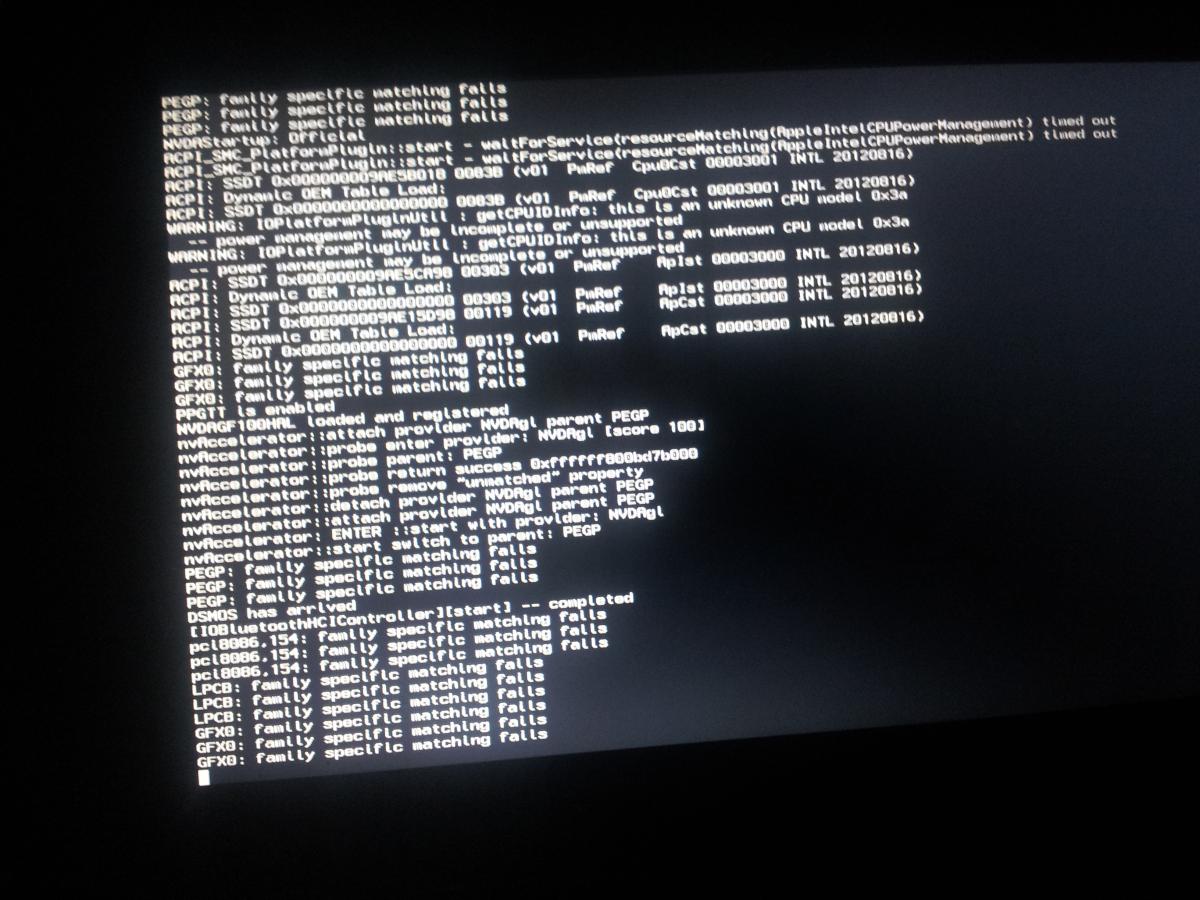

Falk88 Posted August 17, 2015 Author Share Posted August 17, 2015 I finally installed yosemite zone to my pc but i can't boot it, i boot with -v cpus=1 but it freeze. i attached the image to show you the problem. Link to comment https://www.insanelymac.com/forum/topic/307609-installing-yosemite-to-hp-sleekbook-15/#findComment-2161257 Share on other sites More sharing options...

TheRacerMaster Posted August 18, 2015 Share Posted August 18, 2015 Graphics is failing to init, try enabling Intel injection. Link to comment https://www.insanelymac.com/forum/topic/307609-installing-yosemite-to-hp-sleekbook-15/#findComment-2161372 Share on other sites More sharing options...

TheRacerMaster Posted August 18, 2015 Share Posted August 18, 2015 If Yosemite Zone is using Clover, you go to Options in the bootloader screen, select Graphics, and then enable InjectIntel. Not sure what bootloader Yosemite Zone uses. Link to comment https://www.insanelymac.com/forum/topic/307609-installing-yosemite-to-hp-sleekbook-15/#findComment-2161384 Share on other sites More sharing options...
Falk88 Posted August 18, 2015 Author Share Posted August 18, 2015 i think it use chameleon because is the same as the usb key with yosemite zone Link to comment https://www.insanelymac.com/forum/topic/307609-installing-yosemite-to-hp-sleekbook-15/#findComment-2161388 Share on other sites More sharing options...
Falk88 Posted August 20, 2015 Author Share Posted August 20, 2015 i can boot with chameleon because i use the usb key to boot it with yosemite zone. if i start the pc ormally it will boot automatically windows 10. how can i enable intel injection with chameleon? Link to comment https://www.insanelymac.com/forum/topic/307609-installing-yosemite-to-hp-sleekbook-15/#findComment-2162031 Share on other sites More sharing options...
mendietinha Posted August 20, 2015 Share Posted August 20, 2015 GraphicsEnabler=Yes IntelCapriFB=3 or 4. again, i strongly suggest you to lose the distro and read a guide on how to go retail. This is my final contribution on your case. Link to comment https://www.insanelymac.com/forum/topic/307609-installing-yosemite-to-hp-sleekbook-15/#findComment-2162035 Share on other sites More sharing options...
