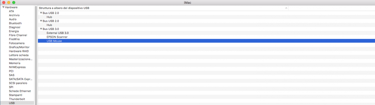

Paologas91 Posted October 4, 2015 Share Posted October 4, 2015 Hey guys, i updated to yosemite and i get 6 of 8 USB ports working .. I have 2 USB 2.0 front (working), 4 USB 2.0 rear (2 working and 2 not working), 2 USB 3.0 rear (working). Then i renamed XHC1 -> XHC , EHC1 -> EH01 and EHC2 -> EH02 and now i have all ports working but i get all usb devices connected in the USB 3.0 tree as in the photo. Am i missing something? Thanks Link to comment Share on other sites More sharing options...
RehabMan Posted October 4, 2015 Share Posted October 4, 2015 Hey guys, i updated to yosemite and i get 6 of 8 USB ports working .. I have 2 USB 2.0 front (working), 4 USB 2.0 rear (2 working and 2 not working), 2 USB 3.0 rear (working). Then i renamed XHC1 -> XHC , EHC1 -> EH01 and EHC2 -> EH02 and now i have all ports working but i get all usb devices connected in the USB 3.0 tree as in the photo. Am i missing something? Thanks Without port routing from XHC to EHC (FakePCIID.kext+FakePCIID_XHCIMux.kext), that is normal. Apple shows all devices connected to XHC as being on "USB 3.0 bus". I guess normal people would be confused by "XHCI". Link to comment Share on other sites More sharing options...
Paologas91 Posted October 4, 2015 Share Posted October 4, 2015 Without port routing from XHC to EHC (FakePCIID.kext+FakePCIID_XHCIMux.kext), that is normal. Apple shows all devices connected to XHC as being on "USB 3.0 bus". I guess normal people would be confused by "XHCI".so i only have to install the 2 kext? Link to comment Share on other sites More sharing options...
