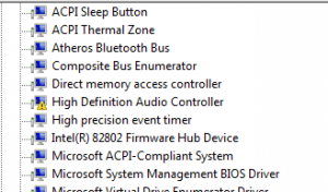

aliraja Posted June 22, 2015 Share Posted June 22, 2015 Hi, I followed ; http://www.insanelymac.com/forum/topic/271573-guide-dell-inspiron-n5110/ and installed YOSIMETE and windows 7 Dual Boot. replaced Dell 1701 card with Dell 1702 Wifi everything is working Perfectly except that in windows I am not getting soundcard working. its sound yellow marked "High Definitation Audio Controller" Did tried many driver from Dell / Intel but none of them are working. help... Ali. Link to comment https://www.insanelymac.com/forum/topic/306774-dell-inspiron-5110-uefi-bios-sound-not-working-in-windows/ Share on other sites More sharing options...
vusun123 Posted June 22, 2015 Share Posted June 22, 2015 That's a known bug, and is related to the modded bios Link to comment https://www.insanelymac.com/forum/topic/306774-dell-inspiron-5110-uefi-bios-sound-not-working-in-windows/#findComment-2147104 Share on other sites More sharing options...

vusun123 Posted June 22, 2015 Share Posted June 22, 2015 Any quick fixes....... You could always flash the original bios, then use Clover legacy 1 Link to comment https://www.insanelymac.com/forum/topic/306774-dell-inspiron-5110-uefi-bios-sound-not-working-in-windows/#findComment-2147122 Share on other sites More sharing options...
