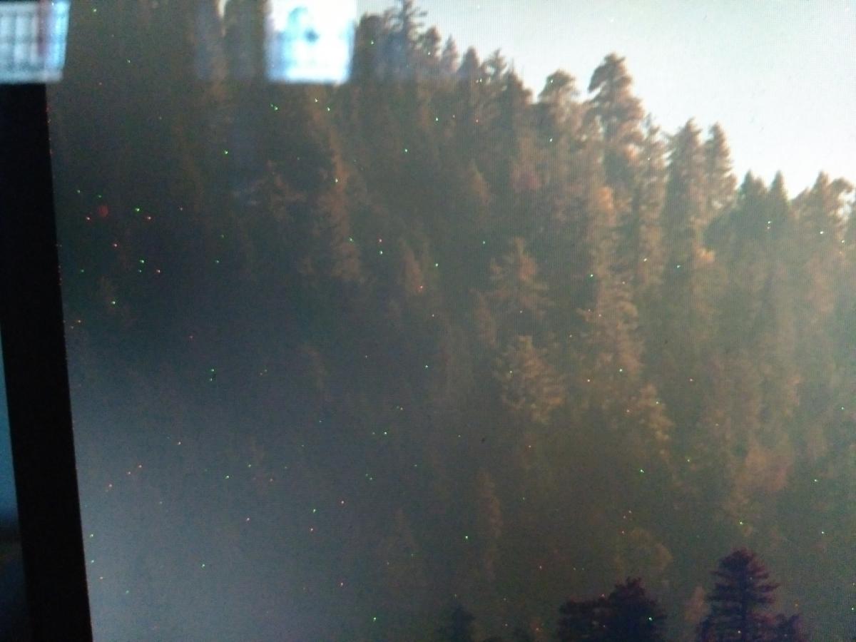

jukno Posted June 21, 2015 Share Posted June 21, 2015 I've been experiencing a peculiar problem on my hackintosh. After graphics kexts are loaded during boot there appears a white noise screen for almost 5 seconds. which goes away but the problem is when everything loaded there is colored static everywhere on the screen. so far tried patching framebuffer using toleda methodbut to no avail. Here is my configuration : i5 4690 Gigabyte H97 D3H WD 1TB 8 GB Kingston Hyperx Ram Yosemite 10.10.3 Link to comment https://www.insanelymac.com/forum/topic/306766-colored-static-distortion-hd-4600-10103/ Share on other sites More sharing options...

jukno Posted June 24, 2015 Author Share Posted June 24, 2015 I added the kext patch now problem is the same as when i use intel framebuffer patch script. Here is the video of the problem it keep son doing this over and over. https://youtu.be/ydF9ArJeO9o But when i use native framebuffer after few seconds of white noise desktop appears but with lots of noise. See attached photo. Link to comment https://www.insanelymac.com/forum/topic/306766-colored-static-distortion-hd-4600-10103/#findComment-2147696 Share on other sites More sharing options...
toleda Posted June 24, 2015 Share Posted June 24, 2015 I added the kext patch now problem is the same as when i use intel framebuffer patch script. Requested attachments not included with reply, not helpful. What HDMI device and what cable? Link to comment https://www.insanelymac.com/forum/topic/306766-colored-static-distortion-hd-4600-10103/#findComment-2147820 Share on other sites More sharing options...
jukno Posted June 24, 2015 Author Share Posted June 24, 2015 Thatsthe problem after patching i cant no longer use desktop thats why cant dump ioreg. I can only use safe mode with -f -F boot flags. I used all the patches one by one. Im using hdmi cable to connect to monitor. Link to comment https://www.insanelymac.com/forum/topic/306766-colored-static-distortion-hd-4600-10103/#findComment-2147908 Share on other sites More sharing options...
toleda Posted June 24, 2015 Share Posted June 24, 2015 Im using hdmi cable to connect to monitor. Really not helpful. Manufacturer and model of both? Link to comment https://www.insanelymac.com/forum/topic/306766-colored-static-distortion-hd-4600-10103/#findComment-2147948 Share on other sites More sharing options...
jukno Posted June 25, 2015 Author Share Posted June 25, 2015 Dell s2240l and stock hdmi cable cable is working fine on windows. Edit : Tried 3 different cables to no avail. Link to comment https://www.insanelymac.com/forum/topic/306766-colored-static-distortion-hd-4600-10103/#findComment-2148069 Share on other sites More sharing options...
jukno Posted June 25, 2015 Author Share Posted June 25, 2015 Success : It turned out HDMI connector on monitor was damaged. Thanks Toleda for sticking out with me. . Looking forward to being a constructive member of this awesome communiy. Link to comment https://www.insanelymac.com/forum/topic/306766-colored-static-distortion-hd-4600-10103/#findComment-2148164 Share on other sites More sharing options...
