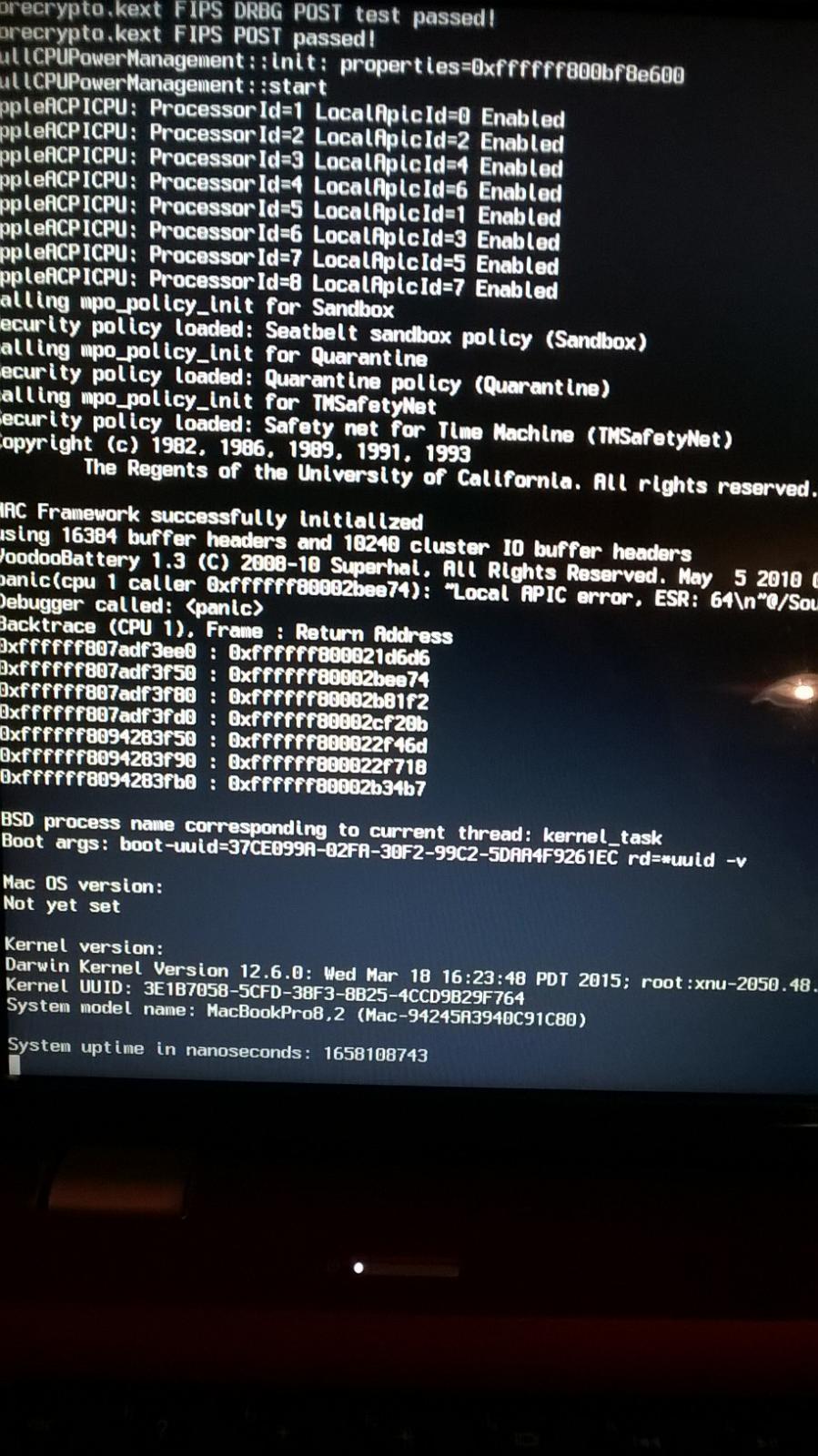

fasullo Posted May 24, 2015 Author Share Posted May 24, 2015 Di male in peggio..... Adesso si blocca nella scritta System uptime milleseconds Link to comment https://www.insanelymac.com/forum/topic/306242-avvio-lento/#findComment-2138339 Share on other sites More sharing options...
carbo178 Posted May 24, 2015 Share Posted May 24, 2015 Foto grazie, altrimenti non si capisce il motivo del panic Link to comment https://www.insanelymac.com/forum/topic/306242-avvio-lento/#findComment-2138342 Share on other sites More sharing options...
fasullo Posted May 25, 2015 Author Share Posted May 25, 2015 Ok spero si capisca Link to comment https://www.insanelymac.com/forum/topic/306242-avvio-lento/#findComment-2138484 Share on other sites More sharing options...
carbo178 Posted May 25, 2015 Share Posted May 25, 2015 Sembra derivare dal lapic, prova ad avviare con cpus=1 Link to comment https://www.insanelymac.com/forum/topic/306242-avvio-lento/#findComment-2138501 Share on other sites More sharing options...

fasullo Posted May 26, 2015 Author Share Posted May 26, 2015 Son riuscito a ripristinare da backup ora parte funziona tutto però devo scrivere cpus=1 P.S. è normale che è più lento? Link to comment https://www.insanelymac.com/forum/topic/306242-avvio-lento/#findComment-2138763 Share on other sites More sharing options...
Fabio1971 Posted May 26, 2015 Share Posted May 26, 2015 Aggiungi il flag in org.chameleon.Boot.plist Fabio Link to comment https://www.insanelymac.com/forum/topic/306242-avvio-lento/#findComment-2138774 Share on other sites More sharing options...
fasullo Posted May 26, 2015 Author Share Posted May 26, 2015 Così? <key>cpus=1</key><string>Yes</string> Ma rimane così lento? Link to comment https://www.insanelymac.com/forum/topic/306242-avvio-lento/#findComment-2138803 Share on other sites More sharing options...
carbo178 Posted May 26, 2015 Share Posted May 26, 2015 Kernel Flagscpus=1 Link to comment https://www.insanelymac.com/forum/topic/306242-avvio-lento/#findComment-2138865 Share on other sites More sharing options...
fasullo Posted May 26, 2015 Author Share Posted May 26, 2015 Ok perfetto. Però prima nn c'era bisogno. Perché adesso si? Link to comment https://www.insanelymac.com/forum/topic/306242-avvio-lento/#findComment-2138948 Share on other sites More sharing options...
