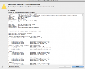

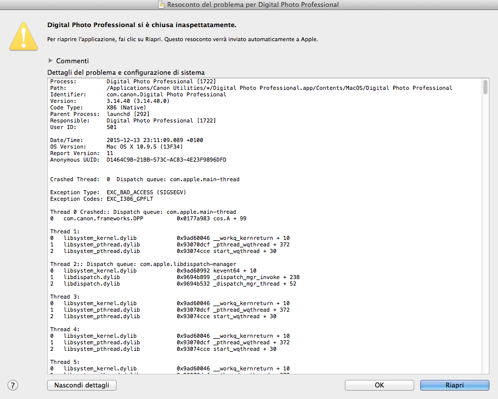

AntonFX Posted December 13, 2015 Share Posted December 13, 2015 I installed 10.9.5 Maverick on this configurationCPU: AMD FX8320MOB: Asrock 970 Extreme 3 rev 2.0RAM: 1x4GB Kingston Hyperx 1600MhzGPU: Asus GT 210 Silent 1GB DDR3The graphics work , but often some programs like Illustrator , Photoshop or Digital Photo Professional ( a Canon software ) , freeze and crash with the related errors that I am attaching . Can anyone tell me if this problem is given by my video card ( Asus GT210 Silent ) , the low amount of RAM , or system ?If the problem is the video card , what video card would you recommend to buy ? Sorry for my bad English ! 1 Link to comment https://www.insanelymac.com/forum/topic/306203-gt210-on-mavericks-109-working-models/#findComment-2196875 Share on other sites More sharing options...
liujianwei Posted January 1, 2017 Share Posted January 1, 2017 I installed 10.9.5 Maverick on this configuration CPU: AMD FX8320 MOB: Asrock 970 Extreme 3 rev 2.0 RAM: 1x4GB Kingston Hyperx 1600Mhz GPU: Asus GT 210 Silent 1GB DDR3 The graphics work , but often some programs like Illustrator , Photoshop or Digital Photo Professional ( a Canon software ) , freeze and crash with the related errors that I am attaching . Can anyone tell me if this problem is given by my video card ( Asus GT210 Silent ) , the low amount of RAM , or system ? If the problem is the video card , what video card would you recommend to buy ? Sorry for my bad English ! maybe asus gt 210 bug,i ordered HIS 6670 iSilence 5 1GB,hope it does not have same problem. Link to comment https://www.insanelymac.com/forum/topic/306203-gt210-on-mavericks-109-working-models/#findComment-2342208 Share on other sites More sharing options...
