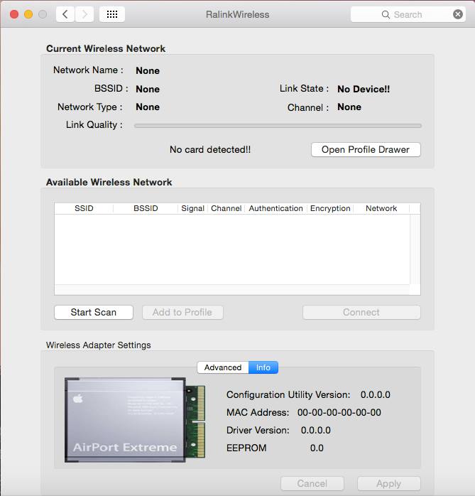

lungkuteo Posted May 15, 2015 Share Posted May 15, 2015 Hello everybody, I can't use usb tenda w311m on yosemite. Please help me install and use it. Thank you very much! Link to comment https://www.insanelymac.com/forum/topic/306170-help-usb-tenda-w311m-on-mac-yosemite/ Share on other sites More sharing options...
nawcom Posted May 20, 2015 Share Posted May 20, 2015 What driver did you install? I did some googling to get the device ID for your Tenda w311m (148f:5370 as far as I know) and this has the Yosemite drivers for it: http://www.mediatek.com/en/downloads/mt7610u/ You can type in a random name and email - it doesn't matter in order to download. Even though it says "MAC OS X version 10.3/10.4/10.5/10.6" I unpacked the pkg and verified that it supports Yosemite and includes the device id for your USB wifi card. Give it a try and see if it does the job. Link to comment https://www.insanelymac.com/forum/topic/306170-help-usb-tenda-w311m-on-mac-yosemite/#findComment-2137309 Share on other sites More sharing options...
