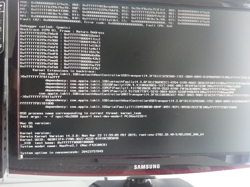

bobenia Posted May 6, 2015 Author Share Posted May 6, 2015 with a great help from Crusher I have installed Yosemite 10.10.3 on my SSD drive. But I can boot only with -v -f -x npci=0x2000 cpus=1 PCIRootUID+1 flag (in safe mode) attached is KP error thanks anyone for help. config: i7-5930 3.50GHz 6 core processor asus x99-a Motherboard Nvidia GeForce GTX 780 strix - 6GB / dual 2 cads / not SLI INTEL SSD 250GBfor OS + 2 harddrives Link to comment https://www.insanelymac.com/forum/topic/305985-yosemite-1010-on-asus-x99-a/#findComment-2133547 Share on other sites More sharing options...
crusher Posted May 7, 2015 Share Posted May 7, 2015 Now disable serial port and work. Use Clover and follow @RampageDev site and work. 1 Link to comment https://www.insanelymac.com/forum/topic/305985-yosemite-1010-on-asus-x99-a/#findComment-2133786 Share on other sites More sharing options...
