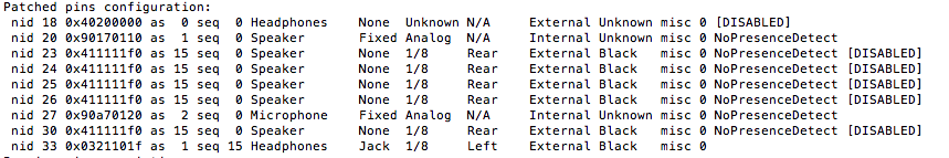

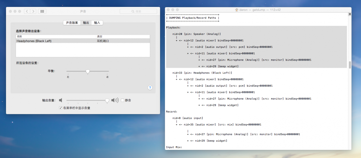

mikeshinoda Posted February 8, 2015 Share Posted February 8, 2015 Hello everyone! By using the latest voodoohda 2.8.7 on my laptop Acer E1-572G ,ALC 282 finally works, but there has no built-in speakers in sound setting,i try using NodesTopatch to add the node in the plist, reinstall it and still in vain,so ,can somebody help me here is the pic and getdump files. dump and plist.zip Link to comment https://www.insanelymac.com/forum/topic/304412-alc282-with-voodoohda287-worksbut-no-built-in-speaker/ Share on other sites More sharing options...
