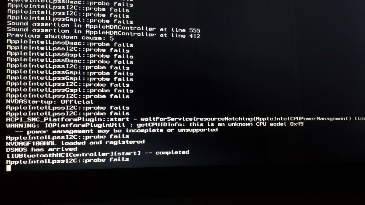

vijai Posted January 25, 2015 Share Posted January 25, 2015 Hello, I tried to install Yosemite hackintosh created with chamelion bootloader on my laptop. I booted with flags from chamelion -v IGPEnabler=Yes IGPlaformID=0a260006 And I get stuck at DSMOS has arrived [IOBluetoothHCIController][start] --completed My system:Asus X550LDCPU: I7 4500UGPU: Nvidia 820MRam: 8Gb 1600MhzAlso tried other boot flags like npci=0x2000 PCIRootUID=0 etc but all ended in kernel panic. How do I solve to boot into installer now? Link to comment https://www.insanelymac.com/forum/topic/304124-asus-x550-haswel-yosemite-boot-problem/ Share on other sites More sharing options...
RehabMan Posted January 25, 2015 Share Posted January 25, 2015 IGPlatformID and IGPEnabler are not valid flags for Chameleon. They are flags for Chimera. Link to comment https://www.insanelymac.com/forum/topic/304124-asus-x550-haswel-yosemite-boot-problem/#findComment-2105583 Share on other sites More sharing options...

vijai Posted January 26, 2015 Author Share Posted January 26, 2015 I now booted with InjectIntel-ig=09006601 IntelAzulFB=9 And its still stuck on the same place. I tried different numbers for AzulFB but others gave me kernel panic Link to comment https://www.insanelymac.com/forum/topic/304124-asus-x550-haswel-yosemite-boot-problem/#findComment-2105805 Share on other sites More sharing options...
RehabMan Posted January 26, 2015 Share Posted January 26, 2015 I now booted with InjectIntel-ig=09006601 IntelAzulFB=9 And its still stuck on the same place. I tried different numbers for AzulFB but others gave me kernel panic Your signature contains no details on your hardware. So... no idea for you. The value you need for ig-platform-id depends on your graphics chip and your screen resolution. Note that the flags you're using don't make much sense. First, InjectIntel-ig will override whatever you provide for IntelAzulFB. And 01660009 is for Ivy(HD4000), whereas IntelAzulFB is for Haswell(HD4200/HD4400/HD4600/HD5000+). Link to comment https://www.insanelymac.com/forum/topic/304124-asus-x550-haswel-yosemite-boot-problem/#findComment-2105832 Share on other sites More sharing options...
vijai Posted January 27, 2015 Author Share Posted January 27, 2015 Updated my signature. So since mine is haswell, what flags should I use? Link to comment https://www.insanelymac.com/forum/topic/304124-asus-x550-haswel-yosemite-boot-problem/#findComment-2106065 Share on other sites More sharing options...
RehabMan Posted January 27, 2015 Share Posted January 27, 2015 Updated my signature. So since mine is haswell, what flags should I use? It varies with the specific laptop but 0xa260006 works most of the time. IntelAzulFB=12 GraphicsEnabler=Yes SkipNvidiaGfx=Yes nv_disable=1 dart=0 IntelAzulFB=12 is 0xa260006. More here: http://www.insanelymac.com/forum/topic/288241-intel-hd4000-and-haswell-inject-aaplig-platform-id/ Link to comment https://www.insanelymac.com/forum/topic/304124-asus-x550-haswel-yosemite-boot-problem/#findComment-2106103 Share on other sites More sharing options...
vijai Posted January 27, 2015 Author Share Posted January 27, 2015 Thank you! It booted up with IntelAzulFB=12 nv_disable=1. I copied xpcm patched kernel and also booted and while in setup screen, I dont have wifi, touch pad doesnt work and while trying to set up ethernet (Chose DHCP automatic), The set up wizard crashes and goes back to language screen. How do I fix these? Link to comment https://www.insanelymac.com/forum/topic/304124-asus-x550-haswel-yosemite-boot-problem/#findComment-2106108 Share on other sites More sharing options...
