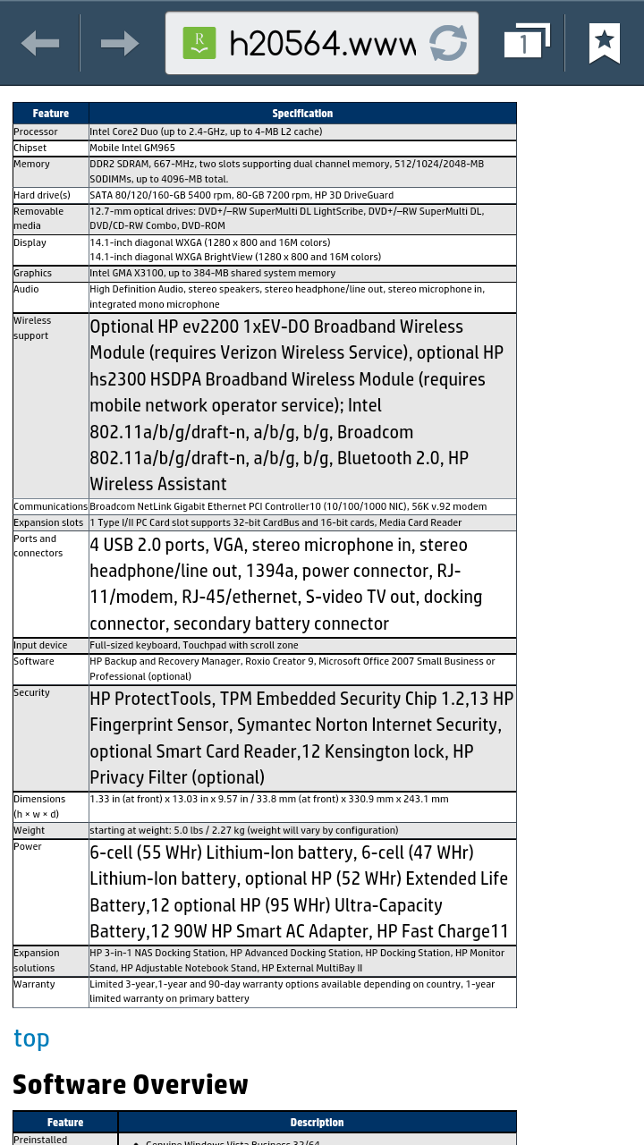

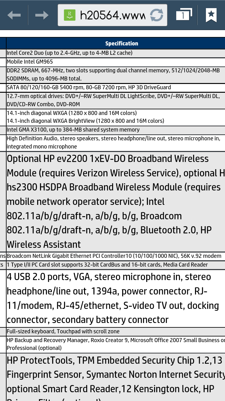

Rosario98 5 Posted January 26, 2015 Author Share Posted January 26, 2015 Ecco Scusate se ne invio un altro ma il primo non si vede molto bene Link to post Share on other sites
marco.pisellonio80 302 Posted January 26, 2015 Share Posted January 26, 2015 per lan e wifi scarica hackintosh vietnam dal sito e installa le kext come da immagine allegata. ripara permessi e cache da kext wizard e riavvia. Per l'audio non sono riuscito a risalire al tuo codec audio. Se vuoi una soluzione dignitosa, installa, sempre da hackintosh vietnam il voodoHDA (uno dei due, magari il più recente), dovrebbe andare. Altrimenti risaliamo al tuo codec audio e vediamo se è supportato. Senza titolo.tiff Link to post Share on other sites

Rosario98 5 Posted January 27, 2015 Author Share Posted January 27, 2015 può essere broadcom ? Link to post Share on other sites
Fabio1971 2,792 Posted January 27, 2015 Share Posted January 27, 2015 può essere broadcom ?Devi essere sicuroHai fatto DarwinDumper Fabio Link to post Share on other sites
Rosario98 5 Posted January 27, 2015 Author Share Posted January 27, 2015 http://www.filedropper.com/darwindumper297chameleon20ia32lionrosario ecco a te spero di aver fatto bene Link to post Share on other sites
Fabio1971 2,792 Posted January 28, 2015 Share Posted January 28, 2015 Ecco a te : LAN : Broadcom Corporation NetLink BCM5787M Gigabit Ethernet PCI Express [14e4:1693] Wifi : Broadcom Corporation BCM4311 802.11a/b/g [14e4:4312] Fabio Link to post Share on other sites
Rosario98 5 Posted January 28, 2015 Author Share Posted January 28, 2015 Dove li posso reperire? Link to post Share on other sites
Fabio1971 2,792 Posted January 28, 2015 Share Posted January 28, 2015 LAN : http://www.insanelymac.com/forum/topic/247470-bcm5722-bcm5754m-bcm5755m-bcm5787m-and-bcm5906m-nic-driver-3264-bit/ Wifi : http://www.insanelymac.com/forum/topic/51725-broadcom-bcm43xx-wireless-driver-beta/ Fabio Link to post Share on other sites
