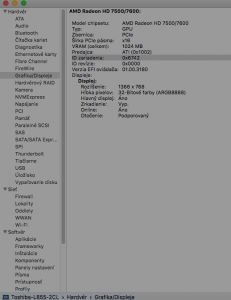

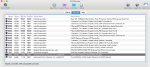

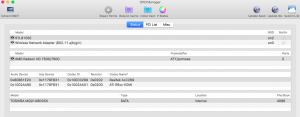

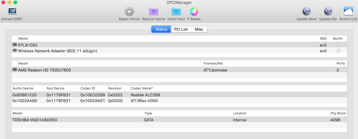

gundatib Posted August 20, 2017 Share Posted August 20, 2017 Ipomoea works almost 100 percent - LVDS , HDMI. After five days of experimenting with Cattail I modified the framebuffer patch with my data and it goes. Note for rampagedev - now I have finished the second Toshiba Satellite and both have integrated Intel HD graphics, one has external graphics from Nvidia GeForce and the other Toshiba Satellite L855-2CL has just ATI Radeon 6742 DeviceId 0x67421002. Toshiba-L855-2CL.ioreg.zip Quote Link to comment https://www.insanelymac.com/forum/topic/303044-enable-qeci-from-ati-radeon-hd-7500m-7600m-series/#findComment-2482010 Share on other sites More sharing options...
