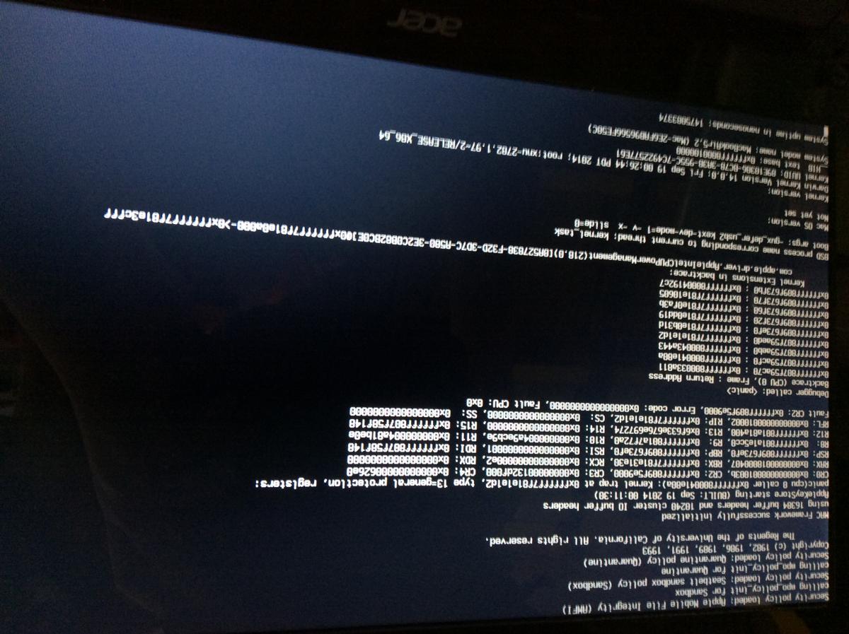

melvinliew1999 Posted November 25, 2014 Share Posted November 25, 2014 My touchpad driver seem can't install into my OS X Yosemite (using Clover boot loader) Elan Touchpad,my driver get from EmilyDinesh. First, I tried using the latest beta v4 1.8.2 ,and I follow the installation steps. After finish install the kext,I reboot my laptop. It seem like auto reboot over many times . No matter I use save mode ,It still auto reboot. I did tried boot without kext ,seem like stuck in somewhere. It just can't boot.I think the system is in kernel panic. After that, I reinstall the os . Then I tried install using v4 Final. Same thing still happened .Auto reboot.... So I reinstall and tried v3.3 and v3.8.5 final . Still the same .... (P.S. I am new in this mackintosh thing,so sorry about that) I tried to enter safe mode And enter without cache and without kext to see what is the problem. It just kernel panic. And I cant fix this problem. I have a picture about my kernel panic. Please help,Thank you My PC specs Acer Aspire E1-471 Intel 2nd Generation I3 Intel HD3000 Wlan Artheros 9285 No Bluetooth Realtek HD audio Keyboard working but not the trackpad. USB mouse working Sleep mode working Link to comment https://www.insanelymac.com/forum/topic/302893-elan-touchpad-osx-yosemite-kernal-panic-help/ Share on other sites More sharing options...
jamiethemorris Posted November 28, 2014 Share Posted November 28, 2014 The kernel panic in the screenshot has nothing to do with the touch pad kext. AppleIntelCPUPowerManagement is causing it because your bios has a locked msr. Enabling the Asus PM patch in Clover should fix the problem. Do you have that enabled? Link to comment https://www.insanelymac.com/forum/topic/302893-elan-touchpad-osx-yosemite-kernal-panic-help/#findComment-2090006 Share on other sites More sharing options...
