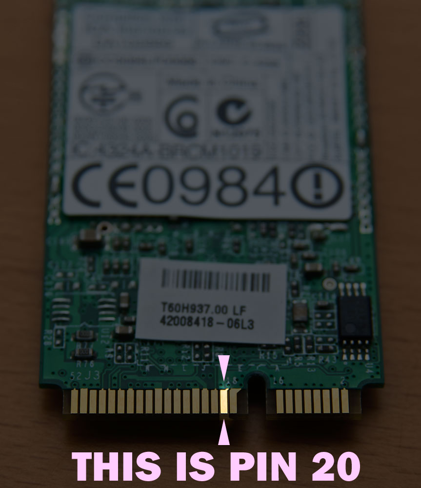

Novar Posted October 29, 2014 Author Share Posted October 29, 2014 I've solved this problem! We need to disable pin 20 on wi-fi/bt card!! (for example: cover with adhesive tape) (saw this solution on some forum, a don't remeber, but really THANKS to author) Link to comment https://www.insanelymac.com/forum/topic/302101-ar5b195-working-by-half/#findComment-2078011 Share on other sites More sharing options...
