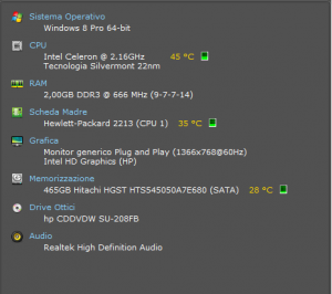

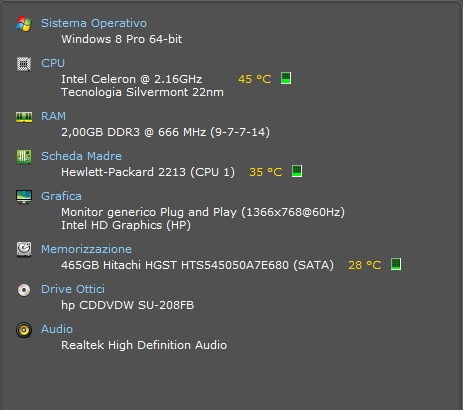

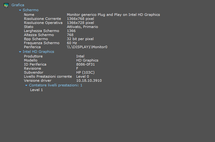

emanur9 Posted October 24, 2014 Share Posted October 24, 2014 Hi, thank you all for this wonderful forum. I have a problem. I installed perfectly Lion 10.7. Everything works properly. I can not install the hardware of my pc. I've tried using the sound card driver but once installed with kext wizard but it does not detect anything. I can not even install the drivers for the wireless card. The drivers are the ones that I would like to install the video card, audio and wirelless. I also installed the updates manually. My periferichi are. Video Card: Intel HD Graphics Sound Card: Realtek High Definition Audio (I downloaded and installed drivers in the system info but I find this item: Audio not incorporated). wi-fi card: Ralink RT3290 802.11bgn Wi-Fi Adapter (In System Preferences -> network can not find just the wifi). I also note that the speed is not very fluid depends on what? May depend on the motherboard drivers or bios). I'm new in this world please have patience. Thanks to all Quote Link to comment https://www.insanelymac.com/forum/topic/301912-problem-driver-hp-250-g3/ Share on other sites More sharing options...

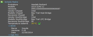

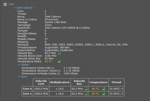

Pimentel Posted October 24, 2014 Share Posted October 24, 2014 Hello Welcome Give me more infos about your hardware: CPU mode/ Mobo / What Intel HDD Graphic model? What bootloader you used to post-installation? Quote Link to comment https://www.insanelymac.com/forum/topic/301912-problem-driver-hp-250-g3/#findComment-2075181 Share on other sites More sharing options...

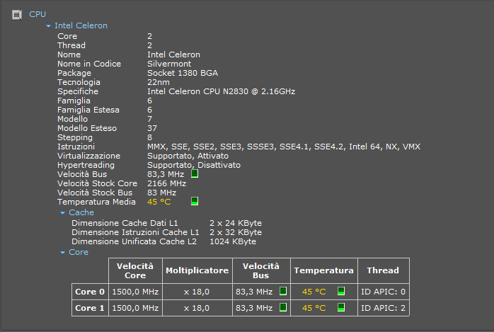

emanur9 Posted October 24, 2014 Author Share Posted October 24, 2014 hello, thanks for your reply. I installed Lion on VMware. After installation I can start it directly with a bootloader without having to switch from Windows? Send screen shot of the hardware. Hello and thanks Quote Link to comment https://www.insanelymac.com/forum/topic/301912-problem-driver-hp-250-g3/#findComment-2075229 Share on other sites More sharing options...
Pimentel Posted October 24, 2014 Share Posted October 24, 2014 Hello Forget VM, install in HDD. You can make dual-boot with Windows+OSX with Windows already installed in this HDD, but is very boring configure OSX to run in MBR table(table of windows is already installed), many problems before and after installarion can happen... The best thing that you can make is format your HDD and try make dual boot OSX+Windows in Hybrid-MBR.... or you can try just only install OSX in HDD and emulate Windows on it using Paralles Desktop. This graphic doesn't have native support, follow this guide: http://www.insanelymac.com/forum/topic/286092-guide-1st-generation-intel-hd-graphics-qeci/ 1 Quote Link to comment https://www.insanelymac.com/forum/topic/301912-problem-driver-hp-250-g3/#findComment-2075263 Share on other sites More sharing options...

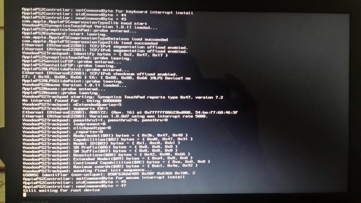

emanur9 Posted November 3, 2014 Author Share Posted November 3, 2014 Hello everyone. I am installing The OS on another pc. After a few minutes from The installation appears a symbol of phohibition. I tried different flags but nothing. Post a picture. The pc is a Toshiba satellite c50. Salut Quote Link to comment https://www.insanelymac.com/forum/topic/301912-problem-driver-hp-250-g3/#findComment-2080812 Share on other sites More sharing options...
