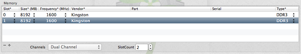

Haravikk Posted October 17, 2014 Share Posted October 17, 2014 Okay, so I've created myself a little Hack Mini, using SMBIOS settings to mimic a Macmini6,2 using Clover Configurator's wizard to fill in the details. Only problem I'm having is that the OS doesn't recognise my RAM very well; it knows there is 16gb total, but at best I can only seem to get it to recognise one 8gb module, not both of them (it shows the other slot as empty). Here's a quick screen grab of my Clover Configurator memory set-up: Do I need to add part/serial numbers for OS X to recognise both modules? Any guidelines on what I should enter, or does it simply need to be unique? Any way to get the correct values? Link to comment https://www.insanelymac.com/forum/topic/301566-costmetic-system-not-recognising-ram-correctly/ Share on other sites More sharing options...
Maniac10 Posted October 17, 2014 Share Posted October 17, 2014 Can you upload a boot.log to see how Clover detects your RAM? 1 Link to comment https://www.insanelymac.com/forum/topic/301566-costmetic-system-not-recognising-ram-correctly/#findComment-2070667 Share on other sites More sharing options...
Haravikk Posted October 18, 2014 Author Share Posted October 18, 2014 Sure, I've attached the full log, but in looking at it myself I noticed this part: 0:591 0:001 Scanning SMBus [8086:8C22], mmio: 0xF7C39004, ioport: 0xF040, hostc: 0x11 0:608 0:017 SPD[0]: Type 11 @0x50 0:618 0:010 DDR speed 1600MHz 0:620 0:001 Slot: 0 Type 24 8192MB 1600MHz Vendor=Kingston PartNo=KHX1600C9S3L8G SerialNo=050E02090D0F0606 0:642 0:021 SPD[2]: Type 11 @0x52 0:652 0:010 DDR speed 1600MHz 0:653 0:001 Slot: 2 Type 24 8192MB 1600MHz Vendor=Kingston PartNo=KHX1600C9S3L8G SerialNo=060002090E0B0606 bootlog.log.txt Link to comment https://www.insanelymac.com/forum/topic/301566-costmetic-system-not-recognising-ram-correctly/#findComment-2071363 Share on other sites More sharing options...
Maniac10 Posted October 18, 2014 Share Posted October 18, 2014 Something seems off… Here it counts 4 slots; 2 modules and 2 empty: 0:100 0:000 Total Memory Slots Count = 40:100 0:000 Type 17 Index = 0 0:100 0:000 Ignoring insane frequency value 0MHz 0:100 0:000 SmbiosTable.Type17->Speed = 0 0:100 0:000 SmbiosTable.Type17->Size = 0 0:100 0:000 Type 17 Index = 1 0:100 0:000 SmbiosTable.Type17->Speed = 1600 0:100 0:000 SmbiosTable.Type17->Size = 8192 0:100 0:000 Type 17 Index = 2 0:100 0:000 Ignoring insane frequency value 0MHz 0:100 0:000 SmbiosTable.Type17->Speed = 0 0:100 0:000 SmbiosTable.Type17->Size = 0 0:100 0:000 Type 17 Index = 3 0:100 0:000 SmbiosTable.Type17->Speed = 1600 0:100 0:000 SmbiosTable.Type17->Size = 8192 Then as you noticed, it lists the 2 existing modules with proper information: 0:587 0:001 ScanSPD() start 0:589 0:001 SMBus CmdReg: 0x3 0:591 0:001 Scanning SMBus [8086:8C22], mmio: 0xF7C39004, ioport: 0xF040, hostc: 0x11 0:608 0:017 SPD[0]: Type 11 @0x50 0:618 0:010 DDR speed 1600MHz 0:620 0:001 Slot: 0 Type 24 8192MB 1600MHz Vendor=Kingston PartNo=KHX1600C9S3L8G SerialNo=050E02090D0F0606 0:642 0:021 SPD[2]: Type 11 @0x52 0:652 0:010 DDR speed 1600MHz 0:653 0:001 Slot: 2 Type 24 8192MB 1600MHz Vendor=Kingston PartNo=KHX1600C9S3L8G SerialNo=060002090E0B0606 0:782 0:128 ScanSPD() end But in the end, while creating the SMBIOS it counts 3: 5:655 0:002 Injecting user memory modules to SMBIOS 5:657 0:001 Channels: 2 5:659 0:001 Interleave: 0 2 1 3 4 6 5 7 8 10 9 11 12 14 13 15 16 18 17 19 20 22 21 23 5:702 0:043 BANK0 DIMM0 1600MHz 8192MB 5:703 0:001 mTotalSystemMemory = 8192 5:706 0:003 BANK1 DIMM0 1600MHz 8192MB 5:708 0:001 mTotalSystemMemory = 16384 5:710 0:001 BANK0 DIMM1 EMPTY 5:711 0:001 NumberOfMemoryDevices = 3 So first try with a clean config without injecting memory data and upload the boot.log again please. Then we’ll see if it’s a Clover or config issue. That being said, “SlotCount” should be 4 (notice it says slots, not modules) and in the second module’s entry the slot number should be 2 instead of 1. EDIT: you could also try to change the “Trust” variable to false. There you’ll find more information about memory injection. 1 Link to comment https://www.insanelymac.com/forum/topic/301566-costmetic-system-not-recognising-ram-correctly/#findComment-2071391 Share on other sites More sharing options...
