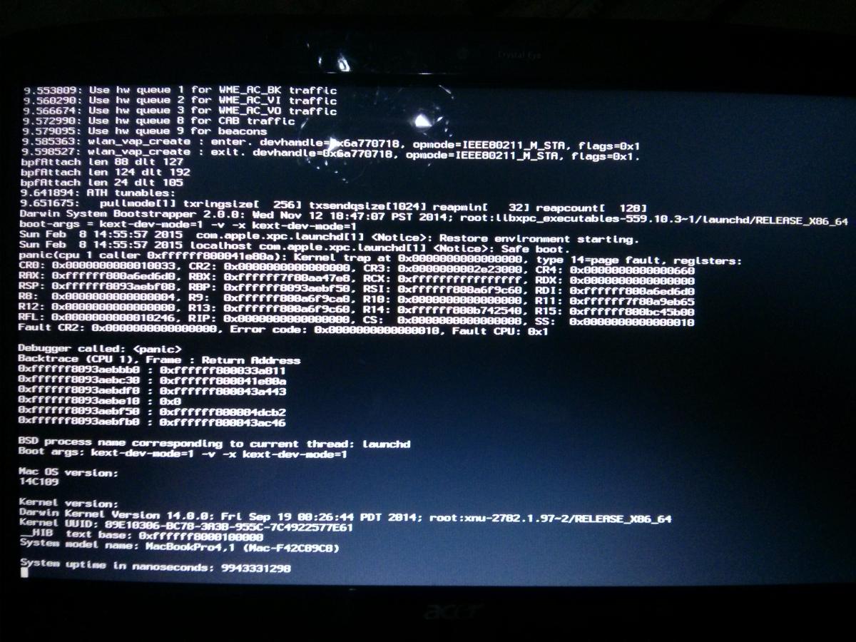

iakughan Posted February 8, 2015 Author Share Posted February 8, 2015 Ecco cosa dice con -v -x Link to comment https://www.insanelymac.com/forum/topic/301373-aiuto-os-x-su-acer-5738zg/page/2/#findComment-2109931 Share on other sites More sharing options...
carbo178 Posted February 8, 2015 Share Posted February 8, 2015 Non capisco, rinomina l'estensione di nullcpupowermanagement da kext a bak, flagga UsbBusFix, p-states e c-states nel plist. Smbios metti MacBookPro 5,1. Avvia con-v Link to comment https://www.insanelymac.com/forum/topic/301373-aiuto-os-x-su-acer-5738zg/page/2/#findComment-2109947 Share on other sites More sharing options...
