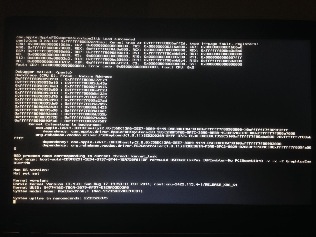

-gabri- Posted October 4, 2014 Share Posted October 4, 2014 Hello everyone i have a problem with my lenovo g580, i installed mavericks with no problem, but i can't access to the system, when i try to boot with any flags i got this panic related to: com.apple.iokit.IOHIDFamily(2.0.0) org.rehabman.voodo.driver.PS2Controller(1.8.11) I think the cause is the keyboard but is a notebook i can't remove it... the flags that i've tried are: -v -f -x PCIRootUID=0 GraphicsEnabler=No IGPEnabler=No USBBusFix=Yes How can i solve this problem? thank you Link to comment https://www.insanelymac.com/forum/topic/301286-panic-on-lenovo-g580-notebook/ Share on other sites More sharing options...

RehabMan Posted October 4, 2014 Share Posted October 4, 2014 ... org.rehabman.voodo.driver.PS2Controller(1.8.11) Old version -- not appropriate for Mavericks. https://github.com/RehabMan/OS-X-Voodoo-PS2-Controller Link to comment https://www.insanelymac.com/forum/topic/301286-panic-on-lenovo-g580-notebook/#findComment-2066261 Share on other sites More sharing options...
