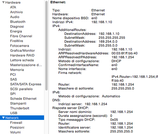

cmalvi Posted September 14, 2014 Author Share Posted September 14, 2014 SMBIOS ho impostato ora quello che mi hai detto tu prima era su 11,3 pero non so come impostare l ethernet tu en0 Link to comment https://www.insanelymac.com/forum/topic/300760-risolto-installare-mavericks-senza-mac-o-hackintosh/page/2/#findComment-2060653 Share on other sites More sharing options...
carbo178 Posted September 14, 2014 Share Posted September 14, 2014 Apri il terminale, digita: sudo -s cp -R ~/Desktop/NetworkInterfaces.plist /Library/Preferences/SystemConfiguration/chown root:wheel /Library/Preferences/SystemConfiguration/NetworkInterfaces.plistchmod 644 /Library/Preferences/SystemConfiguration/NetworkInterfaces.plistreboot Ovviamente devi disconnettere il wifi e avviare con il cavo Ethernet connesso Verifica l'impostazione della Ethernet in Informazioni su questo mac-più informazioni-resoconto di sistema Link to comment https://www.insanelymac.com/forum/topic/300760-risolto-installare-mavericks-senza-mac-o-hackintosh/page/2/#findComment-2060658 Share on other sites More sharing options...

cmalvi Posted September 15, 2014 Author Share Posted September 15, 2014 Mi sembra di aver capito di si. Ho provato ora ma mi sono accorto che non vede la scheda di rete, quale kext devo usare? Link to comment https://www.insanelymac.com/forum/topic/300760-risolto-installare-mavericks-senza-mac-o-hackintosh/page/2/#findComment-2060767 Share on other sites More sharing options...
carbo178 Posted September 15, 2014 Share Posted September 15, 2014 Metti questo in alegato al topic in link http://www.insanelymac.com/forum/topic/284121-problema-rete-ethernet-realtek-8112l/?p=1864751 oppure prova qui: http://www.hackintoshosx.com/files/file/1243-realtek-ethernet-1061071081091010-25042013/ Link to comment https://www.insanelymac.com/forum/topic/300760-risolto-installare-mavericks-senza-mac-o-hackintosh/page/2/#findComment-2060769 Share on other sites More sharing options...
cmalvi Posted September 15, 2014 Author Share Posted September 15, 2014 Ho risolto grazie lo stesso ora provo la procedura EDIT: Funziona tutto tranne iMessage che mi dice di contattare l'assistenza Apple fornendomi un numero EDIT 2: Posso fare gli aggiornamenti di sistema senza problemi? Link to comment https://www.insanelymac.com/forum/topic/300760-risolto-installare-mavericks-senza-mac-o-hackintosh/page/2/#findComment-2060773 Share on other sites More sharing options...
