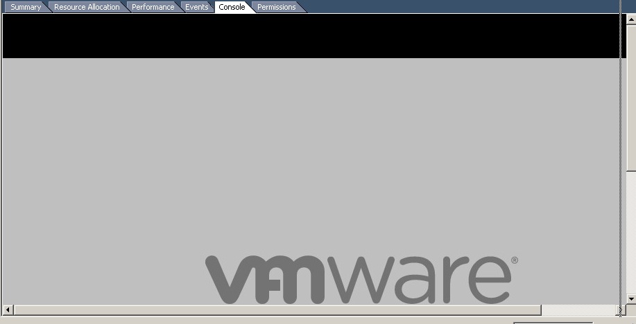

fisherwei Posted September 6, 2014 Share Posted September 6, 2014 Hello, I unlocked my esxi by unlocker 1.3, and created a os x VM, and also installed 10.9.4 successfully. I can boot in OS X with passthrough other PCI-e devices(PCI-E x1 USB 3.0 extend), excluding GPU. My GPU is Asus HD6850, I tried to passthrough it into a Windows VM, it is OK for booting, I can look a device in WIndows Device manager(but I didn't try to install driver). It seems my GPU can be passthrough OK, but after adding GPU into OS X VM, then VM cannot be booted, it will stop at the first screen(refer to attachment). en....... How to resolve this issue? ESXi 5.5 update 1 VM hardware version is 8 (I also try to use vmware workstation upgrading to 10, but no effect) Sorry, I resolved it. I forgot add pciHole.start = "1200" pciHole.end = "2200" into vmx. Link to comment https://www.insanelymac.com/forum/topic/300720-esxi-vm-booting-stop-at-vmware-screen-if-passthrough-gpu/ Share on other sites More sharing options...
