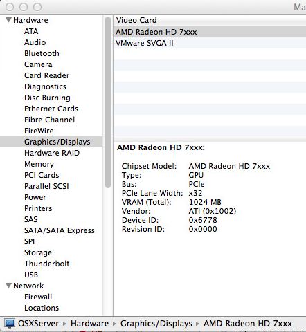

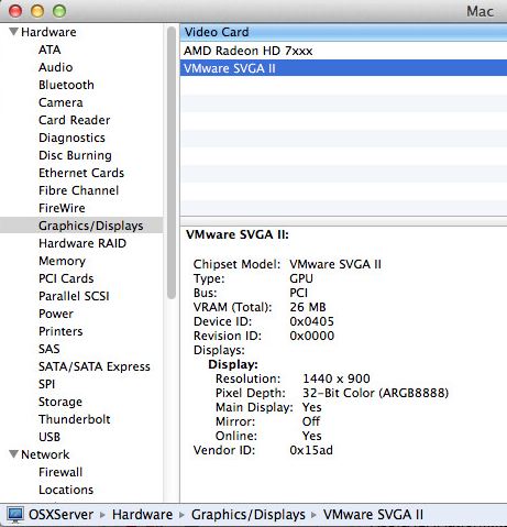

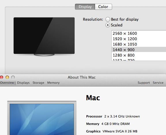

TriMe Posted July 31, 2014 Share Posted July 31, 2014 I installed a Mavericks VM on my HP ML110 G7 server running ESXi 5.5. I also installed a Radeon HD 7470 graphics card and enabled VT-d passthrough to the OSX VM. After adding my device ID (0x67781002) to the plist.info files inside the following kexts: /S/L/E/AMD7000Controller.kext /S/L/E/AMDRadeonX4000.kext I rebuilt the permissions, rebuilt the cache and restarted the OS. The graphics card is showing up in the system information but the display isn't working. Only the VMWARE SVGA is showing in Preferences/Display properties I ran " kextstat | grep AMD " from the terminal, and the following 4 AMD kexts were loaded: Anyone have any suggestions? I tried both ports on my Graphics card (Display port and DVI) - no luck. T. Link to comment https://www.insanelymac.com/forum/topic/299954-mavericks-1094-on-esxi-55-ati-radeon-hd-7470-vt-d-passthrough-help/ Share on other sites More sharing options...
