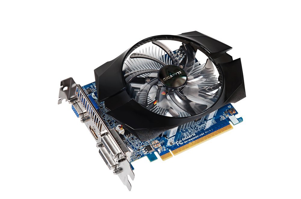

carbo178 Posted July 30, 2014 Share Posted July 30, 2014 La mia è una Gigabyte, ha le stesse caratteristiche della Asus che saresti intenzionato a prendere e costa circa 100-120€ Link to comment https://www.insanelymac.com/forum/topic/299925-questi-componenti-funzioneranno-con-yosemite/#findComment-2046453 Share on other sites More sharing options...
BlackMagick Posted July 30, 2014 Author Share Posted July 30, 2014 Questa: Gigabyte GeForce GTX 650 2GB OC ?? L'ho trovata su amazon a 114,14€. Se mi confermi che la riconosce nativamente o senza troppi problemi, la prendo. Grazie Link to comment https://www.insanelymac.com/forum/topic/299925-questi-componenti-funzioneranno-con-yosemite/#findComment-2046481 Share on other sites More sharing options...
carbo178 Posted July 30, 2014 Share Posted July 30, 2014 E' lei (ne ho 2, una per me e una per mio figlio) Link to comment https://www.insanelymac.com/forum/topic/299925-questi-componenti-funzioneranno-con-yosemite/#findComment-2046488 Share on other sites More sharing options...
BlackMagick Posted July 30, 2014 Author Share Posted July 30, 2014 Quindi la vede nativamente anche yosemite? Link to comment https://www.insanelymac.com/forum/topic/299925-questi-componenti-funzioneranno-con-yosemite/#findComment-2046593 Share on other sites More sharing options...
carbo178 Posted July 30, 2014 Share Posted July 30, 2014 Sicuro, sto scrivendo dalla beta1 Link to comment https://www.insanelymac.com/forum/topic/299925-questi-componenti-funzioneranno-con-yosemite/#findComment-2046595 Share on other sites More sharing options...
BlackMagick Posted July 30, 2014 Author Share Posted July 30, 2014 Ok, la prendo. Come prestazioni è ancora una buona scheda giusto? Link to comment https://www.insanelymac.com/forum/topic/299925-questi-componenti-funzioneranno-con-yosemite/#findComment-2046608 Share on other sites More sharing options...
carbo178 Posted July 30, 2014 Share Posted July 30, 2014 Certo, dipende comunque da cosa devi farci, ma se fai video editing abbastanza elaborato o rendering 3D di progetti in CAD devi orientarti su una scheda di fascia alta, questa che ho io è di fascia media, e riesce a fare queste cose ma con molta calma Link to comment https://www.insanelymac.com/forum/topic/299925-questi-componenti-funzioneranno-con-yosemite/#findComment-2046611 Share on other sites More sharing options...
