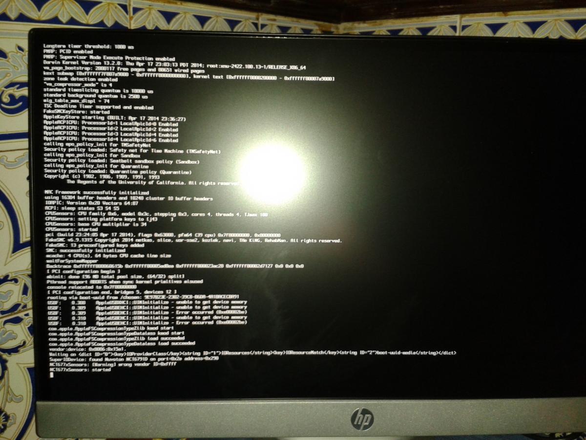

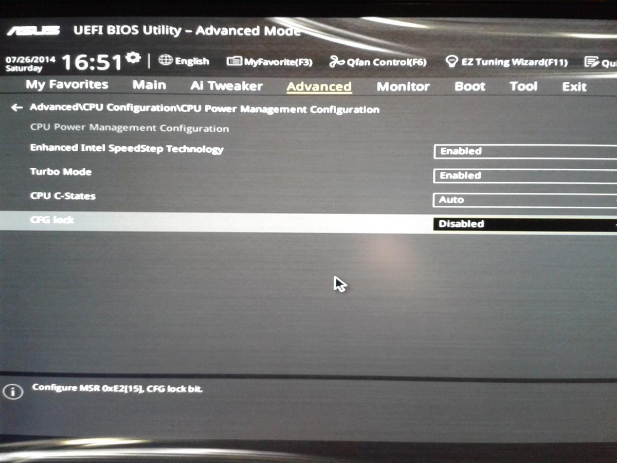

nmarques Posted July 26, 2014 Share Posted July 26, 2014 Hi all, I've purchased a ASUS Z97M-PLUS and successfully patched the BIOS to allow writting on MSR 0x2c bit 15 (see screenshot). I've managed to install Mavericks 10.9.3 with success, and: After install I can boot through my USB stick and boot the local drive with "-x UseKernelCache=No'" and it works. From there, I've dropped SSDT.aml and placed it on /Extra in order to get CPU recognized (i5-4670 3.4Ghz). When I do this, my USB stops working and I believe that since I'm booting from the USB stick, it fails to successfully handle USB and everything stops there with a "Still waiting for root device". Passing arguments (Chimera) like rd=disk0s2 (confirmed, SSD) still fails. So I'm kinda stuck here. Anyone can help (maybe DSDT patching, though it's UEFI)? From here no options allow me to boot back even if -x. Link to comment https://www.insanelymac.com/forum/topic/299809-help-asus-z97m-plus-haswell-mavericks/ Share on other sites More sharing options...

nmarques Posted July 27, 2014 Author Share Posted July 27, 2014 Your image does work fine, nevertheless it doesn't even allow to boot the installer; It loads up (doesn't matter if it's safe mode or not or with/without caches) and once it touches the PCI sub-system it just reboots the system. Either way there's a new patch for my BIOS, so I've updated it but haven't patched the BIOS for the MSR (I'll stick with cpu null power management kext I suppose). Link to comment https://www.insanelymac.com/forum/topic/299809-help-asus-z97m-plus-haswell-mavericks/#findComment-2045296 Share on other sites More sharing options...
Pimentel Posted July 27, 2014 Share Posted July 27, 2014 Hello You wanna mean that kernel patch doesn't work for this usb installer??? Confuse, because i saw this patch work fine in others situations... Did you use RehabMan patch??? code perl??? Link to comment https://www.insanelymac.com/forum/topic/299809-help-asus-z97m-plus-haswell-mavericks/#findComment-2045305 Share on other sites More sharing options...
