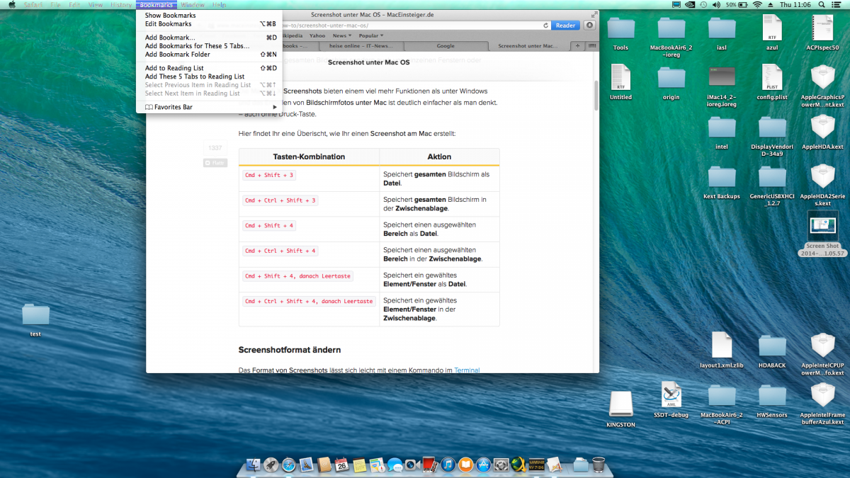

kraecka Posted June 26, 2014 Share Posted June 26, 2014 Hey, first of all I'd like to thank you for your support, which helped me setting up my Sony Hackintosh. But I still have some Problems with Graphics. I have a Sony Vaio Fit Notebook with a 2880x1620 Resolution. It has a Intel 4500U Processor with a HD4400. I get full qe/qi, but only on Resolution lower than 1920x1080. When I set the native Resolution the screen flickers, the strangest is, as long as I move a Window (for example a Finder Window) the flickering is gone. When I stop moving around it starts flickering again. The Resolution I use now is 1440x810. On that Resolution everything works correct. When I set the Resolution to 1920x1080 I get a weird Menubar. The Screenshot I attached shows this. I have also tried debugging my dsdt/ssdt, but I have figured out that only a few Methods are called. P.S I found a little touch support for my N-Trig Touchscreen in 10.10 Any help or hint is appreciated Chris Link to comment https://www.insanelymac.com/forum/topic/299108-problem-with-hd4400-on-higher-resolutions/ Share on other sites More sharing options...
