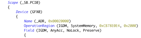

Glaedr Posted June 12, 2014 Author Share Posted June 12, 2014 As long as you didn't have a patched DSDT installed at the time of extract under OSX and are using no Clover "auto patches" for DSDT, the DSDT you get is the same as if you extracted on Linux or Windows. It is not possible to extract native DSDT under OS X if the bootloader is providing a replacement. Well I'm booting with Chameleon and I made sure to delete any ACPI table and reboot before extracting it. Anyway, this is what I get: I compiled the DSDT and put it in /Extra, made sure it was loaded by checking bdmesg after reboot, but I get this error during boot: [AGPM Controller] unknownPlatform This post suggests that the names of the devices don't match. As I said before, my SMBios is iMac11,1 and thus AGPM.kext should be looking for a device named GFX0, which as you can see the DSDT is providing. Where am I wrong? Link to comment https://www.insanelymac.com/forum/topic/298773-dsdtssdt-editing-questions-hp-pavilion-p6230it/#findComment-2029276 Share on other sites More sharing options...
RehabMan Posted June 12, 2014 Share Posted June 12, 2014 Well I'm booting with Chameleon and I made sure to delete any ACPI table and reboot before extracting it. Anyway, this is what I get: Schermata 2014-06-12 alle 17.24.25.png That is Intel integrated not discrete. Your discrete card may be in an SSDT (very common). Link to comment https://www.insanelymac.com/forum/topic/298773-dsdtssdt-editing-questions-hp-pavilion-p6230it/#findComment-2029282 Share on other sites More sharing options...
Glaedr Posted June 12, 2014 Author Share Posted June 12, 2014 That is Intel integrated not discrete. Your discrete card may be in an SSDT (very common). So should I rename it to IGPU (just for the sake of it) and look it out in my SSDTs? Link to comment https://www.insanelymac.com/forum/topic/298773-dsdtssdt-editing-questions-hp-pavilion-p6230it/#findComment-2029285 Share on other sites More sharing options...
RehabMan Posted June 12, 2014 Share Posted June 12, 2014 So should I rename it to IGPU (just for the sake of it) and look it out in my SSDTs? Your real focus is on renaming the discrete object to GFX0. Of course, to be able to do that, you'll need to rename your existing GFX0 (which is your integrated device) to something else. IGPU is a good choice. Link to comment https://www.insanelymac.com/forum/topic/298773-dsdtssdt-editing-questions-hp-pavilion-p6230it/#findComment-2029333 Share on other sites More sharing options...

Glaedr Posted June 12, 2014 Author Share Posted June 12, 2014 You said you only had discrete (nvidia). Is that not the case? As far as DSDT, GFX0 is integrated. Discrete will be something like PEGP or DGFX... Yes but my question was about the DSDT. How could you tell that code I posted was describing an integrated card? Link to comment https://www.insanelymac.com/forum/topic/298773-dsdtssdt-editing-questions-hp-pavilion-p6230it/#findComment-2029383 Share on other sites More sharing options...
RehabMan Posted June 12, 2014 Share Posted June 12, 2014 Yes but my question was about the DSDT. How could you tell that code I posted was describing an integrated card? 0x20000 is always memory address for integrated graphics. IGDM probably stands for Integrated Graphics Device Memory. The ACPI definitions for your discrete card will be in one of the SSDTs. Link to comment https://www.insanelymac.com/forum/topic/298773-dsdtssdt-editing-questions-hp-pavilion-p6230it/#findComment-2029395 Share on other sites More sharing options...
