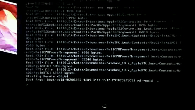

I was able to capture a ss from a video.
when i run -v i never get the apple logo just instant reboot.
First, delete all Graphics kexts from USBInstaller NVDA* ATI* AMD* GeForce* AppleIntelHD*, then change your smbios to MacBookPro6,1, then install al kext from Extra/Extensions to S/L/E of your USBInstaller, then boot with this flag, be sure that FakeSMC.kext is present
-f -v -x npci=0x2000 dart=0 cpus=1

No change removed all of them and ran the command.
