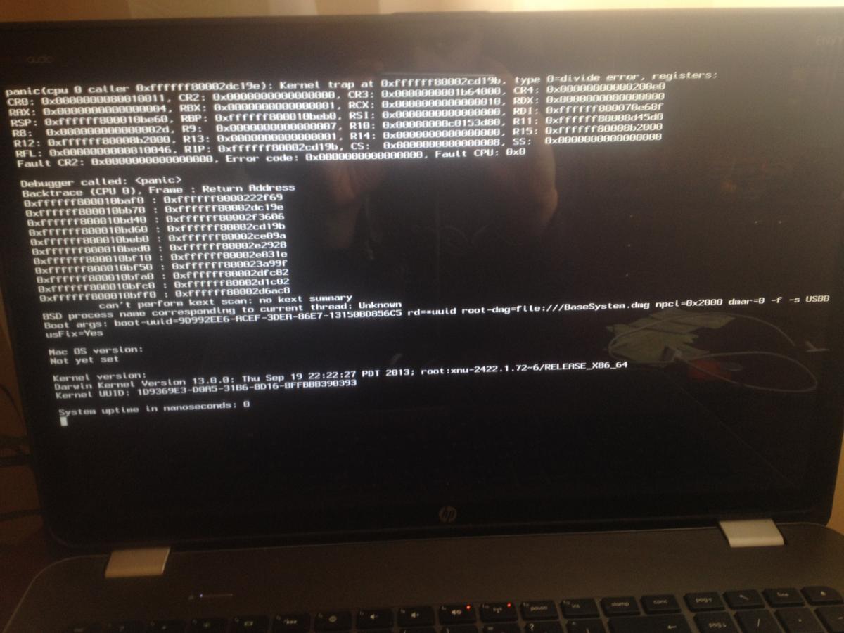

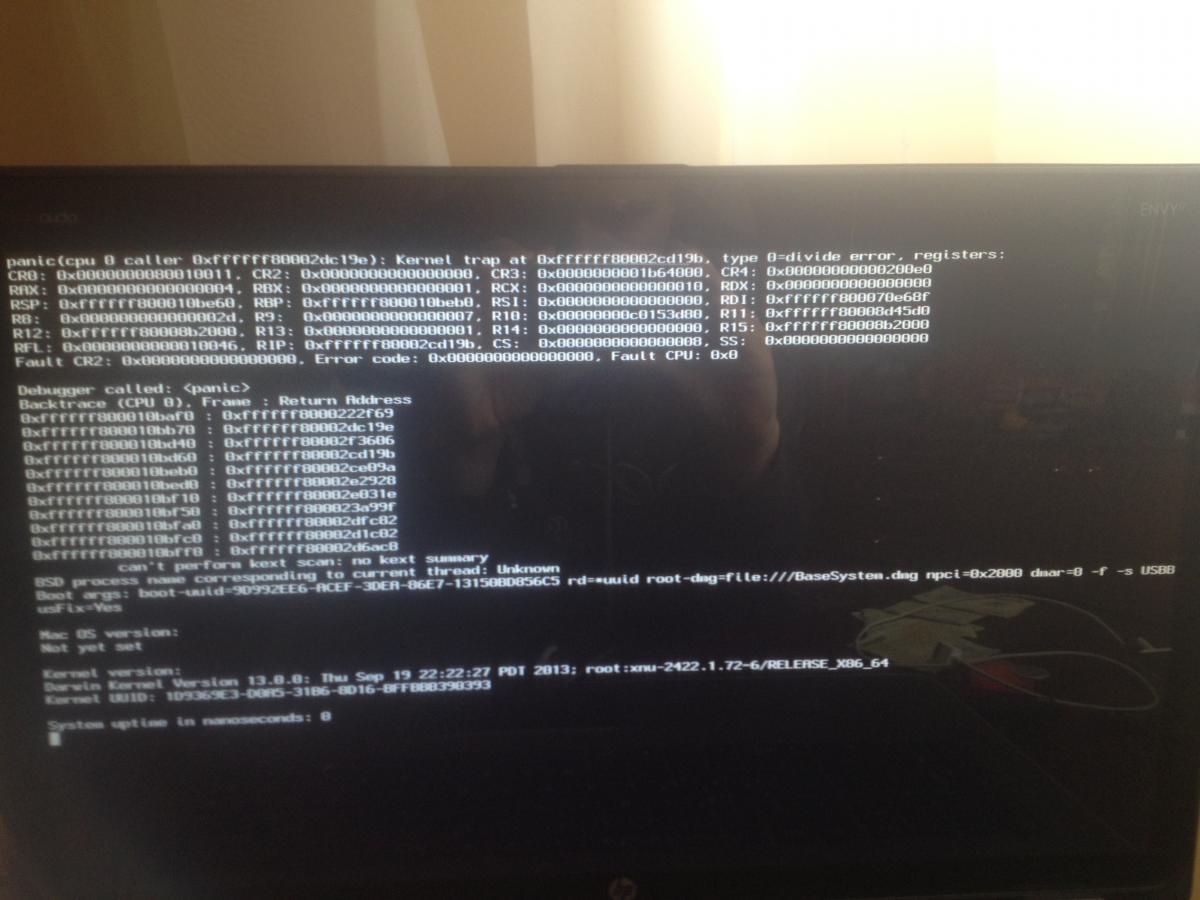

paulrobert Posted April 23, 2014 Share Posted April 23, 2014 Hello everyone I read a lots of forums to be capable to install os x on my laptop but I've stuck on this error. My laptop is HP Envy 17 2180el : Microprocessor 2 GHz Intel Core i7-2630QM up to 3GHz Microprocessor Cache 6 MB L3 cache Memory 8 GB DDR3 Memory Max Upgradeable to 8 GB DDR3 Video Graphics AMD Radeon HD 6850M (1 GB GDDR5 dedicated) Display 43,9 cm (17,3") Full High-Definition HP Ultra BrightView Infinity Display (1920 x 1080) Hard Drive 500 GB SATA (7200 rpm) Multimedia Drive SuperMulti DVD±R/RW with Double Layer Support Network Card Integrated 10/100/1000 Gigabit Ethernet LAN Wireless Connectivity Bluetooth wireless networking Intel 802.11 a/g/n other graphics Intel HD3000 Please help me!Thanks a lot and sorry for my bad english. Quote Link to comment https://www.insanelymac.com/forum/topic/297632-installed-maverick-stuck-on-this-please-help/ Share on other sites More sharing options...
Pimentel Posted April 23, 2014 Share Posted April 23, 2014 Hello Welcome! And... What method are you using to install OSX? Distro or retail method? You CPU is compatible, but it has what integrated graphic? HD2500 or HD3000? Also put your specs in signature please. Quote Link to comment https://www.insanelymac.com/forum/topic/297632-installed-maverick-stuck-on-this-please-help/#findComment-2014692 Share on other sites More sharing options...

Pimentel Posted April 23, 2014 Share Posted April 23, 2014 HelloForget distro please, it's spend of timeI gave to you a solution retail to install OSX QuoteHD3000 So disable HD 6850M in Bios or with DSDT, you choose... because jsut HD 3000 will work 2 Quote Link to comment https://www.insanelymac.com/forum/topic/297632-installed-maverick-stuck-on-this-please-help/#findComment-2014707 Share on other sites More sharing options...
paulrobert Posted April 23, 2014 Author Share Posted April 23, 2014 The same error Quote Link to comment https://www.insanelymac.com/forum/topic/297632-installed-maverick-stuck-on-this-please-help/#findComment-2014754 Share on other sites More sharing options...
Pimentel Posted April 24, 2014 Share Posted April 24, 2014 Hello Boot with: cpus=1 You mobo have a problem with lapic, so you need lapic your kernel or always you'll need boot with cpus=1(using just 1 core) Apply this patch in kernel: http://www.osx86.net/files/file/316-lapic-kernel-patcher-v07/ Good Luck! OBS: Choose that method i gave to you...it's 100% retail Quote Link to comment https://www.insanelymac.com/forum/topic/297632-installed-maverick-stuck-on-this-please-help/#findComment-2014804 Share on other sites More sharing options...
paulrobert Posted April 24, 2014 Author Share Posted April 24, 2014 It don't let me to write any flags it is boot himself with -v npci=0x2000 give me a tutorial, if you have Quote Link to comment https://www.insanelymac.com/forum/topic/297632-installed-maverick-stuck-on-this-please-help/#findComment-2014825 Share on other sites More sharing options...
Pimentel Posted April 24, 2014 Share Posted April 24, 2014 Hello Boot the usb stick and when cursor blinking in screen press button [1] You'll go to chameleon bootloader and in this write these commands About ATI disable: http://www.insanelymac.com/forum/topic/288204-turn-off-your-discreet-ati-nvidia-card-in-locked-bios-insydeh20/ Good luck man! Quote Link to comment https://www.insanelymac.com/forum/topic/297632-installed-maverick-stuck-on-this-please-help/#findComment-2014927 Share on other sites More sharing options...
