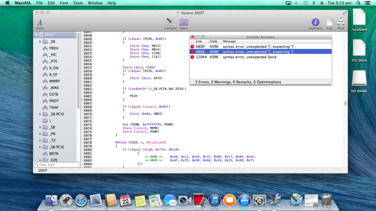

Areeb Qaisar Posted April 22, 2014 Share Posted April 22, 2014 Hello every one. I just finished a successful installation of Mavericks 10.9.2 with working Graphics QE/CI (HD4600) on Lenovo G510. But now I need to use a custom dsdt.aml file inorder to apply the patches etc. However, when I try to Compile the default (unpatched) version using Maciasl i get Three errors. I just cannot figure out these errors, because I am not very much familiar with this DSDT Language :-( Please help me to fix these errors. I have attached the screenshot showing the errors and the System DSDT File :-( System DSDT.zip Link to comment https://www.insanelymac.com/forum/topic/297605-errors-in-maciasl/ Share on other sites More sharing options...
pokenguyen Posted April 22, 2014 Share Posted April 22, 2014 Remove lines in first 2 errors. Link to comment https://www.insanelymac.com/forum/topic/297605-errors-in-maciasl/#findComment-2014415 Share on other sites More sharing options...
Areeb Qaisar Posted April 23, 2014 Author Share Posted April 23, 2014 Ammm Okay. As per your Recommendations, I removed these whole Blocks as shown below. And the Errors were gone, but 44 New Warnings, 24 Remarks and 86 Optimizations appeared now. Is it safe to use the DSDT with Warnings ? Moreover, can you please elaborate what does these two blocks exactly means ? and removing them does not do any harm etc ? If (CondRefOf (\_SB.PCI0.XHC.PS0X)){ PS0X } If (CondRefOf (\_SB.PCI0.XHC.PS3X)) { PS3X } Link to comment https://www.insanelymac.com/forum/topic/297605-errors-in-maciasl/#findComment-2014656 Share on other sites More sharing options...
RehabMan Posted April 23, 2014 Share Posted April 23, 2014 Ammm Okay. As per your Recommendations, I removed these whole Blocks as shown below. And the Errors were gone, but 44 New Warnings, 24 Remarks and 86 Optimizations appeared now. Is it safe to use the DSDT with Warnings ? Moreover, can you please elaborate what does these two blocks exactly means ? and removing them does not do any harm etc ? If (CondRefOf (\_SB.PCI0.XHC.PS0X)){ PS0X } If (CondRefOf (\_SB.PCI0.XHC.PS3X)) { PS3X } Warnings will not prevent creating a binary AML. The code is checking if a certain method is available (in ACPI namespace) and then calling it. You have errors with it, because you didn't disassemble your DSDT correctly. DSDT which references identifiers defined in SSDTs should be disassembled with SSDTs as context. Extract all SSDT, place all SSDT and DSDT in a single directory, then disassemble using 'iasl -da *' from that directory. Link to comment https://www.insanelymac.com/forum/topic/297605-errors-in-maciasl/#findComment-2014659 Share on other sites More sharing options...
Areeb Qaisar Posted April 24, 2014 Author Share Posted April 24, 2014 Warnings will not prevent creating a binary AML. The code is checking if a certain method is available (in ACPI namespace) and then calling it. You have errors with it, because you didn't disassemble your DSDT correctly. DSDT which references identifiers defined in SSDTs should be disassembled with SSDTs as context. Extract all SSDT, place all SSDT and DSDT in a single directory, then disassemble using 'iasl -da *' from that directory. I just got a bit confused :-(. I didn't disassembled my DSDT Correctly. ? I just tried in your Maciasl and also in DSDT Editor, and it has option to extract the DSDT. That is all I did. So by this method we dont get the correct DSDT ? From this I conclude, that first I should create the SSDT using the method shown in this page: http://rampagedev.wordpress.com/guides/make-your-own-ssdt/ Next I should save the created SSDT.aml in the same directory as Maciasl or DSDT Editor, and then try to extract the DSDT again ? This time the DSDT should not have errors ? Is this the right way ? What does disassemble using 'iasl -da *' from that directory. mean ? Link to comment https://www.insanelymac.com/forum/topic/297605-errors-in-maciasl/#findComment-2014964 Share on other sites More sharing options...
RehabMan Posted April 24, 2014 Share Posted April 24, 2014 I just got a bit confused :-(. I didn't disassembled my DSDT Correctly. ? I just tried in your Maciasl and also in DSDT Editor, and it has option to extract the DSDT. That is all I did. So by this method we dont get the correct DSDT ? Not correct. DSDTs with complex interfaces with SSDTs must be disassembled with the SSDTs as context as I described. If you load an AML directly in MaciASL or DSDT Editor it is disassembled (with iasl) standalone. From this I conclude, that first I should create the SSDT using the method shown in this page: http://rampagedev.wordpress.com/guides/make-your-own-ssdt/ Generating an SSDT for CPU power management has nothing to do with extracting OEM SSDTs. Next I should save the created SSDT.aml in the same directory as Maciasl or DSDT Editor, and then try to extract the DSDT again ? This time the DSDT should not have errors ? Is this the right way ? What does disassemble using 'iasl -da *' from that directory. mean ? First you need to extract all SSDTs/DSDT using Linux (they are in /sys/firmware/acpi/tables and /sys/firmware/acpi/tables/dynamic. Once you have collected them, bring them into your OS X installation in a separate directory. Then use a recent build of iasl to disassemble them all with 'iasl -da *' in Terminal. That will disassemble all files as .DSL. You then load the .DSL files into MaciASL for patching. 1 Link to comment https://www.insanelymac.com/forum/topic/297605-errors-in-maciasl/#findComment-2014975 Share on other sites More sharing options...
Areeb Qaisar Posted April 25, 2014 Author Share Posted April 25, 2014 First you need to extract all SSDTs/DSDT using Linux (they are in /sys/firmware/acpi/tables and /sys/firmware/acpi/tables/dynamic. Once you have collected them, bring them into your OS X installation in a separate directory. Then use a recent build of iasl to disassemble them all with 'iasl -da *' in Terminal. That will disassemble all files as .DSL. You then load the .DSL files into MaciASL for patching. That's Great. It worked. Now the newly created DSDT.dsl file, actually contains No errors, when I open it up with DSDT Editor. It only contains the following types of warnings: Use of Compiler Reserved Name (_T_0) Use of Compiler Reserved Name (_T_1) Not all Control Paths return a Value (PR2S) Not all Control Paths return a Value (_PS0) Not all Control Paths return a Value (_PS3) Not all Control Paths return a Value (BIFX) Not all Control Paths return a Value (MHPF) Unknown reserved name (_VPG) Unknown reserved name (_CFG) Caller Method may not always return a Value. Result is not used, operator has no effect. So is it safe to apply the patches, along with these warning ? or should I look into removing these warning ? Moreover, There are other DSL Files of SSDT as well such as SSDT1.dsl, SSDT2.dsl etc etc. We do not need them for patching right ? --------------------------------------------------------------- --------------------------------------------------------------- Just in case, here is the methodology that I used. There were a total of 7 SSDT and 1 DSDT. SSDT1, SSDT2, SSDT3, SSDT4 were in /sys/firmware/acpi/tables/ SSDT5, SSDT6, SSDT7 were in /sys/firmware/acpi/tables/dynamic/ I extracted all these files, along with the DSDT.aml and placed them in a directory, using sudo cat /sys/firmware/acpi/tables/SSDT1 > SSDT1.aml sudo cat /sys/firmware/acpi/tables/SSDT2 > SSDT2.aml sudo cat /sys/firmware/acpi/tables/SSDT3 > SSDT3.aml sudo cat /sys/firmware/acpi/tables/SSDT4 > SSDT4.aml sudo cat /sys/firmware/acpi/tables/dynamic/SSDT5 > SSDT5.aml sudo cat /sys/firmware/acpi/tables/dynamic/SSDT6 > SSDT6.aml sudo cat /sys/firmware/acpi/tables/dynamic/SSDT7 > SSDT7.aml sudo cat /sys/firmware/acpi/tables/DSDT > DSDT.aml I came across your Your Repository of iasl here, compiled it after installing XCode, and then used iasl -da /Folderpath/* It created 8 more files, with the dsl extension. I just used DSDT.dsl and openned it in DSDT Editor. I hope this is the only file that is required, and we dont have much to do with the files SSDT1.dsl, SSDT2.dsl and so on ? Link to comment https://www.insanelymac.com/forum/topic/297605-errors-in-maciasl/#findComment-2015092 Share on other sites More sharing options...
RehabMan Posted April 25, 2014 Share Posted April 25, 2014 That's Great. It worked. Now the newly created DSDT.dsl file, actually contains No errors, when I open it up with DSDT Editor. It only contains the following types of warnings: Use of Compiler Reserved Name (_T_0) Use of Compiler Reserved Name (_T_1) Not all Control Paths return a Value (PR2S) Not all Control Paths return a Value (_PS0) Not all Control Paths return a Value (_PS3) Not all Control Paths return a Value (BIFX) Not all Control Paths return a Value (MHPF) Unknown reserved name (_VPG) Unknown reserved name (_CFG) Caller Method may not always return a Value. Result is not used, operator has no effect. So is it safe to apply the patches, along with these warning ? or should I look into removing these warning ? Moreover, There are other DSL Files of SSDT as well such as SSDT1.dsl, SSDT2.dsl etc etc. We do not need them for patching right ? --------------------------------------------------------------- --------------------------------------------------------------- Just in case, here is the methodology that I used. There were a total of 7 SSDT and 1 DSDT. SSDT1, SSDT2, SSDT3, SSDT4 were in /sys/firmware/acpi/tables/ SSDT5, SSDT6, SSDT7 were in /sys/firmware/acpi/tables/dynamic/ I extracted all these files, along with the DSDT.aml and placed them in a directory, using sudo cat /sys/firmware/acpi/tables/SSDT1 > SSDT1.aml sudo cat /sys/firmware/acpi/tables/SSDT2 > SSDT2.aml sudo cat /sys/firmware/acpi/tables/SSDT3 > SSDT3.aml sudo cat /sys/firmware/acpi/tables/SSDT4 > SSDT4.aml sudo cat /sys/firmware/acpi/tables/dynamic/SSDT5 > SSDT5.aml sudo cat /sys/firmware/acpi/tables/dynamic/SSDT6 > SSDT6.aml sudo cat /sys/firmware/acpi/tables/dynamic/SSDT7 > SSDT7.aml sudo cat /sys/firmware/acpi/tables/DSDT > DSDT.aml I came across your Your Repository of iasl here, compiled it after installing XCode, and then used iasl -da /Folderpath/* It created 8 more files, with the dsl extension. I just used DSDT.dsl and openned it in DSDT Editor. I hope this is the only file that is required, and we dont have much to do with the files SSDT1.dsl, SSDT2.dsl and so on ? Warnings are fine as they do not prevent generation of an AML binary. Keep in mind the DSDT as a whole is working/tested (with Windows) so unless you have evidence to suggest otherwise, you should assume the code works. Obviously there are cases where the code doesn't work for OS X, which is why we need patches, but those problems are rarely pointed out by warnings from the iasl compiler. As for the SSDTs, there are cases where the SSDTs are needed and sometimes even patched. It all depends on the content of the various files. Consider the entire set of DSDT/SSDTs as one ACPI set that is intended to be used together. With recent Haswell systems it is common for the definition of the Intel graphics device (typically named GFX0) to be in an SSDT, and to implement brightness patches for ACPIBacklight.kext it is necessary to patch both the SSDT that contains the definition for GFX0 as well as the DSDT. Link to comment https://www.insanelymac.com/forum/topic/297605-errors-in-maciasl/#findComment-2015246 Share on other sites More sharing options...
